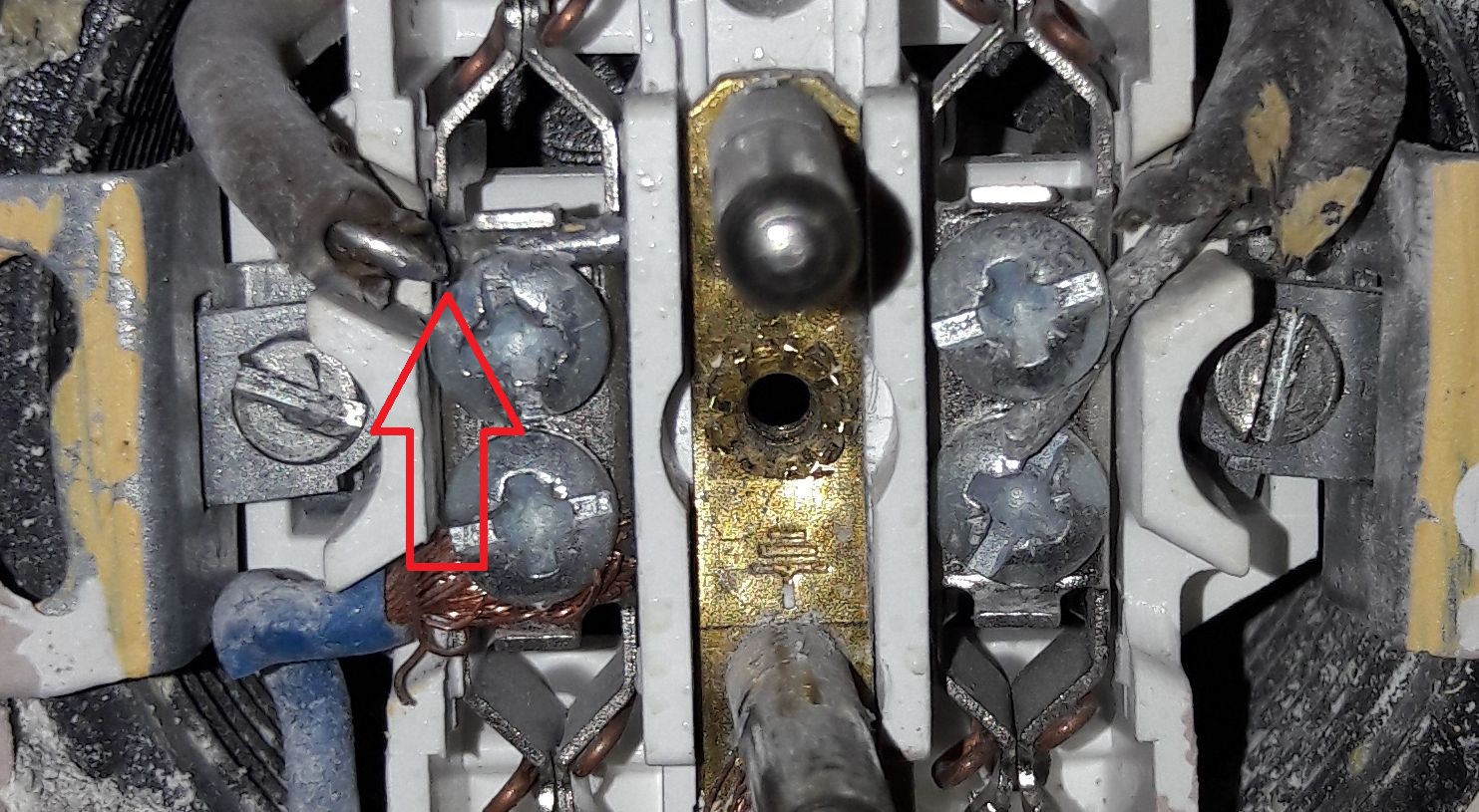

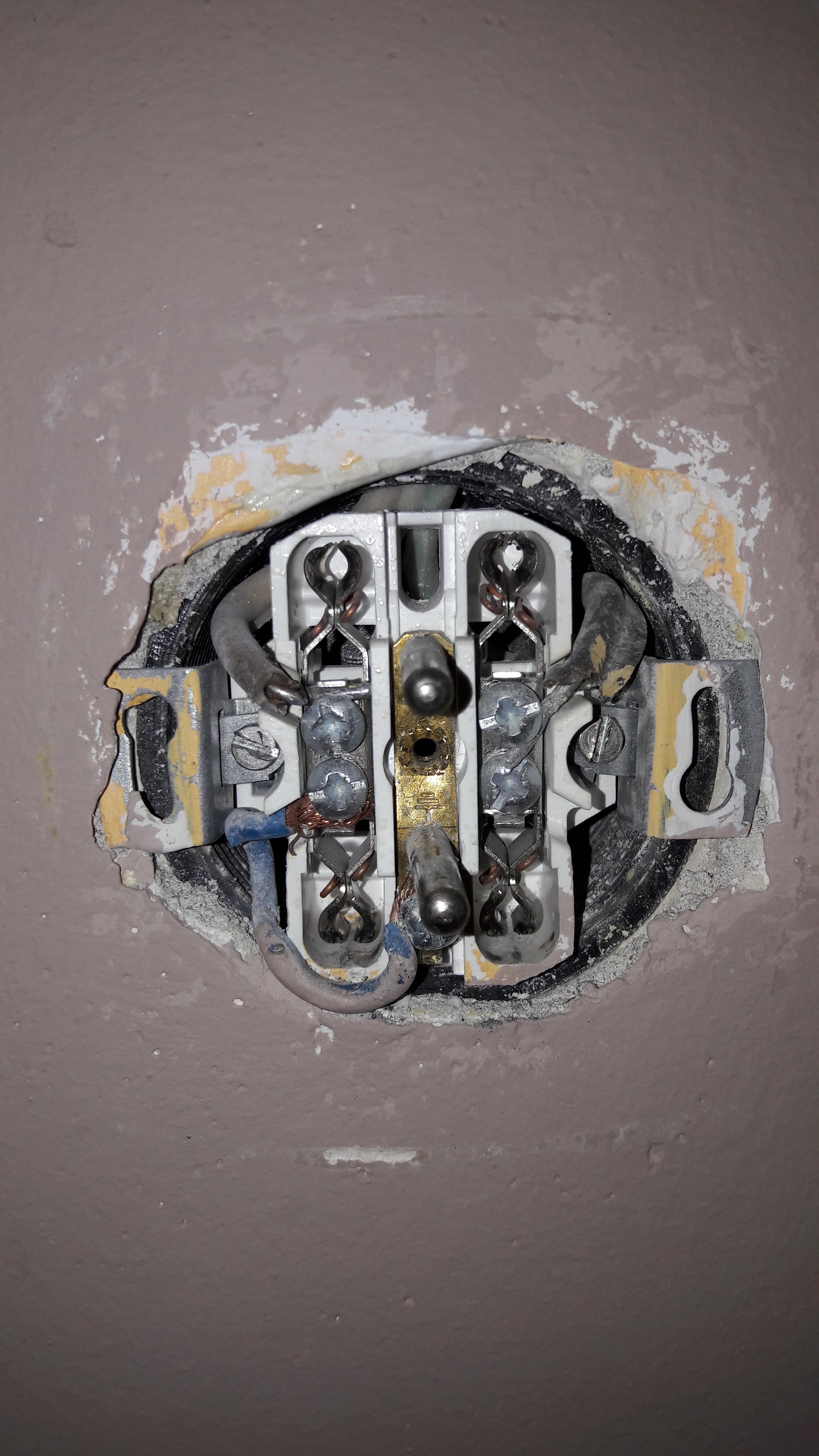

    For some time now, my electrical outlet has started to make disturbing noises after plugging equipment into it. The connected equipment works but stops after a while. After unscrewing the socket housing, the following view appeared:
    Sizzling Electrical Outlet Issue: Troubleshooting & Repair Tips for Disturbing Noises
    Can you advise me what is wrong and how can I fix it?

    Look at that burnout wire

    Replacement socket.
    Since the "reset" is already done, it must be done correctly. TJ. the neutral wire first to the ground pin, and only to the socket contact (you have it the other way around), this bridge is to be made of a wire, not a string, or a cord, but terminated with a suitable tip.

    Hello. This is due to burned, overheated aluminum wires. I propose to buy a new socket for replacement, turn off the electricity and start disassembling the old socket. Be careful not to make any sudden movements as aluminum cables are very brittle. Clean mechanically from tarnish. If it breaks, put the shortened cable on both cables of the connector and place them on the back, leading out two new cable sections in the appropriate colors.
    Brown - phase
    Blue - zero
    Connection in the same way as in the old socket. You have to think slowly about replacing the electrical wiring from aluminum to copper.
    It shouldn't sizzle anymore.

    Bad contact between the wires and the terminals.
    Overheated aluminum wires.
    Socket contacts overheated.
    Badly made zeroing circuit.
    How to repair?
    First, turn off the power.
    Replace the seat with a new one.
    Cut off burnt ends of aluminum wires.
    Strip these wires approx. 15 mm.
    Clean with fine sandpaper.
    Clamp the cable sleeves on them.
    Prepare 3 sections of copper wires 10 - 15 cm long in the following colors: blue, yellow-green, third phase color (black, brown or gray).
    Connect the stopped ends of the aluminum conductor with the new lengths of the copper conductor using terminal blocks.
    Blue and yellow-green wires are connected to the neutral wire, and one of the following colors to the phase wire: black, brown or gray.
    The ends of the copper wires are connected to the terminals in the new socket in accordance with the purpose of the individual terminals.
    The wires in the cubes should be connected in such a way that both screws press against the isolated ends of all wires, i.e. both the sleeve clamped on the aluminum wire and the copper wires. For this purpose, use a cube with a cross-section correspondingly larger than the cross-section of each conductor.

    Unfortunately, no, the N-ka in the old socket is incorrectly connected.
