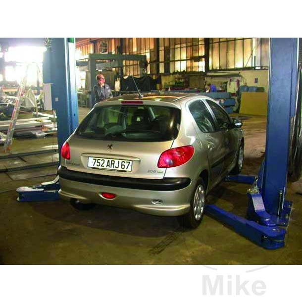

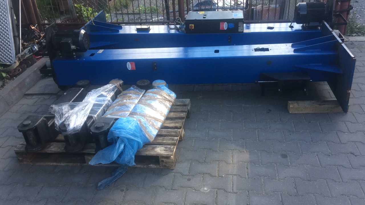

    I bought in Germany 2 pieces (screw) from the IVECO website with full technical documentation. One 5ton, the other 6.5 tonnes. They sold because the necessity to replace the support nuts was approaching. Cap costs 100-150 euros each.
    The quality of workmanship is great for me. Very massive, stable lifts - look at the feet, prams and paws. I did not measure the thickness of the column profile exactly but they are 15-20mm (I can check) What is very important the carts are mounted on bearings not on sliding plates. 6.5T weighs 1420kg and 5T 1250kg Both legs are extendable in three lengths (symmetrical, i.e. the same length). They have a "bowl" for oil for spindle lubrication. Every now and then you add oil and peace. I leave it 6.5 ton for myself and 5ton I want to sell because I don't need two and I had to buy it in the package.
    To illustrate the photo:
    6500kg
    Replacing Ravaglioli KPS306 Two-Column Lift: Maha or Nussbaum for Heavy Cars? Replacing Ravaglioli KPS306 Two-Column Lift: Maha or Nussbaum for Heavy Cars?
    and here 5000kg
    Friends work on Techwar TC0012 - 5ton lifts and don't complain. Service and availability of parts is very good. The new one costs PLN 12,800. Look at the massiveness of Techwar and Maha. I prefer used Maha or Nussbaum but I was only interested in 5ton.
    PS. I was looking for a Nussbaum POWER LIFT HL 2.60 stimulant with broken paws but it is very hard to hit such a stimulant.
