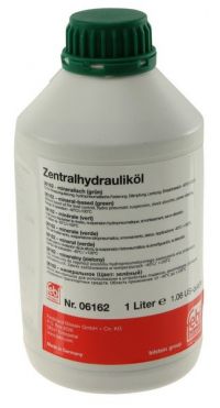

    I need to add oil to the frog cylinder. In the user manual they write that it must be hydraulic oil.
    I found such oils on the garage shelf:
    Best Garage 'Frog' Lifts: Comparing Bass 4T BP-3389 and Farys 3T FR-5238 for Lifting Max 2 Tons
    Which of them will be suitable for the lift cylinder?

    That's up to three tons, he also started to let me go. It turned out that it was full of metal filings. After cleaning, he lives. Oil poured Dextron into the machine.
