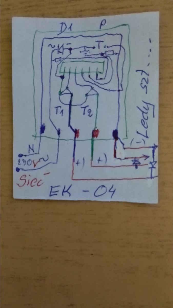

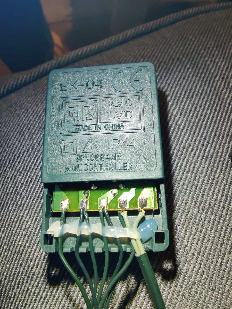

Where should the 230 V AC supply be soldered back onto an EK-04 LED Christmas light controller after the mains cable broke off?
The 230 V AC input goes to the controller’s mains/rectifier-bridge connection, not to the five LED output wires; on a similar EK-04 board, the 2nd pin from the right was identified as the bridge-rectifier supply, with the leftmost pin as the common LED line and the middle pins as LED controls [#17644455] Another explanation says the two mains wires also go to the socket at the end of the chain, while the 5 LED wires are separate outputs [#18366068] If one string stays on continuously after reconnecting, a thyristor may be shorted or the controller may be damaged [#17644455][#17644086]

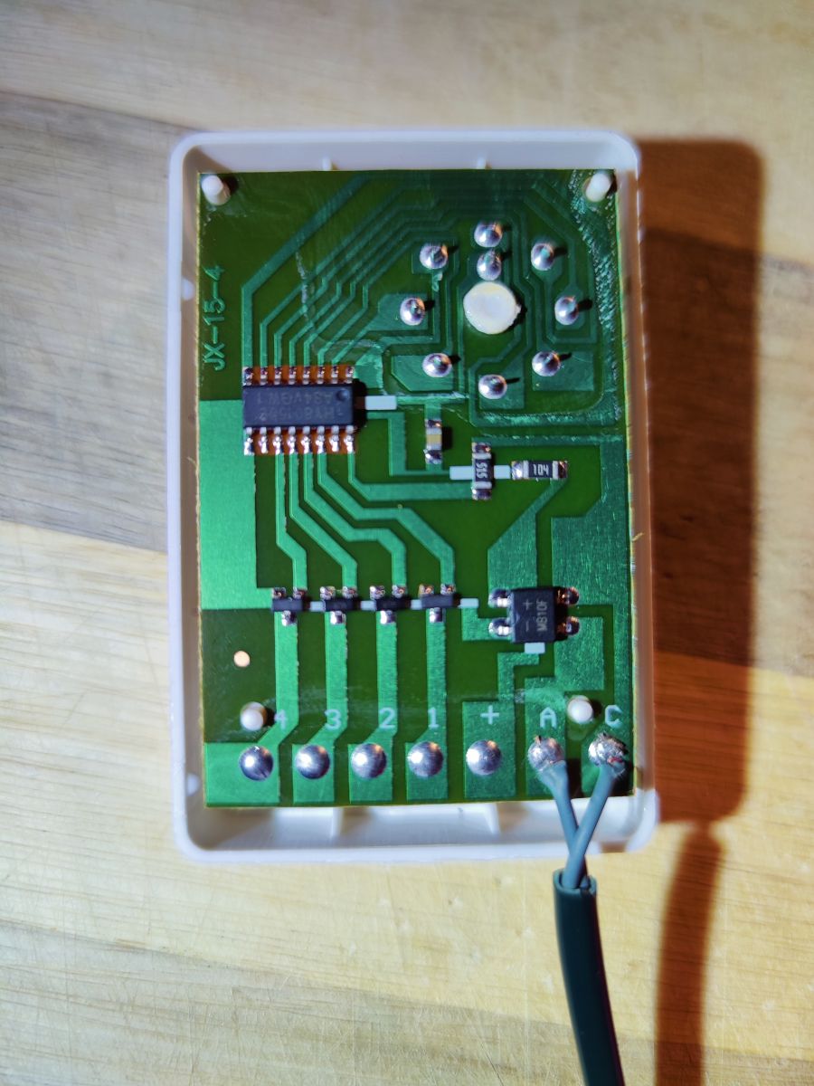

    Close-up of green EK-04 controller with visible wires and PCB components. Electronic module with PCB and connected wires inside plastic housing
    Hello , my old ek-04 have 5 pins , new have 7pins. Can I connect it to the new one? In the old one, two wires were soldered in parallel to those coming from the 220v outlet. I don’t understand where they need to be soldered in the new one?
    Added after 9 [hours] 1 [minutes]:
    I found solution,
    A C from 220v
    5 old pin ( on screen left) to + new pin
    3 and 4 old can be splited and connect to 1 2 3 4 new pin by single
    Old 1 and 2 parallel connected to 220 can be skipped and isolated without connect.
