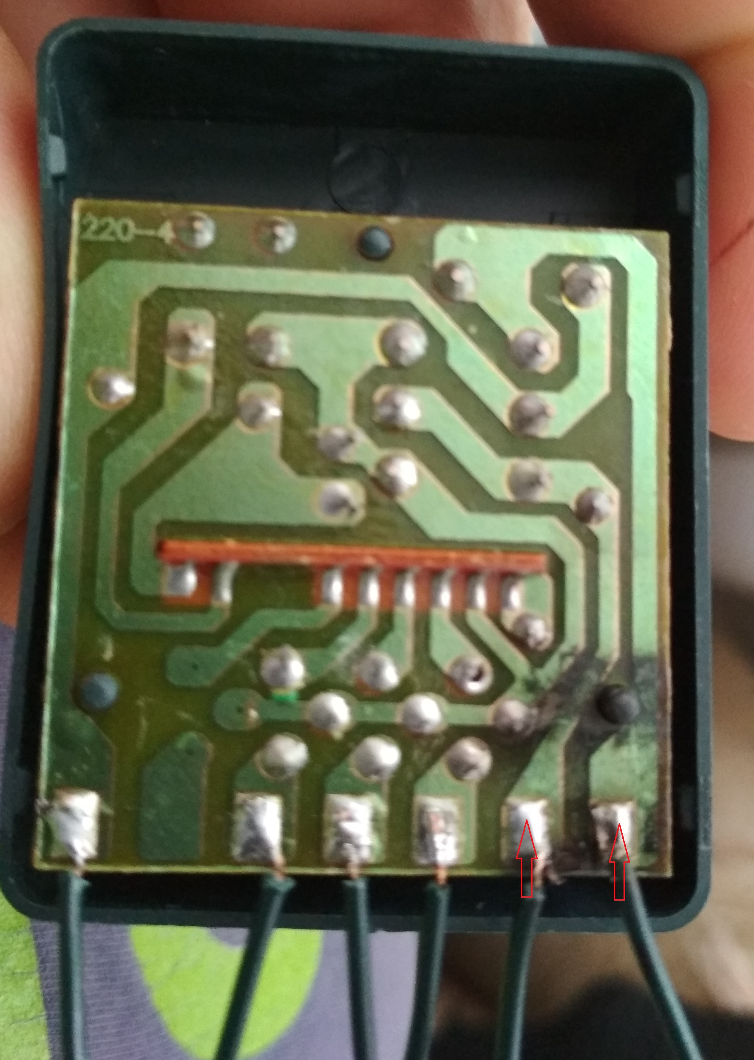

    The power cable from the LED Christmas tree lights controller broke off. Below are the photos.
    Where to connect the 230 V AC power supply? (it would be best if someone marked it in my photos)

    In the first photo, the last two pins on the right side supply 230V power.

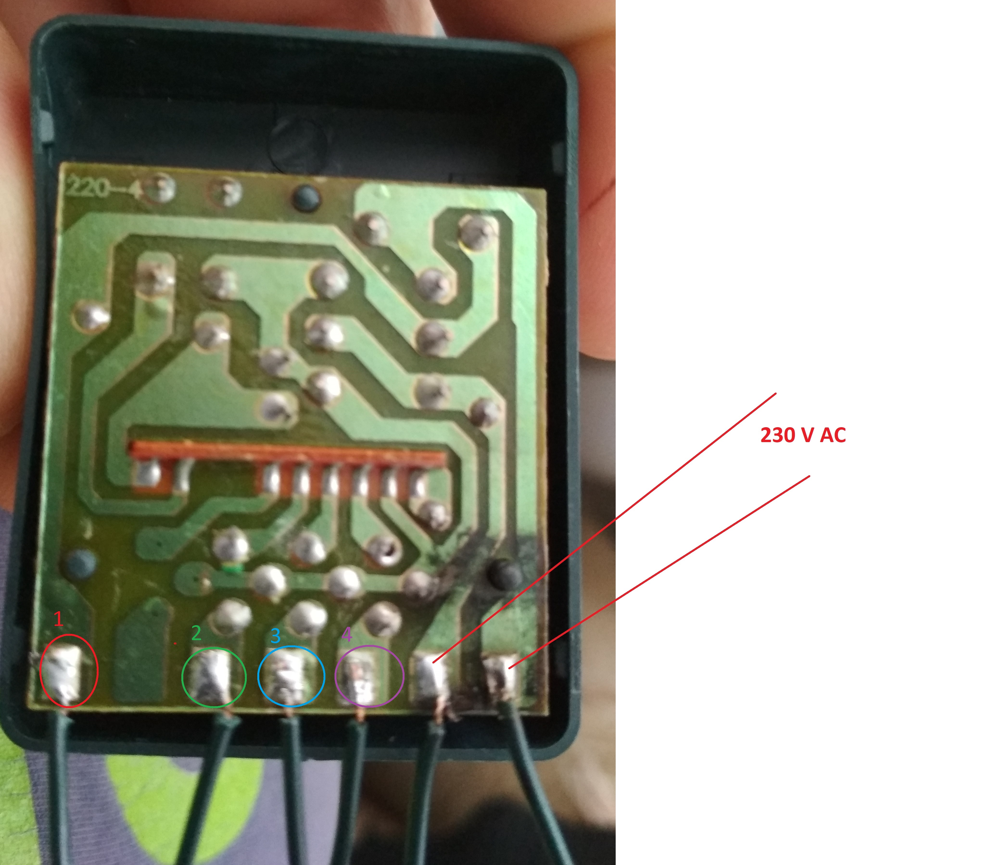

  • #3 17643771
    gumisie
    Posts: 17790
    Help: 1667
    Rate: 2473
    Just like the post above.

    It`s impossible to be there. Because the wires go to the LED circuits from these places.
    All the wires in the picture go to the LEDs. The 230V cables broke off from the inside of the controller and I don`t know which pin they were soldered to.
    From what I see, there are 5 circuits for controlling the diodes (5 pins/cables from the right side of the controller) plus a sixth pin/common cable.
    For now, I have cut off the controller and connected these five cables into one and connected them directly to the 230 V power supply.
    But it`s possible.
    Before I wrote #3, I looked at an identical driver.
    Regards.

    golec2604 wrote:
    So how does it work??
    The anodes of the LEDs are probably switched on with thyristors and the cathodes as in the attachment.

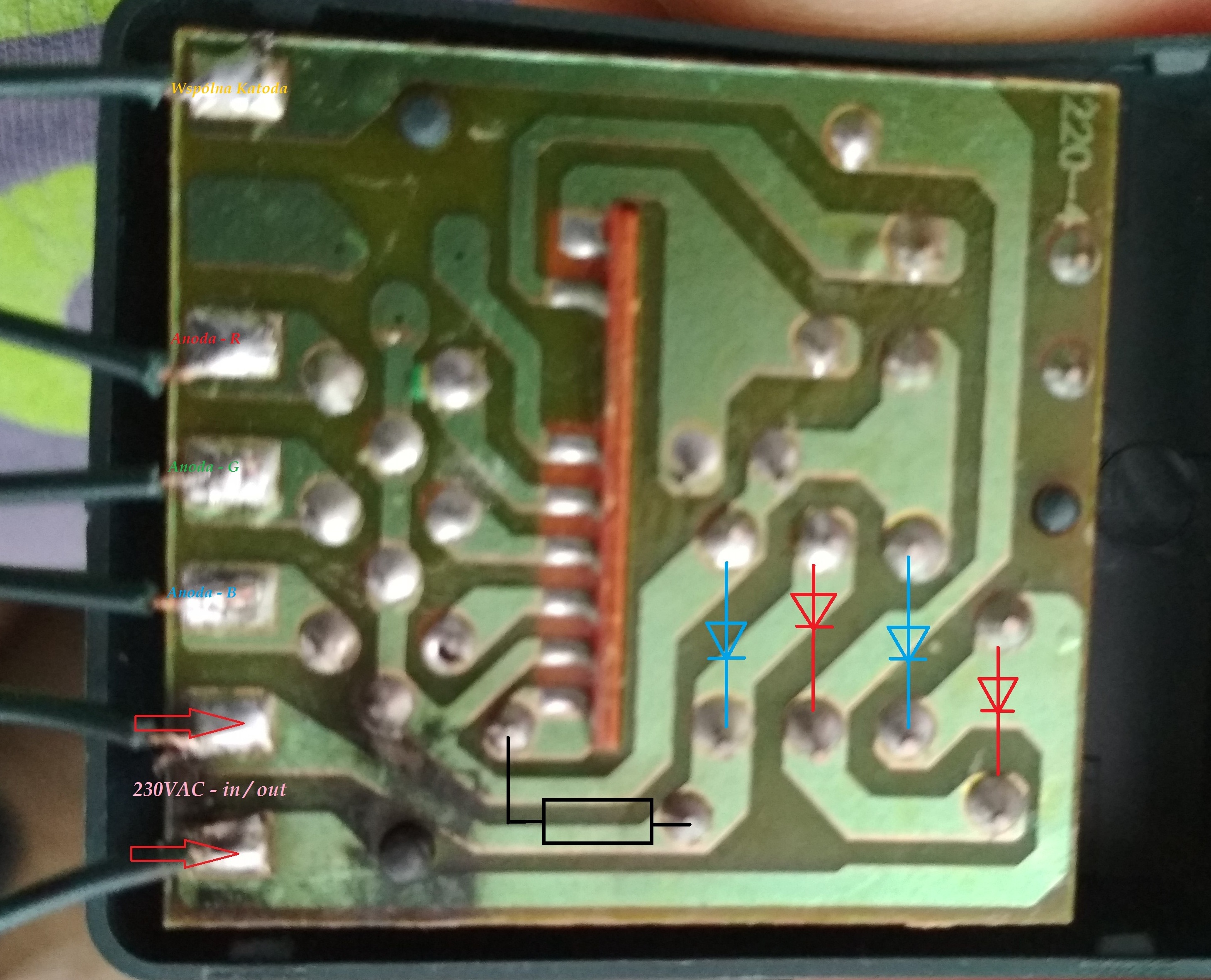

    to the gummies: something doesn`t suit me here because:
    1. I also have other lamps and there is also an EK-04 controller, and the structure of the entire board is completely different than the one I am asking here on the forum.
    2. Secondly, these LEDs are all of one color, so there are no RGB anodes.
    3. Where you wrote that the 230V AC power goes there, there are also cables for the LEDs from the controller
    All the cables in the photos go from the controller to the LEDs. There are no 230V power cables here, because they are torn off from the inside of the controller.
    But I powered up the power supply where you asked and one LED circuit is on all the time - it is not controlled by the controller. The remaining LED circuits are controlled by a controller.

    In my opinion, as my friend wrote, the 2nd right one is the power supply to the rectifier bridge.
    The first one on the left is common to all LEDs, the middle 3 are LED controls, if one set is lit constantly, it is a shorted thyristor.
    The system may also be damaged beyond repair.

    @golec2604 I had the same Chinese Christmas tree lights and they were connected as in the photo, the power supply was as we described, it`s a one-time switch, the whole controller, it flashed, there`s a button to change the light and the lights go out, it`s PLN 10 and it`s not worth repairing.

    Following your advice, I soldered it as follows:
    Reattaching Power Cable to EK-04 Controller for LED Christmas Tree Lights
    Well, I say that one circuit is not controlled. Well, in my opinion, this is the circuit to which the 230V voltage is soldered, because it is a direct connection, so how would the controller control it? In my opinion, the 230 V connection must be in a different place.

    In post #12, the power supply is well connected,
    you need to check whether the thyristors are conducting (probably PCR-400J), set the meter to measure direct voltage and measure the voltages in points 2, 3, 4 in relation to point 1, I marked it in the attached photo.
    At point 1 there is a positive pole, 2, 3, 4 negative.

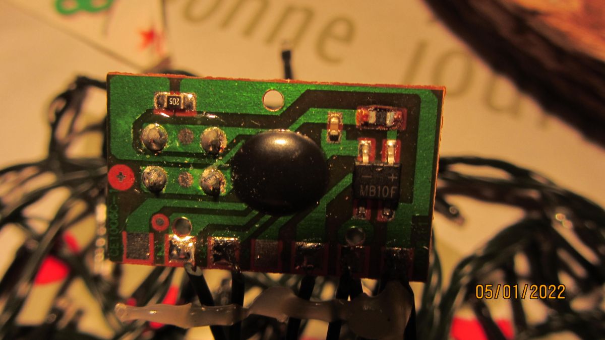

    Something went wrong - there is nothing left (or it fell out somewhere) what could be in this place?
    Wherein?
    Mark on the photo.
  • #22 19801569
    Adam-T
    Posts: 5113
    Help: 834
    Rate: 1090
    gumisie wrote:
    Wherein?
    I think it`s over the bridge.
    I think it was 100kΩ there.

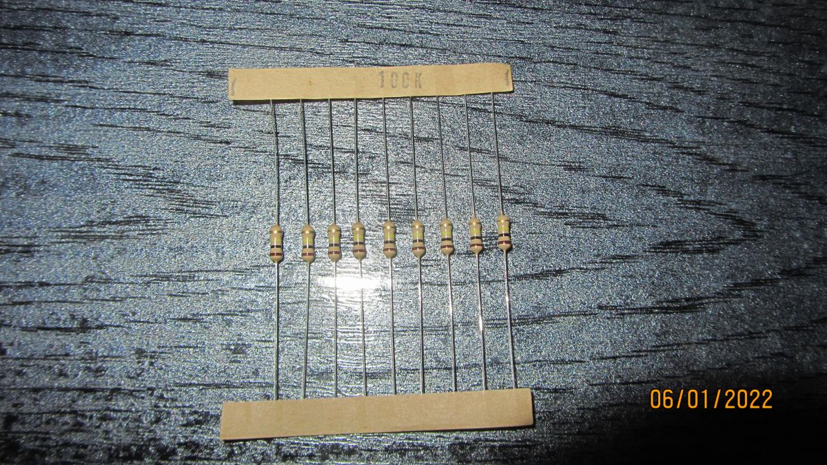

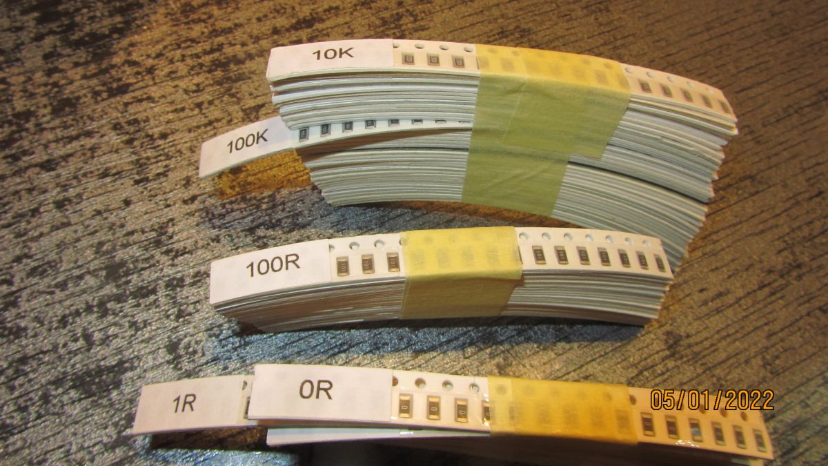

  • #23 19801728
    Zenon407
    Posts: 762
    Help: 5
    Rate: 93

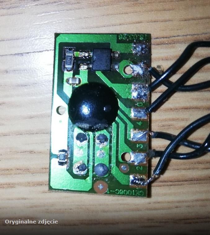

    Wherein?
    Mark on the photo.
    I thought you could see it - upper right corner
    I think there was 100kΩ there.
    And how is it described on SMD?
    100R is how many ohms? 100?
    Will this be ok?
    100R is 100 but:
    and that`s already 104
    Regards
    ...so as not to fill in empty points.
    100 in SMD is of course 10Ω; the third digit is the number of zeros - sorry
  • #25 19801982
    gumisie
    Posts: 17790
    Help: 1667
    Rate: 2473
    100Ω
    100kΩ: 104
    10kΩ: 103
    1kΩ: 102
    100Ω: 101
    But you can come across other markings.
    E.g.: 1001 = 1kΩ
    1002 - 10kΩ
    Link

  • #28 19802265
    Zenon407
    Posts: 762
    Help: 5
    Rate: 93
    I added this one because I didn`t have a 104 this size...
    It flies nicely! :)
    I found it - maybe it will be useful to someone
    Probably.
    104 = 100 kΩ
    205 = 2 MΩ
