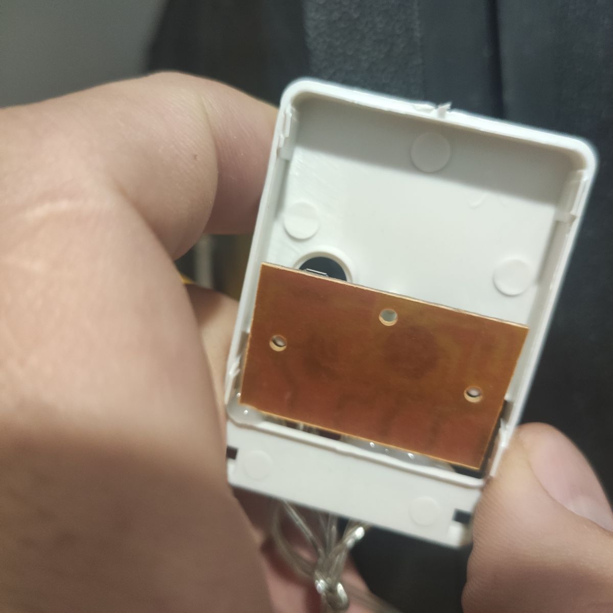

    Can anyone help me with these lights? How to connect them so that they shine all the time without flashing?
    EK-04 Christmas tree lights: Why do only every second LED light up without the driver? EK-04 Christmas tree lights: Why do only every second LED light up without the driver? EK-04 Christmas tree lights: Why do only every second LED light up without the driver?

    Hello. Show the picture of the whole tile from the side of the elements, then you will be able to give hints on how to connect the bridges to bypass the controls.
    Here is the plate, please.

    Connect like red bridges and remove the elements marked with blue circles.

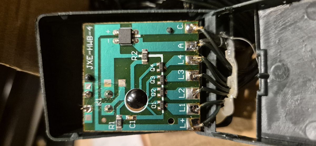

    I have purchased several sets of LED lights (500 pcs) with the E-04 driver and have another board. I am attaching a photo:
    LED controller circuit board with markings JXE-HWB-4. .
    Could I ask for info on how to modify so that they all light up with a continuous light every time they are powered up?
    Thanks in advance for your help.
