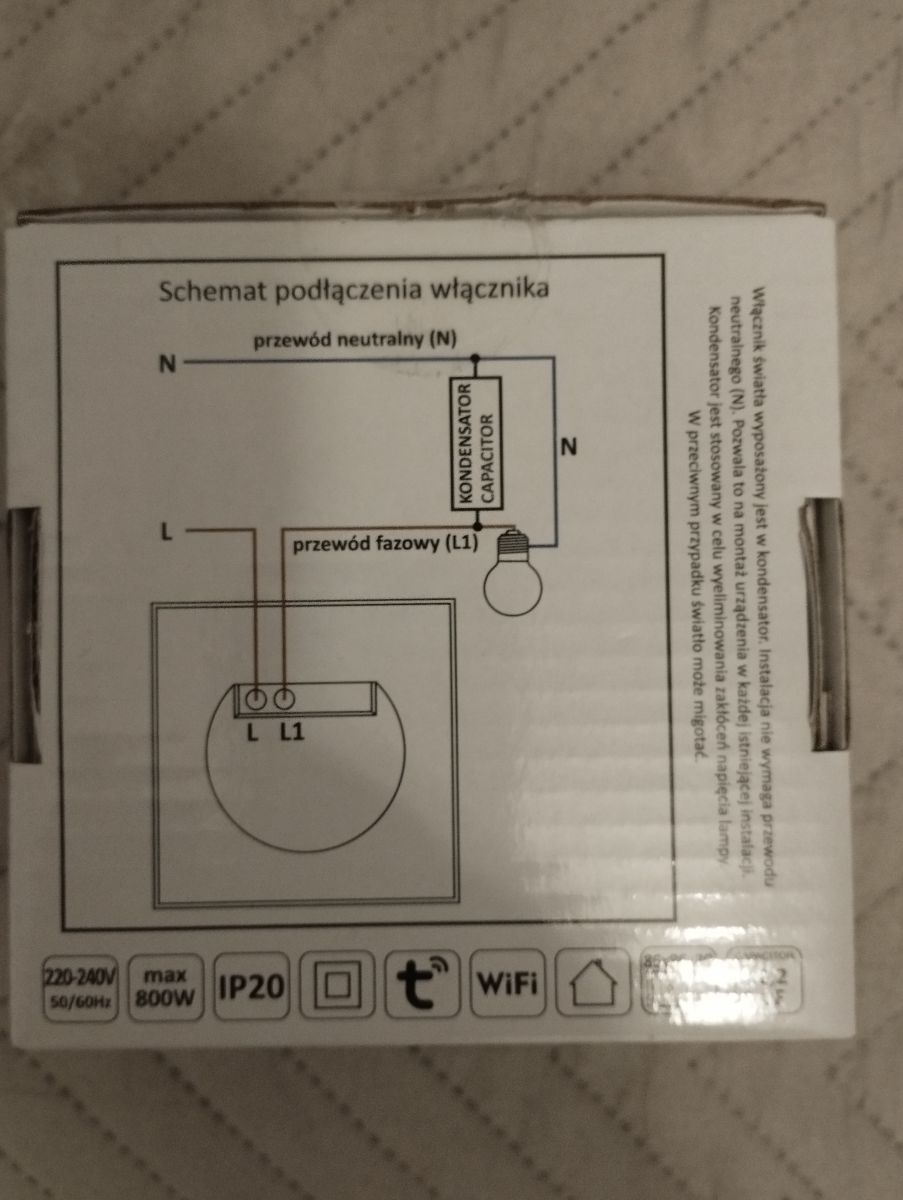

    Hello gentlemen, I need your help, namely I bought Wi-Fi light switches from majfrends, everything is nice and beautiful, etc. here on the diagram you need 2xL and N to connect, in one of the rooms I had a tube with wires inside the wall and there was no problem here I replaced the cable with a 3-wire one and everything works, the problem in other rooms where the cable is routed in the wall and it's hard for me to forge now , here in the second picture there is a mysterious "transformer" and there is a 2-wire connection, but what is this miracle? These yellow miracles were left to me from the previous switch, but the second connection does not work with it

    I mean what the switch should I do under the ceiling? and in this second picture there is a 2-wire diagram, how to connect the old switch under L and L1 as it was connected, it becomes a disco ?

    The diagrams are rather good that at the auction is a different model.
    The capacitor should be in parallel with the bulb and no matter where.
    The question is whether you use it for LEDs or traditional light bulbs because perhaps this is the reason, unless there should be a transformer in parallel with the bulb, not a capacitor.

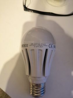

    The capacitor should be parallel to the bulb and no matter where.
    The question is whether you use it for LEDs or traditional light bulbs, because perhaps this is the reason, unless there should be a transformer in parallel with the bulb, not a capacitor.
    The bulb is like this:
    Majfrends Wi-Fi Light Switch: 2xL & N Connection, Mysterious Transformer, & 2-Wire Setup
  • #12 17677961
    bubu1769
    Posts: 8063
    Help: 1177
    Rate: 2374
    This is how I generally look at offers with these Wi-Fi switches and everywhere they say to use this capacitor, or as they call it "LED transformer", in the case of connecting incandescent lamps with a power of less than 3W and when the bulb is blinking after switching off. And no matter if the capacitor is next to the bulb, in the lamp cube or somewhere in the box on the way, it should simply be parallel to the bulb to "load" the switch output.
    The switch itself looks like it should work on a "parasitic" power supply, but I don't know if there are any specific load conditions to be met then. Usually, when I have contact, for example, with two-wire sensors, there are situations that they need to connect a relay with a higher power coil, otherwise circuses happen.

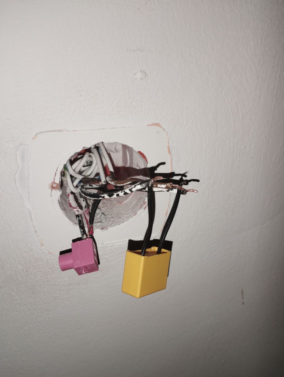

    Please help. How is this damn connected? I already had almost all my hair torn out?

    The capacitor is best placed in the cube of the lamp itself, and then the switch is mounted like the old one.
  • #16 20182645
    3xoses
    Maybe my friend something more? What (what color) to connect the capacitor to, and what to L and what to L1. There are black with brown and black coming out of that red cube.

    Presumption is that this is a photo of the place where the old switch was.
    You need to connect the new switch in the same way as the old one, if the old switch was a simple single one, with the right direction, under L must enter the wire with the phase, on L1 is the output to the bulb.
    To check where what is, even an ordinary 230V tester would suffice.
    After the photo itself, it's hard to say where what is, especially as the wires are twisted and clogged with paint, you can see that there is also a blue (probably neutral) and yellow-green (protective) wire, but if everything is connected, it will not be fixed remotely.
    The capacitor, as I wrote, is best to mount next to the lamp or in a place where both wires will be available.
    If you are not sure that you know what you are doing, it might be better to give it to someone who is familiar with electricity because at 230V you really don't joke.
