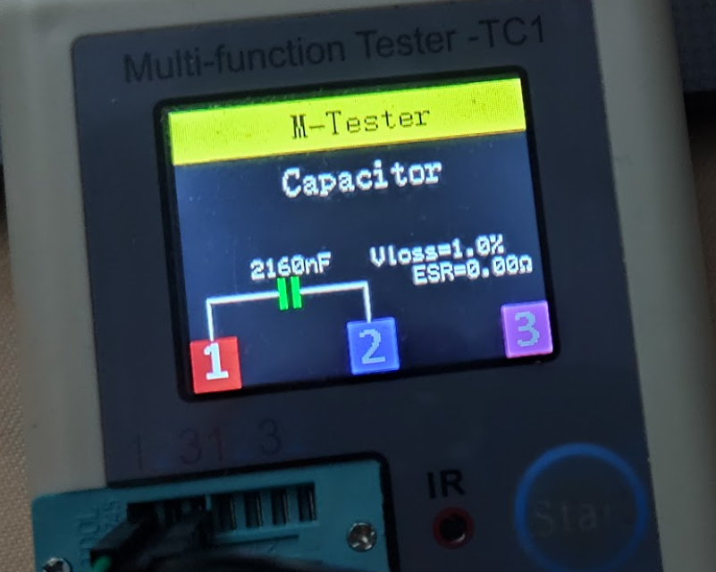

    >>21447144 Sometimes it is better to refrain from hastily criticising others.
    M-Tester screen showing a capacitor measurement of 2160 nF with Vloss 1.0%

  • #12 21845301
    rodakw
    Posts: 10
    HD-VIDEO wrote:
    Use an instrument not a tester
    Then perhaps this is how you should have answered the colleague who asked the question?
    I proved that the question may have been legitimate.
