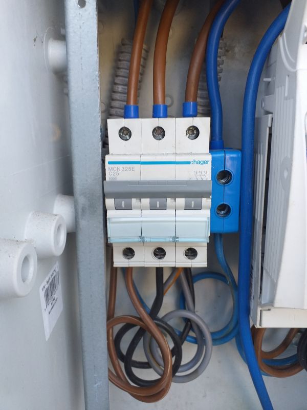

    I measured 84V on the black cable at the exit from the middle protection to the house. Everything is fine on the RBKs - there are 230 V at the input and output on 3 phases. The C25 switch was probably damaged by water getting into it or by an overvoltage, because recently the power industry replaced the poles with round ones and they were short power outages. Unfortunately, water has collected in the box (about 0.5 l at the bottom of the box). So far, I have not been able to locate how it gets there. Of course, the electrician claims that he assembled everything tightly, and yet ... rust on the gray phase wire and on the clamps under the fuse say too much (sic!) The guy from the power industry, when he saw it, said that if it continues like this, it will I've had electrical equipment burn out. in the box! I need to find where the leak is and seal it and drill a small hole in the bottom of the box to let this water run off. First, the electrician who connected it said that it was the water vapor that condensed on cold days - unless the electricity caressed him, because I don't believe in such fairy tales.

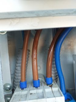

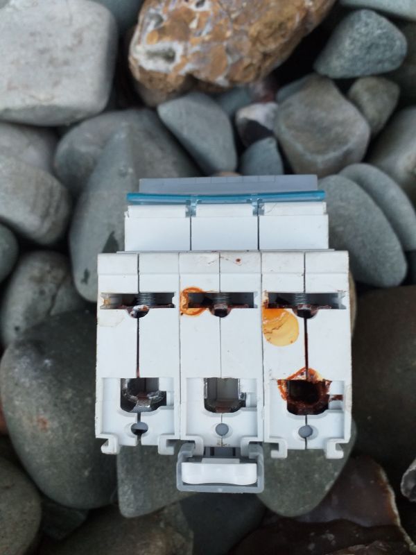

    Cool, I survived without 1 phase, because I reconnected the second part of the house to the third phase, which was free for me (old building in the 1930s, extension in the 1960s), because my whole house is divided into two phases - in the near future I will have to make a whole new electrical installation on the occasion of the renovation of the floor, then I will use all 3 phases. 3 years ago I had only 1 phase, but when my fuses started to burn every 3 days, I invested in a 3-phase connection.
    The electrician botched the job - he installed the box in such a way that water got inside through the hole for the screw fastening to the wall during rainfall. The three-phase fuse was then flooded with water flowing down the power cable (in the photo)
    Voltage Absence in B25 Overcurrent Circuit Breaker: A Look into 3-Phase Power Failure
    I replaced this circuit breaker and there is 230V on all phases in the house and sealed the box - fixed.
    Of course, the electrician who installed it said that his warranty expired last year (24 months) and does not recognize my complaint, because I saw him assemble the box and did not pay attention to it (what a cheek) and he will not refund any costs repair - is it ok?

    At the moment and the situation, take some time and check carefully if the ZK is well sealed and re-inspect after rainfall.
    As the water will no longer collect, you have peace of mind with this protection.
    In the photo above you can see a drop of water on the line from L2 - spr. what could be the reason.
