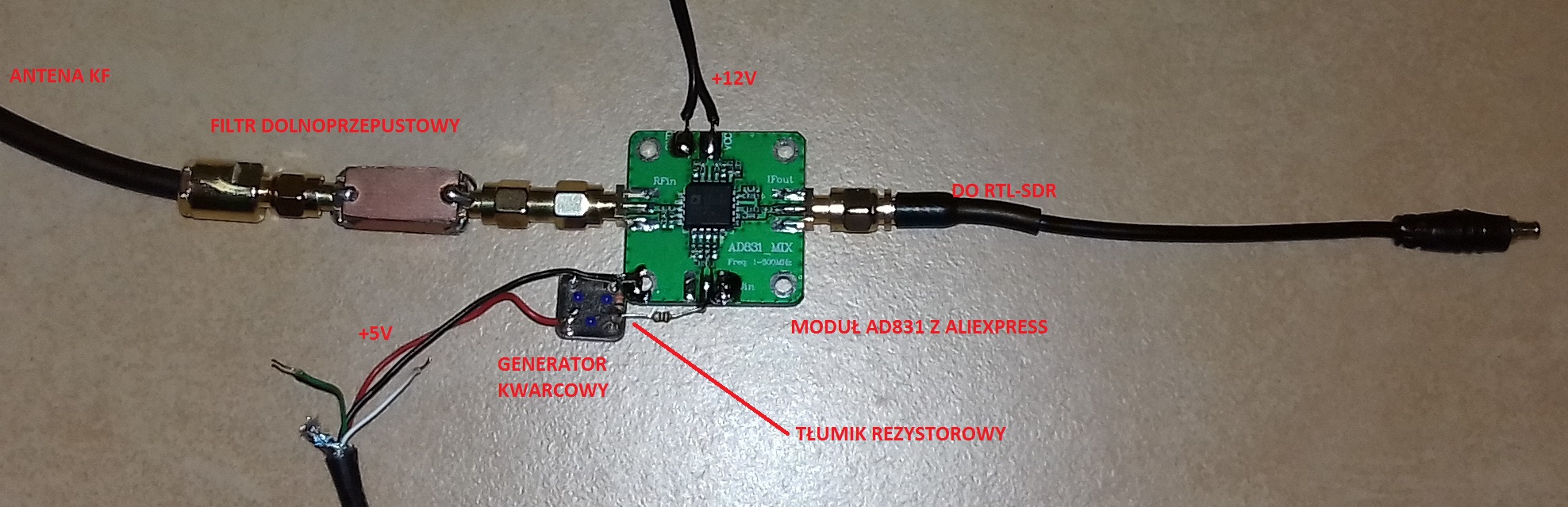

    Both devices are still only direct sampling. Using a mixer with a generator, you can build a real converter plugged in between the antenna and the RTL-SDR antenna connector.

    When I understood that the converter is a simple combination of a mixer and a generator, and not any complicated device, I built something like this myself:
    Choosing an SDR Receiver for Airline Channels, Electronics, and Mobile Use20181005_2..732.jpg (418.73 kB)You must be logged in to download this attachment.
    Several elements connected together, a great description is probably not necessary. If you need any details, just ask.
    You can omit the low-pass filter at first and build it later if needed. In quiet rural areas it may be unnecessary, but in the city, near strong transmitters.

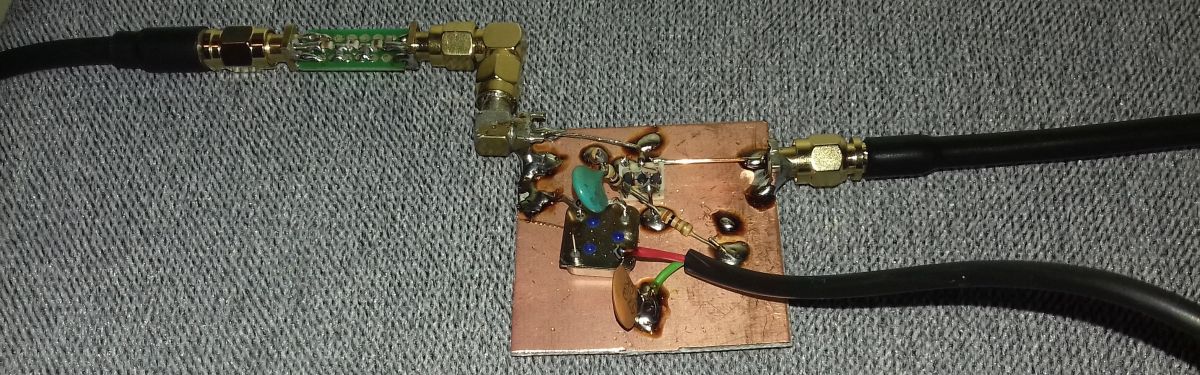

    Hello, I am also planning to start my adventure with SDR. I`m currently using a Baofeng dual band. but I want to expand the possibilities of listening on the air. My question to Sumar is "I live in the city, in blocks of flats around. So I have a lot of interference. Does the above description of the topic only work on kf? I would like to build something with my own efforts, some filters for this pendrive.
  • 30 MHz low-pass filter suppresses FM stations

    The photo above shows the filter already closed in the housing. Here is an earlier photo where you can see what`s inside. It`s an ordinary low-pass filter with SMD elements, made according to a pattern. At the moment I don`t remember what the values of the elements are, but it was made at about 30 MHz. Currently, I have changed the location, I have no way to hang the HF antenna here and the topic has been forgotten for a while. However, I can say that the filter worked properly - it did not worsen the desired signal, but it definitely cut out regular FM radio stations. The construction of such a receive-only filter is simple, because there is no need to wind the coils with thick wire, you can only use ready-made SMD elements, because it will not transmit any power.

    Well, it`s a pity you don`t remember. Some kind of projection would be useful. Because it`s not very visible in the photos. And ready-made filters exceed the price of the device. I already have the monitor. Connect the HP terminal to this. And listen. To start with, which SDR modem would you recommend, working from 100khz to 2GHz? If I like it, I`m willing to play with the antennas.

    You can look at the diagrams in google images under sdr upcoverter. Most of them have a low-pass filter on the input. To start with, I recommend the blue tuner + upconverter. If you are not afraid of a soldering iron, I recommend the passive one with the ADE-1 mixer. As for the terminal, it may be weak. I tried to run RTL-SDR on something like this and it was very sluggish, both on Windows and Linux. However, SDR is resource-intensive (especially spectrum analyzer and waterfall).
