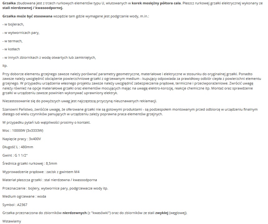

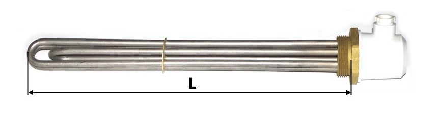

  • #8 17938395
    wiesko42
    Posts: 83
    Rate: 24
    The view and available description are attached.
    I didn't expect that the current consumed by the heater would be so high 14.5x3=43.5A I don't understand now since the heater is powered by 400V then P=400Vx43.5A| P=17.4kW, not 10kW. I thought that the current would be of the order P=UxI| I= 10000W/400V| I=25A, I will not mention the calculations from the calculator provided in the thread where the value is 18A.
    • Choosing a Fuse for 10kW Heater with 400V Power Supply: Understanding Phase Currents widok grzałki.jpg (28.77 KB) You must be logged in to download this attachment.
    • Choosing a Fuse for 10kW Heater with 400V Power Supply: Understanding Phase Currents opis grzałki.jpg (138.84 KB) You must be logged in to download this attachment.

    The description is misleading. The heater is connected in a star, so the power supply for each branch of the star is 230V. And for this voltage you calculate the branch current. So 3300/230.

    Ok, at this point I may have misled the forum users. The description of the product I bought does not indicate that it is star-connected. I cannot contact the distributor. When I have more information, I will post it here. Thank you for your help

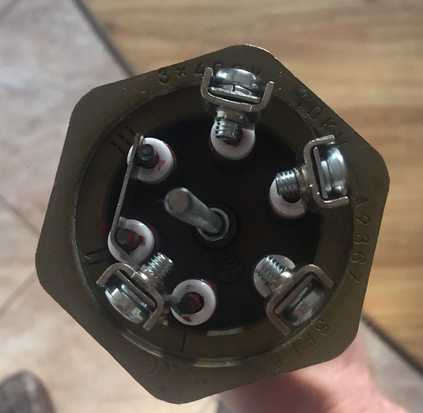

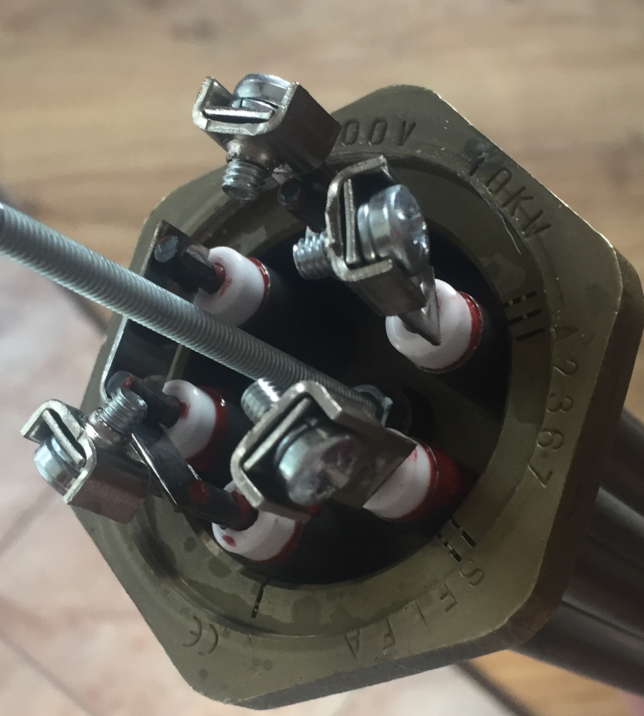

    Show me what the connection looks like under this white box.

    If the heaters are connected in a star, the current consumption from each phase is 14.5 A, and if they are connected in a delta, the current consumption from each phase is approximately 8 A.
    That's what.
    Measure the resistance of one heater and everything will be clear.

    Resistance +/- 17.5 Ohm for one heater. The connection shows that it is a star. I don't understand why the markings are 3x400V and not 3x230V? As I understand it, from common N, each heater is connected to a single phase. G1-f1, G2-f2, G3-f3, so there is 230V per heater.
    Unless the heater is simply for 400V phase voltage and interphase voltage is 690V
    • Choosing a Fuse for 10kW Heater with 400V Power Supply: Understanding Phase Currents IMG-5454.jpg (430.58 KB) You must be logged in to download this attachment.
    • Choosing a Fuse for 10kW Heater with 400V Power Supply: Understanding Phase Currents IMG-5453.jpg (397.81 KB) You must be logged in to download this attachment.

    You have a clear star like a bull. Without a doubt.

    The 3x400V marking is the manufacturer's marking. I still don't understand this marking for star connection. In any case, the heater is powered by 3X230V. The rest is as in the posts above. Greetings to forum members. Current flowing 3x 14.5A
