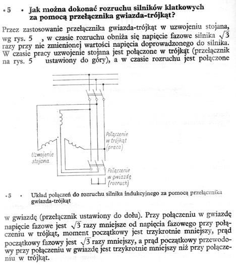

    It is worth noting that the proportion of phase currents is √3, and of wire currents 3 (i.e. the current drawn from the network when starting motors with G/T switch is 3 times smaller).

    Then, connecting the windings in a star causes a decrease in the current in the winding by √3, and the power decreases 3 times (most importantly, the torque also proportionally 3 times, because: P=M*ω, and more specifically M=c*U², where c is a constant not important at the moment).
