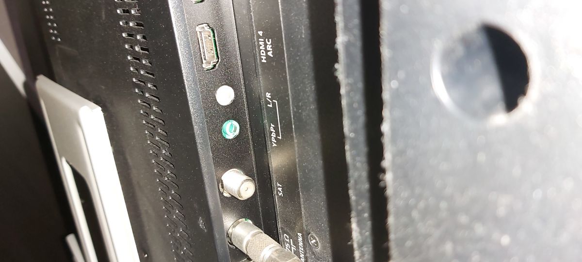

  • #4 18998195
    Yoo!
    Posts: 316
    Rate: 117
    Hello. Have you solved your problem?
    I have a similar one with a Philips TV.
    Tv bought last year. Asking the seller he has BT so I bought it.
    Later it turned out that BT does not support external devices such as headphones.
    I have also been looking for a sensible solution to connect headphones to the TV for some time.
    Did the converter solve this problem for you?

  • #10 19017379
    nomudrek
    Level 36  
    Posts: 2241
    Help: 406
    Rate: 472
    Yoo! Create your own topic and you don't get attached, what kind of photo is it if you can't find out anything from it! Read the forum rules, it would be better to inform you about the TV model instead of a photo. Such info allows you to find information about tv's capabilities, and nothing comes out here because the second section of the sockets is missing.
