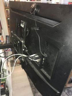

    Good morning, as in the subject. All I know is that you need an adapter, but which one? Transmitter? Receiver?
    How can you then pair bluetooth headphones with such a device?

    I already bought the transmitter, but when I connected the headphones to this transmitter, I cannot hear the sound from the TV. It works well under the computer.
    SONY KDL-43WE750 TV set

    Have you connected the converter to the TV via digital audio output?
    What is this converter?
    Well-adjusted sound output on the TV?

    reyalP wrote:
    The transmitter is connected to the TV headphone jack
    Why didn't you connect to digital :?:

    Changing the setting to TV Speaker does not change anything. The BT device is connected with the headphones in broadcasting mode. After connecting traditional headphones, the sound is played in them.

    And the use of a different USB socket than the one on the TV?

    The pendrive under this USB works.
    Unfortunately it does not work.

    And that blue LED on the case is on :?:
  • #21 18769354
    reyalP
    Level 4  
    Posts: 158
    Rate: 34
    As for the TV, it never glowed there, and as for the adapter, it lights up in red, which means the broadcasting mode.

    reyalP wrote:
    the adapter lights up red, which means the transmission mode.
    Instead of using the TV's USB port, you tried to connect to your smartphone's regular wall charger :?:
    The minijack headphones are 3pin or 4pin :?:

    Bingo. What AxelNext wrote worked fine.
    Thank you so much for the answers!
