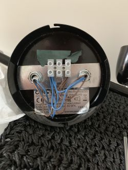

    I bought a new lamp for the kitchen and I'm having trouble connecting it. More precisely, with its removal. I tried different combinations and either the lamp is on all the time and does not respond to the switch, or the only reaction to the switch is the activation of the protection. Could someone give me a hint on how to do it? I have a normal single switch and want all the bulbs on at once. I attach photos of the installation coming out of the ceiling and in the lamp.

    You have three wires, a power in, a power out, and a switch. Total 8 lives. Incoming 3 cores and leaving 3 cores. Identify them. You connect the phase wire from the incoming phase with the phase wire from the outgoing (3-wire wires) to this you connect the third wire from the two-wire (switch.
    You connect the neutral from the three-wire inlet to the neutral three-wire outgoing and to the lamp.
    The remaining wire from the two-wire switch also to the lamp.
    It was necessary to describe the wires before dismantling the junction box. I'll give you a drawing if you need it

    Hi bumble,
    Thank you for your quick reply. It seems to be doing just that, but the switch still doesn't respond. Could you give me a schematic of this connection?

    He doesn't quite understand the questions. Sorry, I'm pretty ignorant on these things. I have three cables from the ceiling. Two three-wire - blue, brown, gold-green. And one two-wire - red and yellow-green. I have three entrances on the cube. I connected it like this: two brown cables from three-core cables and red from two-core cables connect to the brown cables from the lamp. The two blue three-wire and the yellow-green two-wire connect to the blue wires in the lamp. The other two yellow-green cables from the three-wire wires are connected in the middle socket and the metal housing of the lamp.

    Nooooo. You're shorting the switch. What colors are for the switch? Probably red and yellow-green.

    I am asking what is under the switch when you unscrew it?
    Added after 3 [minutes]:
    As there is red and yellow-green under the switch, it should be like this
    From three-wire brown together with red from two-wire and nowhere else. From the three-wire blue together and to the blue in the lamp. From three-core yellow-green together and to the middle in the lamp. From two-wire yellow-green to brown in the lamp.

    Approx. Well, it's different. Is there a second switch in the room?
    My previous advice is outdated don't connect like this.
    Added after 52 [seconds]:
    Do you have anything to check if there is current on the wire?

    There is a second lamp in the room. The switch is double - two switches and one turns on the light in the dining area - here he installs a new lamp. And the other turns on the light in the kitchen - two fluorescent tubes in the ceiling
    Troubleshooting UK Kitchen Lamp Connection Issues: Wiring, Switches & Protection Activation
    Unfortunately, there is no metric. Even if I connect the lamp in the dining area or leave the cables hanging, it does not affect the operation of the light in the kitchen

    It's supposed to be like this. Of the three-core two brown together and not connected anywhere else. From the three-wire two blue together and to the blue in the lamp. All yellow-green together and to the middle in the lamp. Red to brown in the lamp.
    Give a photo of the switch on the back, i.e. where the cables are connected.
    If you settle, there is no phase continuity on the switch because the brown ones are disconnected. At the switch, one red is the kitchen, the other is the dining room.
    Two brown together and insulate. Red to the brown lamp, blue together and to the blue lamp. Yellow-green together and to the middle. It's a pity you didn't put the switch in right away.

    The switch on the left looking from the front is the one from the lamp that I connect

    Okay connect.
  • #17 18047580
    bocian1821
    Posts: 9
    It works 👻👻👻
