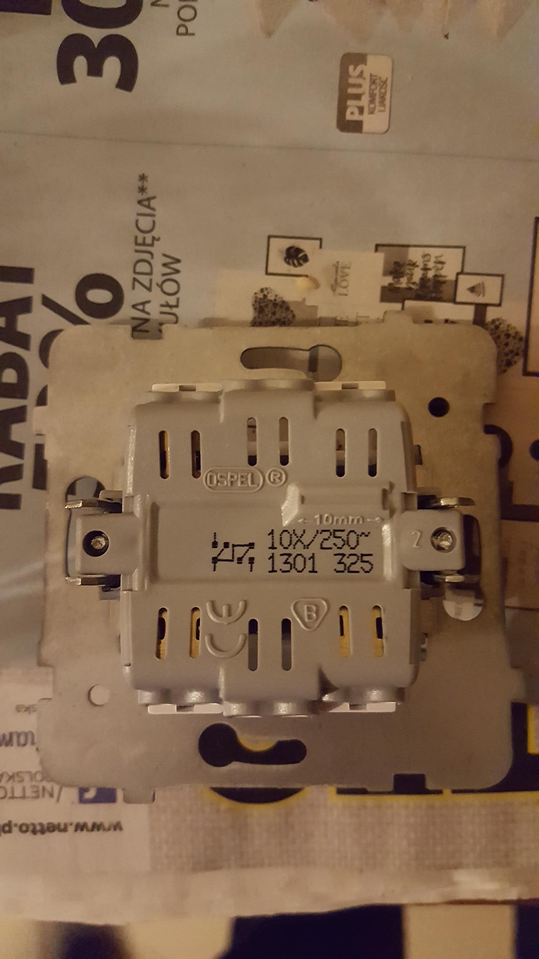

    Hello, I have no idea how to connect the light switch in the kitchen - chandelier and wall lamp. In the box I have 3 brown cables (Z, O, K) to connect and the socket has 2 switches - I am completely green in these matters and I ask for the simplest advice.

    The cable marked Z (probably power supply) for the lower left terminal next to the CE inscription, and the other cables as desired depending on which key is to be lit. The bottom right (O cable) and top left (K cable) terminals will be connected. Turn off the power during assembly.
    But each channel has two entries - no matter which one I choose? Will the bottom left next to CE be the one on the corner?
    I enclose a picture and add that it doesn't work for me

    No matter which input you choose, it should be within one channel. Is there voltage on any of these 3 wires? Do you have what to check? How do you put all the lights on together?
    I turned on the light in the hallway and suddenly the kitchen started working. I have no idea what's going on
    I will add that if I have a light in the kitchen (works only with the hallway) and off in the hallway I am talking here and here

    And there was nothing changed in the hall in the lighting switch box? The tin in the picture is in the kitchen? There was a switch installed there before?
    You have a badly connected can in the hall, the phase wire that powers the lighting in the kitchen is connected after the switch and it should be through it.
    A helpful remark - he was also a problem there.
