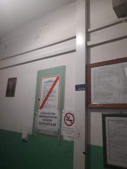

    #15 18102719
    Brivido
    Posts: 2861
    Help: 226
    Rate: 430
    Take a photo and upload it.
    You don't have to go to the 3 phases right away, but you can always prepare the power cord. Here is a question for the manager whether he has any conditions for it, whether it can be stuck in, or in a pipe on the wall. Power supply from the meter, if it is in the stairwell, to your switchboard. If you have a meter in your apartment, it is also worth putting it outside (see the manager). Installations in the apartment are done one way or another, regardless of whether you have a 3f power supply or not, then it is a possible matter of switching in the switchgear. It is worth doing so that you can later, painlessly switch to 3F. Circuits, fuses, never too many. If it was reasonably good, it is the optimal switchgear of 36 modules for the apartment ;)

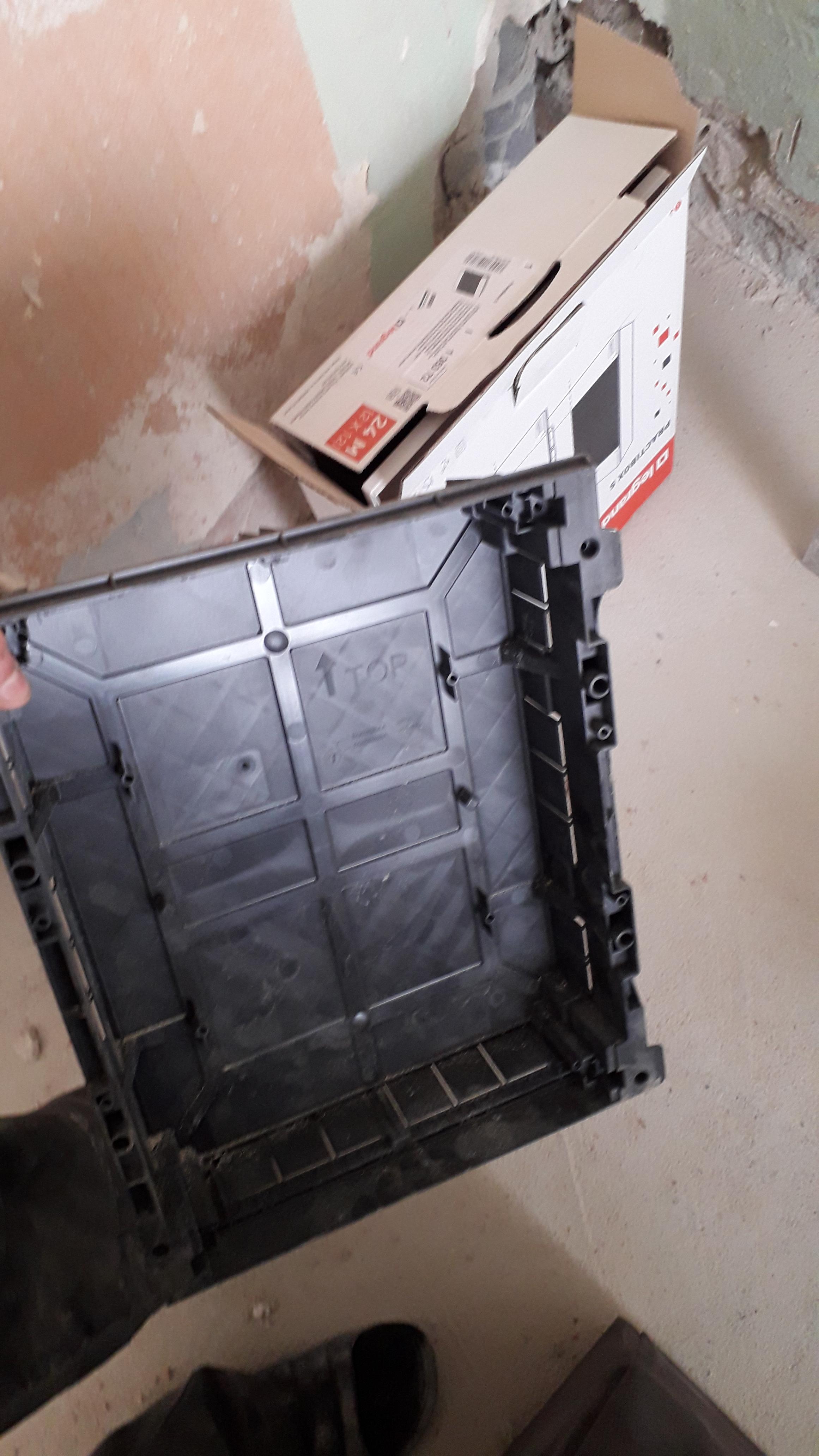

    This is what it looks like after changing the board. We are dealing today with an application for 15kw and 3 phases and a seal for the meter after a small renovation, unless they already have a meter for 3 phases? (I'm still getting lost in the topic)
    The electrician mentioned that the installation in the block is single-phase so there may be complications.
    Brivido - the counter is on the cage in front of the door and next to it, on the other wall, there is a cupboard as shown in the photo. with main fuse.
