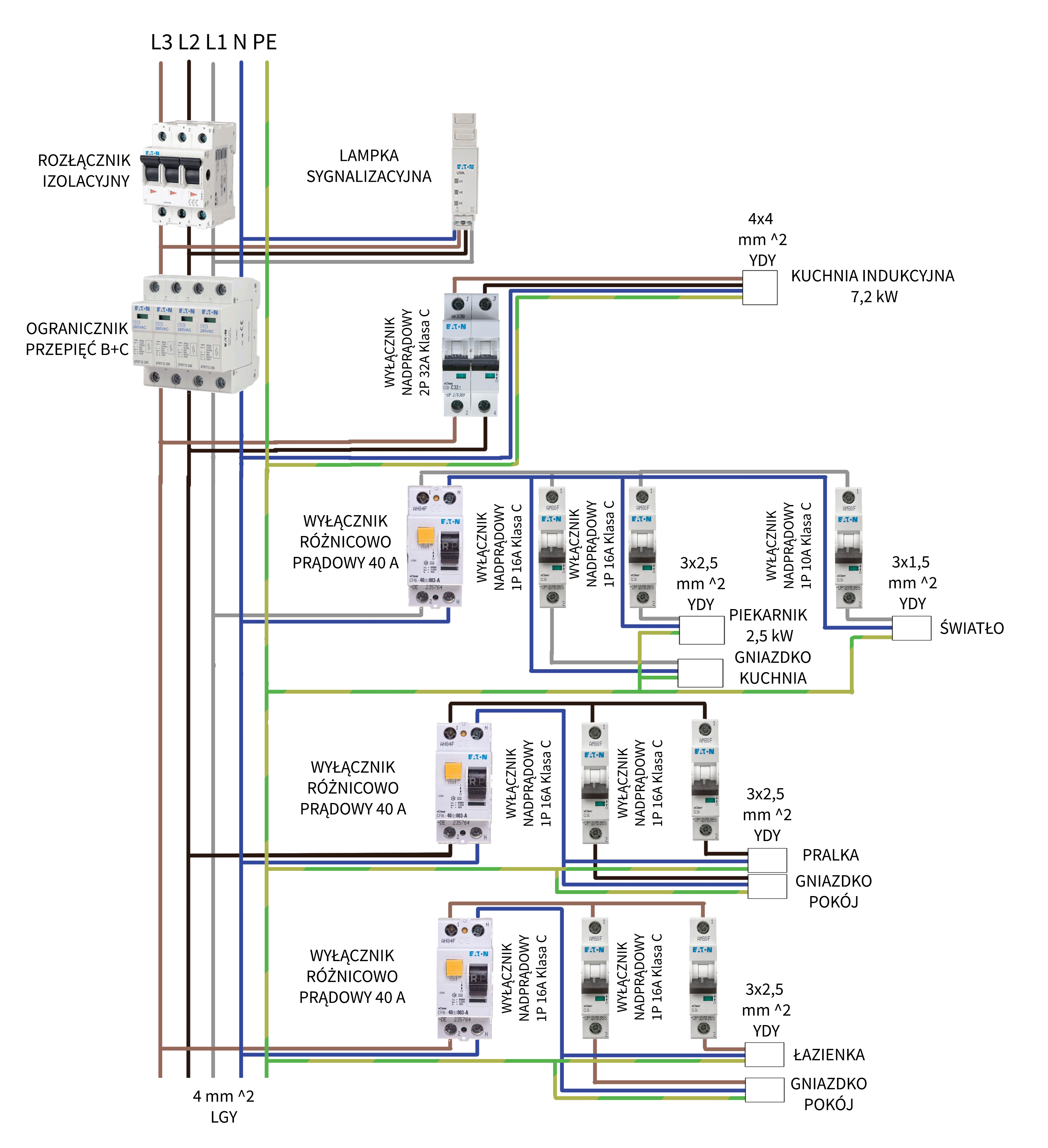

    I'm moving to a new apartment and I'm going to do a little renovation :)
    The apartment is about 50 m² - 3 rooms. I found out that it is possible to connect a 3-phase installation to the apartment.
    I have made single-phase switchgears before, I even have some qualifications in this direction, but I wanted to consult colleagues who are up to date in the subject.
    I made a switchgear diagram. These are the things that concern me most of all
    1) RCD for induction - I met many posts / information from manufacturers that it is not required because the device will not be moved. If so, is it properly connected to the oven?
    2) I selected the RCD for the other circuits with a higher current due to the possible expansion with an additional "S".
    3) Have I missed something?
    4) I can't find information whether the OMY cable can be flush-mounted. Maybe someone could answer my question please.

    Sorry buddy. It's not gonna happen.
    I even have some permissions in this direction
    Why a four-pole disconnector?
    Surge arrester incorrectly connected. Can't see the markings on it?
    And this bigos. Cameras themselves, their descriptions themselves.
  • RCDs required on lighting circuits too

    OMY under plaster, is it possible?
    You can, but why???
    And traditionally a four-track WG. What for?
    RCBO C16 followed by D20. What for?
    What are those D20s doing there anyway? They have no right to be there.
    So you can't arrange a separate circuit for the hob and a separate one for the oven?
    Generally meaningless stucco with no reflection in today's standards.
    Today, lighting circuits also require RCDs.

    Todeo wrote:
    RCD for induction - I have seen many posts / information from manufacturers that it is not required because the device will not be moved. If so, is it properly connected to the oven?
    Referring to this point only, yes - RCD for permanently connected devices is not required, but the oven probably has a 1F standard with a plug, and it already requires an RCD +, as a rule, a device above 2kW, so separate circuits should be prepared.
  • OMY replaced with YDY and lighting moved to RCD

    I can see that for users of the electrode, every detail matters. :)
    I know that the elements presented in the drawing are not a 1:1 reflection of the products that are in the plan, therefore the description next to it should explain what a given element is. Thank you to those who actually wanted to help and did not pick on the details of what is printed on a given element. :) Anyway, I looked for nice photos of the products I wanted on the internet and pasted them.
    The OMY cable is more flexible and fits better in the grooves, unlike the YDY cable. Nevertheless, I changed it to YDY since you recommend it.
    I also changed the lighting connection to the RCD.

    What is the point of laying four wires to a cooker or induction hob???
    In some time you will buy a combined hob or a stove with an oven and wake up with your hand in the potty.
    Frugality, yes, but not miserliness based on myopia.
    The 4mm² in the board wiring is the same as the four wires in the board/cooker circuit.
    Electrical installation is not made-to-measure furniture!
    A little imagination and foresight.

    I improved the surge arrester and added a wire to the kitchen (5x4 mm² ;)
    Are the devices properly connected now?

    Type C everywhere? For what reason?
    32A for an induction hob, why?

    Third attempt and still glaring errors. Are you sure you can handle the assembly? Can you make more mistakes during assembly than in a drawing with a few lines? Remember that people still die from faulty installation. In Poland, it is said that there are many more deaths per million inhabitants than in the west. Well, no one here is playing electric. Are you aware that your actions are putting yourself and your family at risk?
    Do you make changes because you understand them, or do you change them because someone you don't know advised them to do so? If I tell you to change the oven cable to 3x4, will you change it or will you be able to defend what you have drawn at the moment?
    When you do something, especially if your life depends on it, you should understand what you are doing.
    Can you defend your change, for example from a 4-way switch to a 3-way switch? Did you change because a stranger, perhaps even a non-electrician, told you that you had it wrong.
    Do you understand the importance of individual cameras and what parameters they should have? Do you care?

    Back to the drawing. Induction power supply - 5x2.5 and S303/B16A protection are enough. For the protection of other circuits, it is better to use devices with B characteristics, unless you have a turbo vacuum cleaner ;)
    Signal lamps should be secured. Consider dividing the lighting into two circuits powered by different RCDs. I don't like your LGY 4 either.
    And now start the paper work on the construction of the switchgear. I'll give you a hint. Remember the PE bus, the common and separate N busbars, and the distribution block. Analyze the possibility of simultaneous operation of energy-intensive devices and that they are not on one phase of the WLZ.

    A flat of 50m², i.e. standard B16 and B10, plus RCCB (min 2 preferably A) or RCBO (if necessary) and min 6mm².

    I would give each room a separate circuit for sockets and a separate one for lighting (not as it is now - one protection for all sockets and one for all lighting), because if something "whacks", it will then be known which circuit has a "problem" .
    Unless a colleague wants (as in the diagram) to have one socket in each room, then one protection per circuit is enough.

    I am not entirely convinced of the legitimacy of this solution in the apartment, especially since the layout of the houses is even very rarely used - each room separately.
    What I would definitely do is separate the bathroom lighting circuit as the "key" one for another RCD as advised resistor7 .

    Separate in each room is unnecessary spending money, but if someone wants to do it can be done.
    Separate the bathroom, kitchen, as is the dishwasher, etc
    The rooms are overkill.

    And let him do even each socket in a separate circuit. His circus and his monkeys too.
    Only you should know, dear author of the thread, that performance is no longer the same as the >Copy-Paste< method.
    There is no room for nonchalance here.
    For me, however, the most sensitive receivers in the house are the fridge and freezer. Due to the content, it is good to protect them with separate RCBOs.
