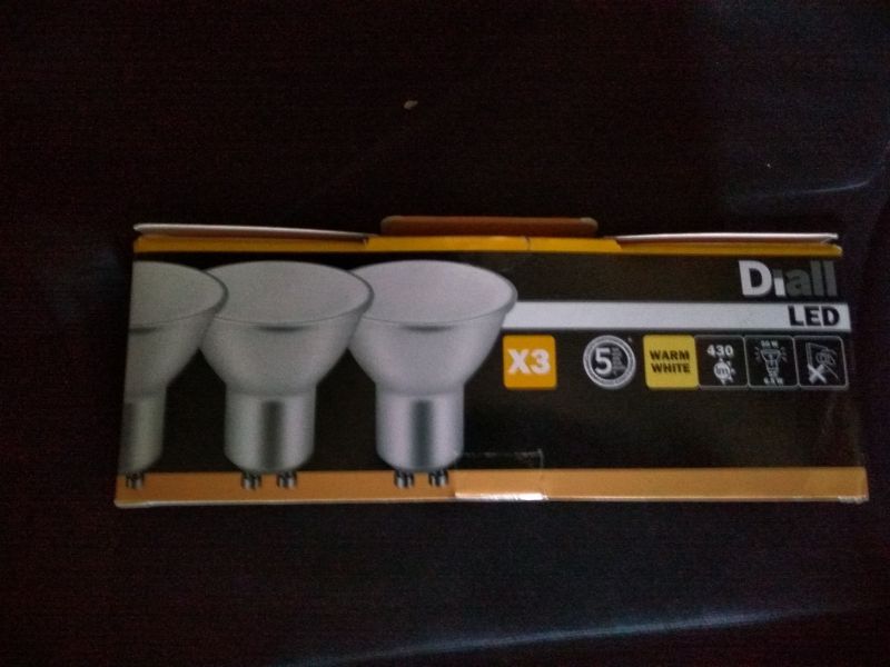

    I have four of them (two are still in the box, because they were packed in three) and they have been shining for over four years, so I can recommend them. If my memory serves me correctly, I bought at Castorama and I think I paid 40 PLN for such a box.
