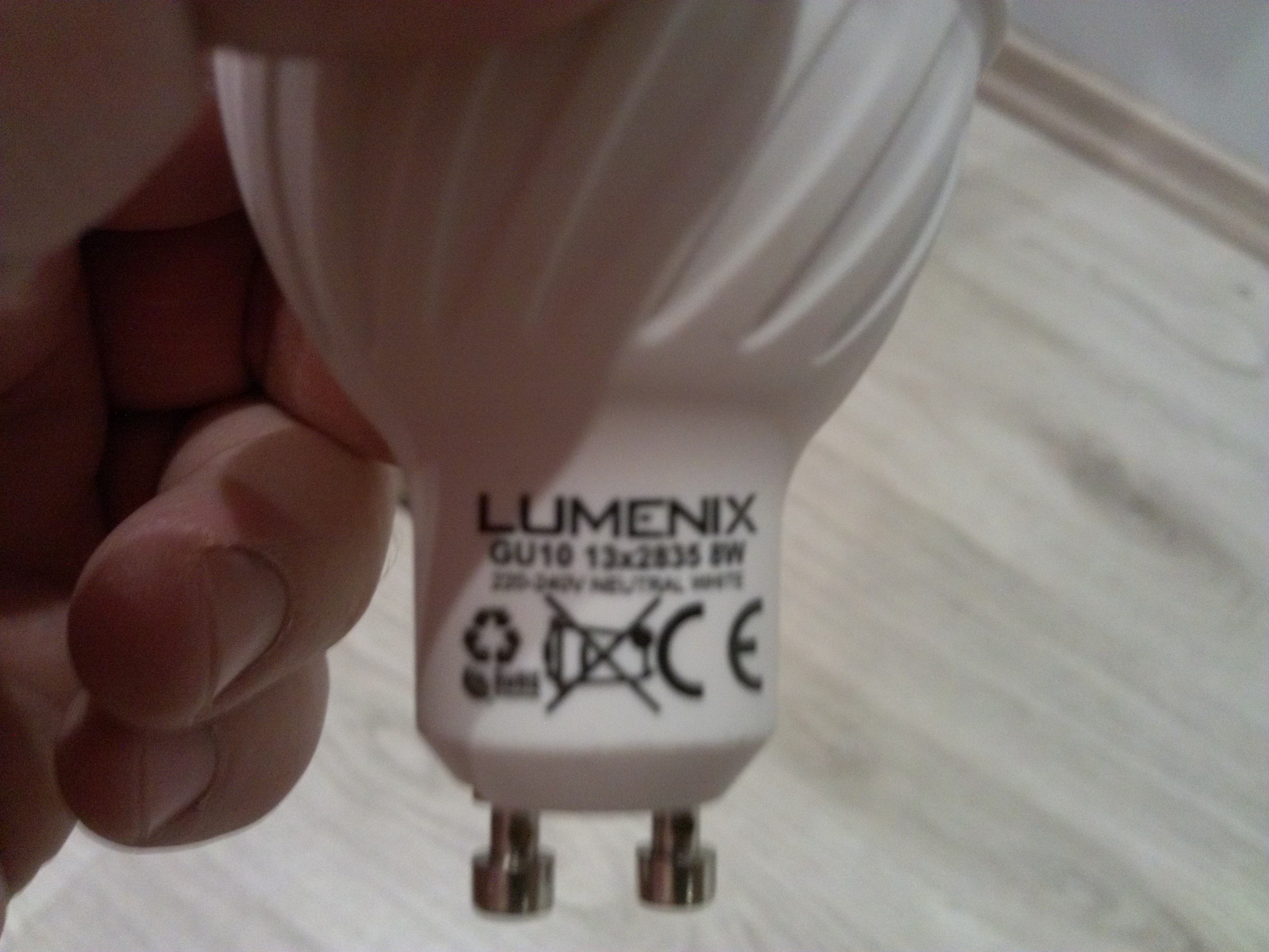

    I am struggling with the problem of LED blinking. It seems to me that they are of poor quality, the seller otherwise thinks that my problem is the only one. All leds run on DC voltage, so a weak AC / DC converter might be the problem?
    For testing, I turned off other circuits in the house, leaving only the light and still the same. I measured the voltage while blinking and it was stable. You can see everything in the recording in the attachment.
    Installation in the house is new, 1.5m2 light. The connection to the building is new, only an old switchgear can be found on the staircase, but it is certainly in copper, but since the voltage does not jump, everything is OK?
    Maybe a little stupid question, but does the frequency of the current have any effect on the receivers like LEDs? I measured with my multimeter but I do not know if the measurement is sufficient - the result is 0.04 kHz and it does not jump. I do not know if another device nearby (read: neighbor) can cause the LED blinking problem.
    I would like to add that it does not always blink and there are different degrees of intensity. Usually, turning the power off and on helps, but the effect is short-lived.
    Thanks in advance!

    ... and here's the problem. I have already written about it many times. I have not met any cheap LED> 5W that shone steadily. The problem with these light sources is the too high temperature to which it heats up. Inside, it prevails well over 100 ° C, which causes the converter to overheat and the effect of flickering appears.
    The sources should be returned to the store, replaced with ~ 5W GU10 450-500lm, which is more than enough, as it is the halogen equivalent of 50W.

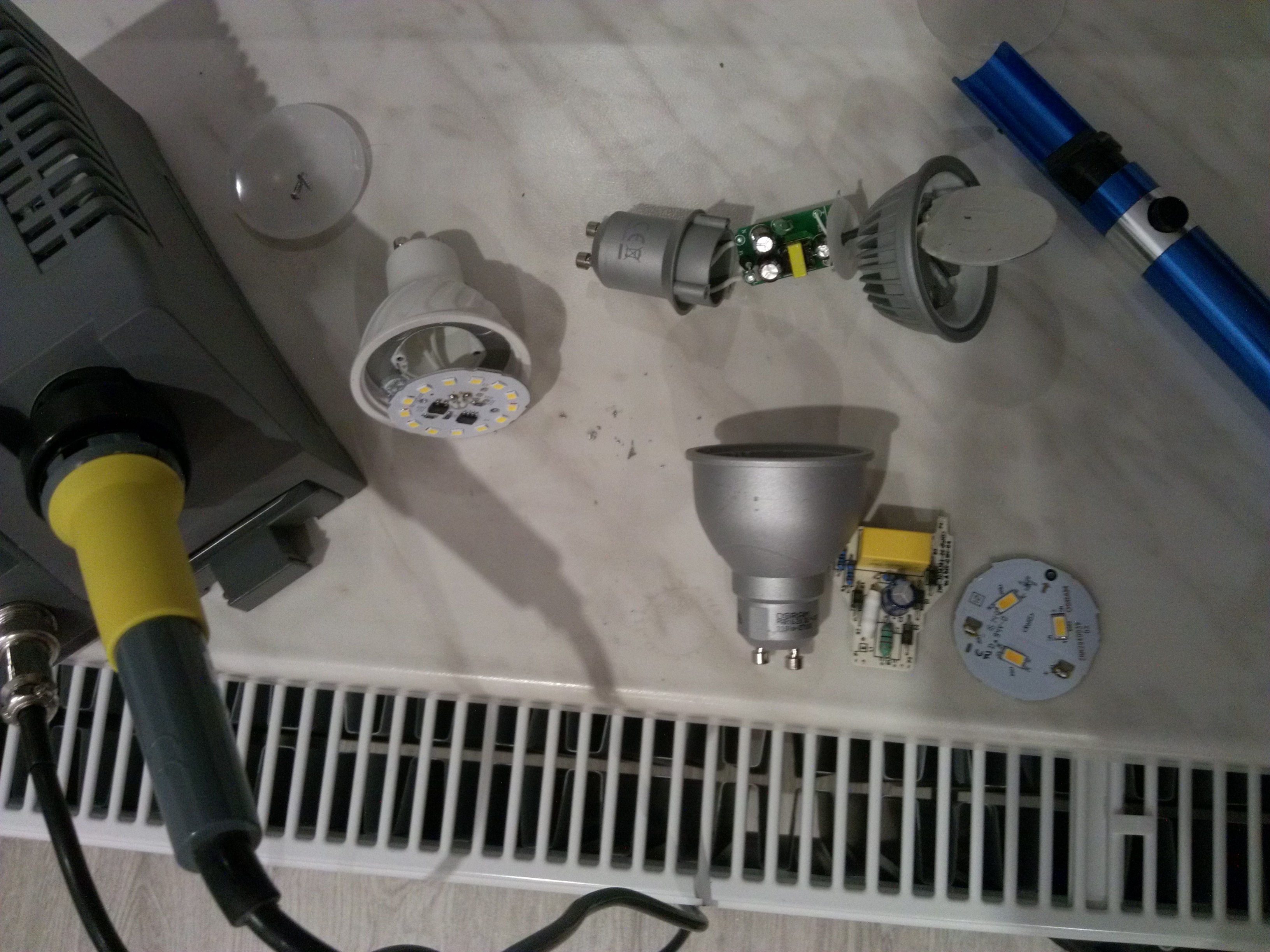

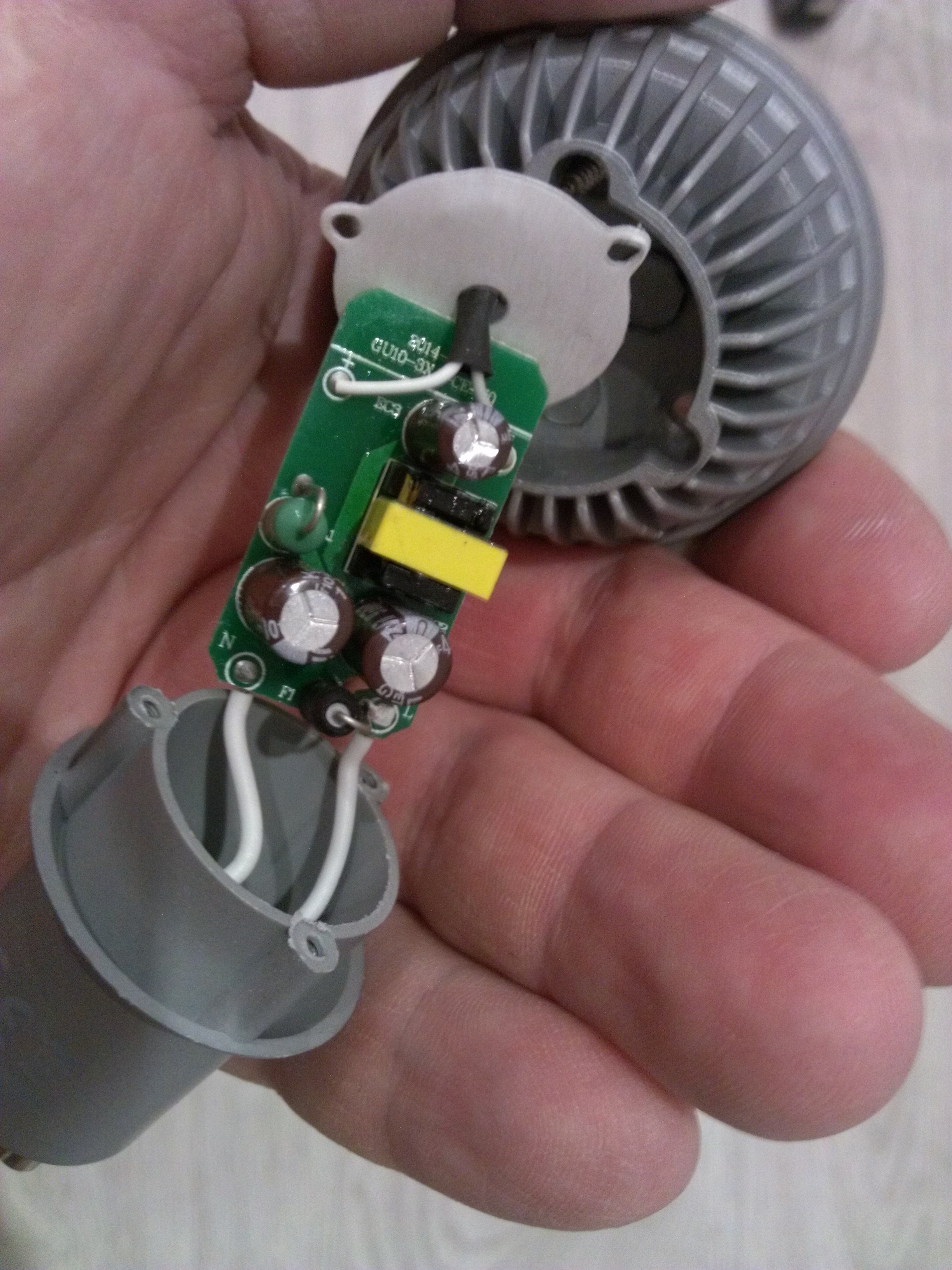

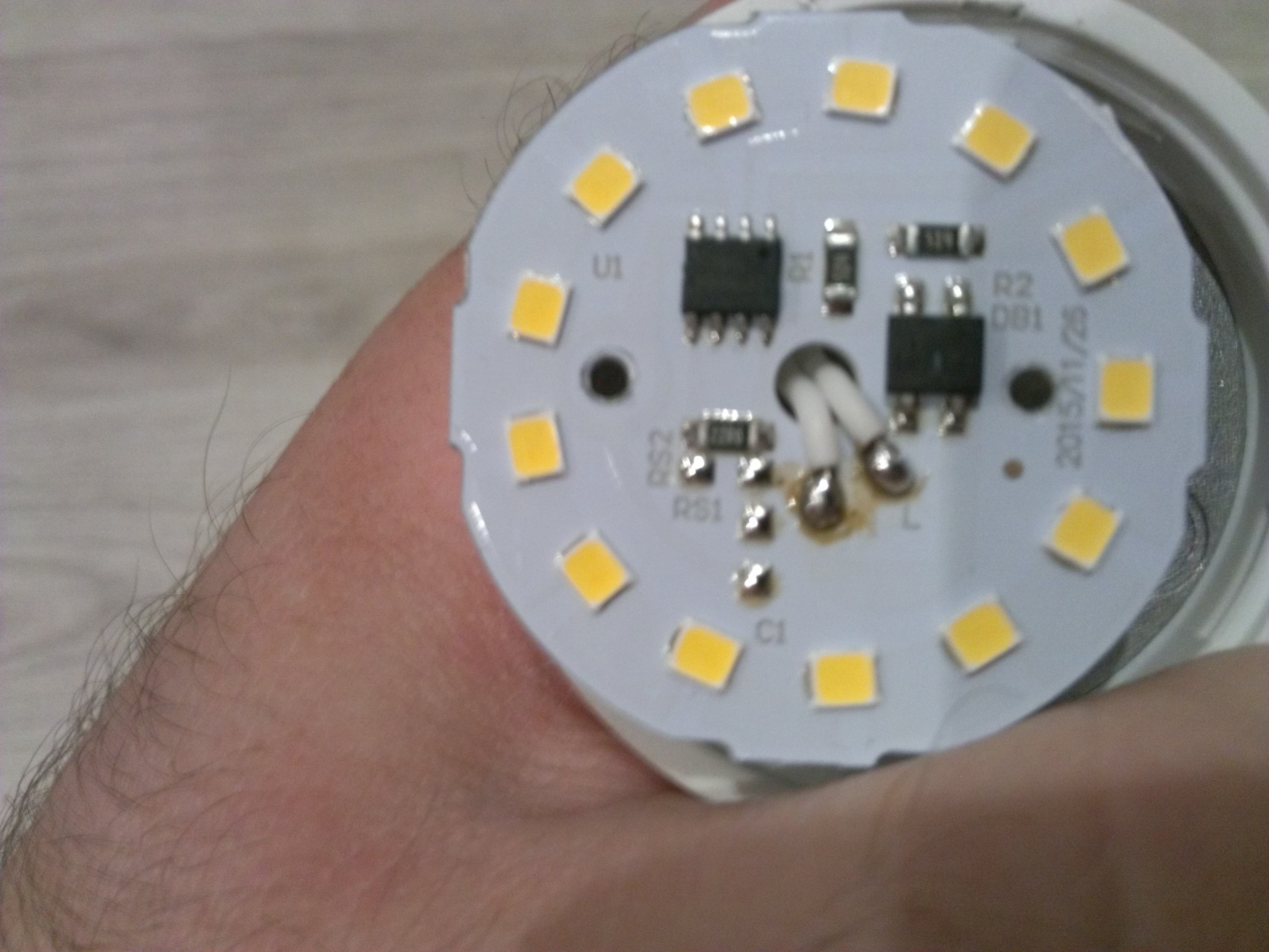

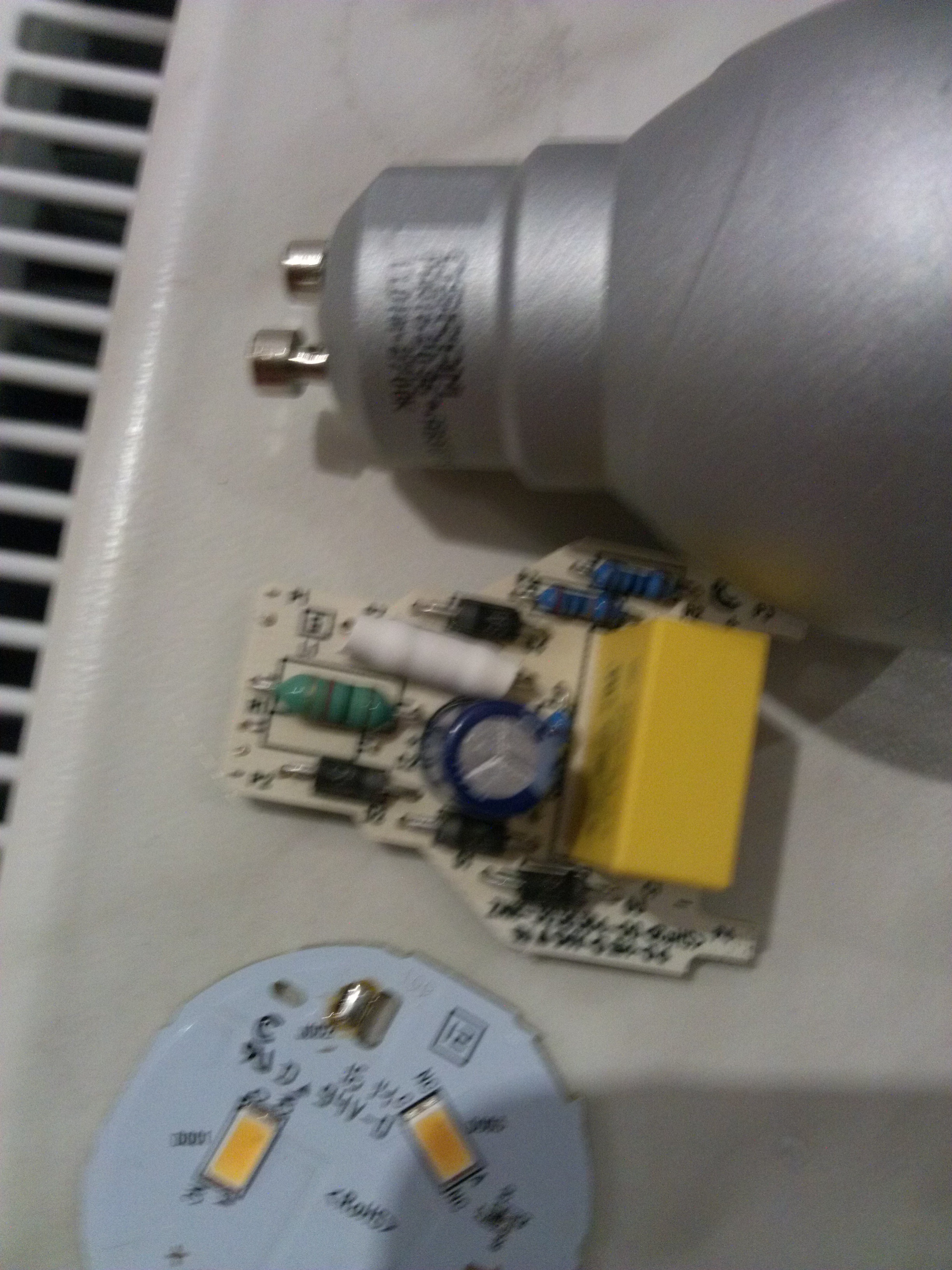

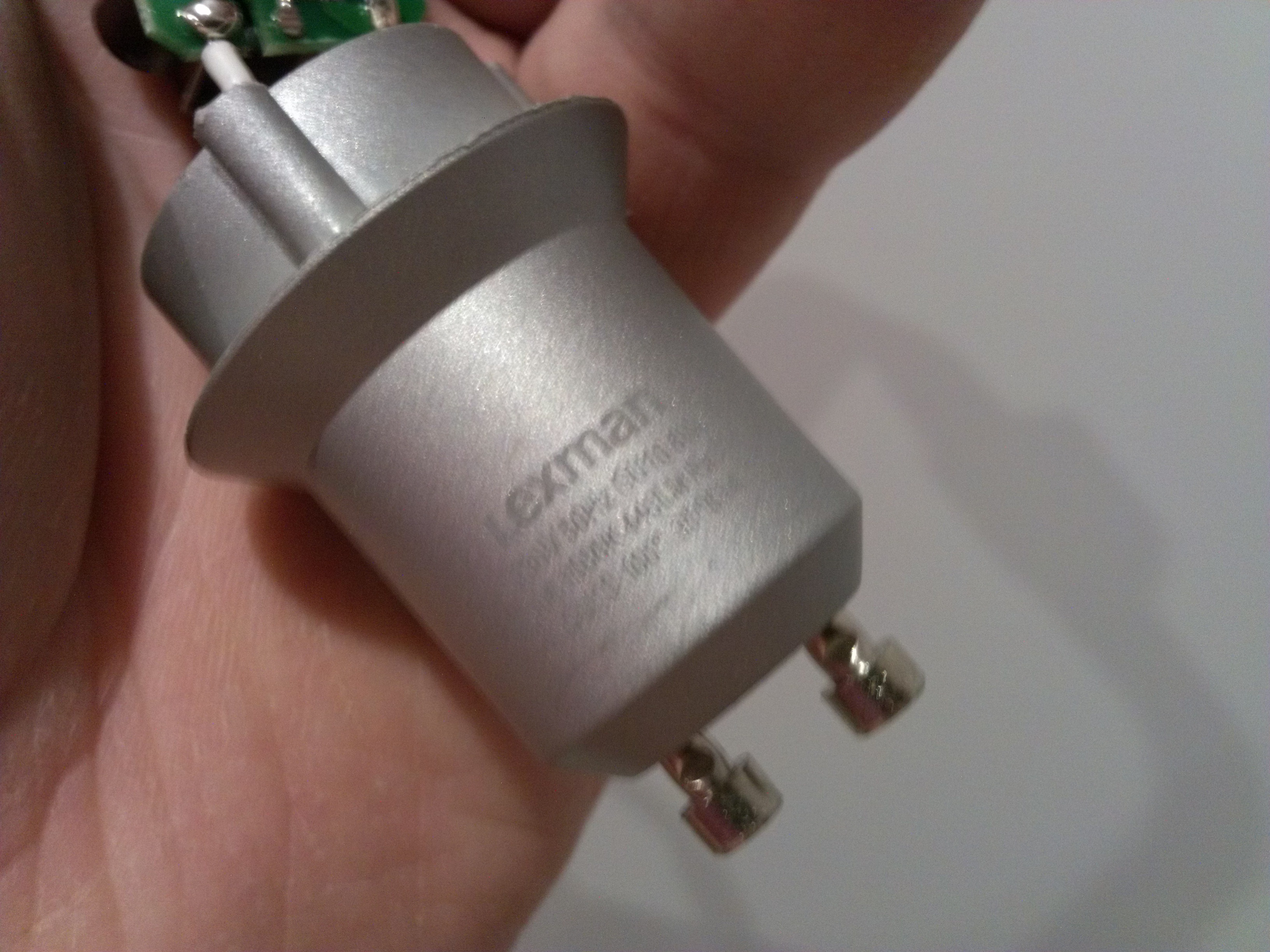

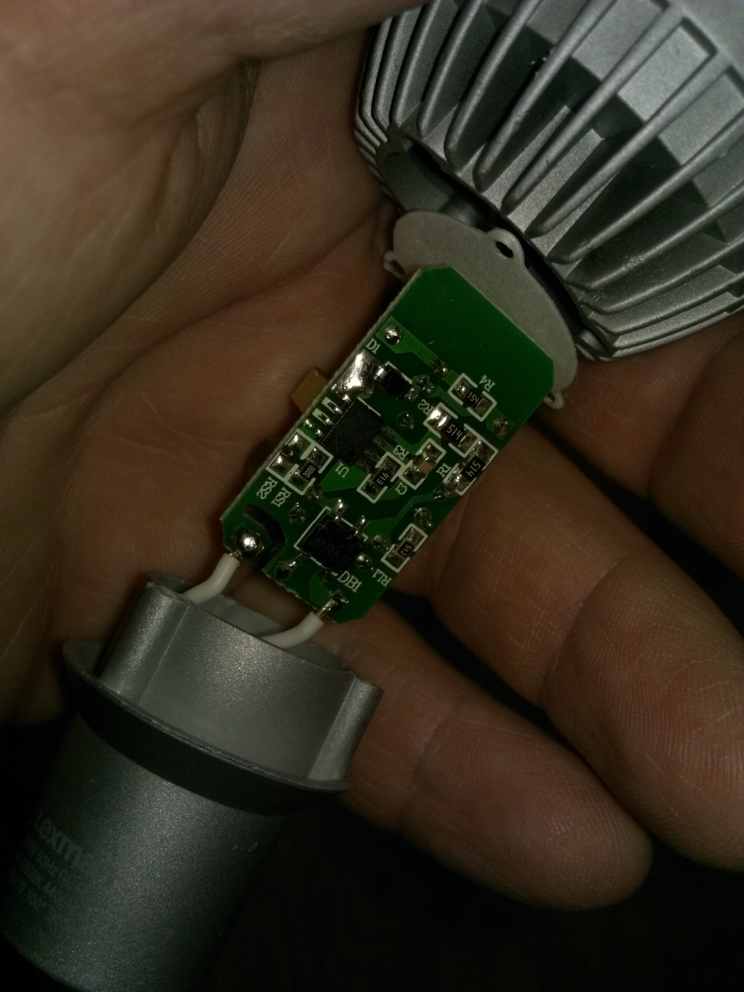

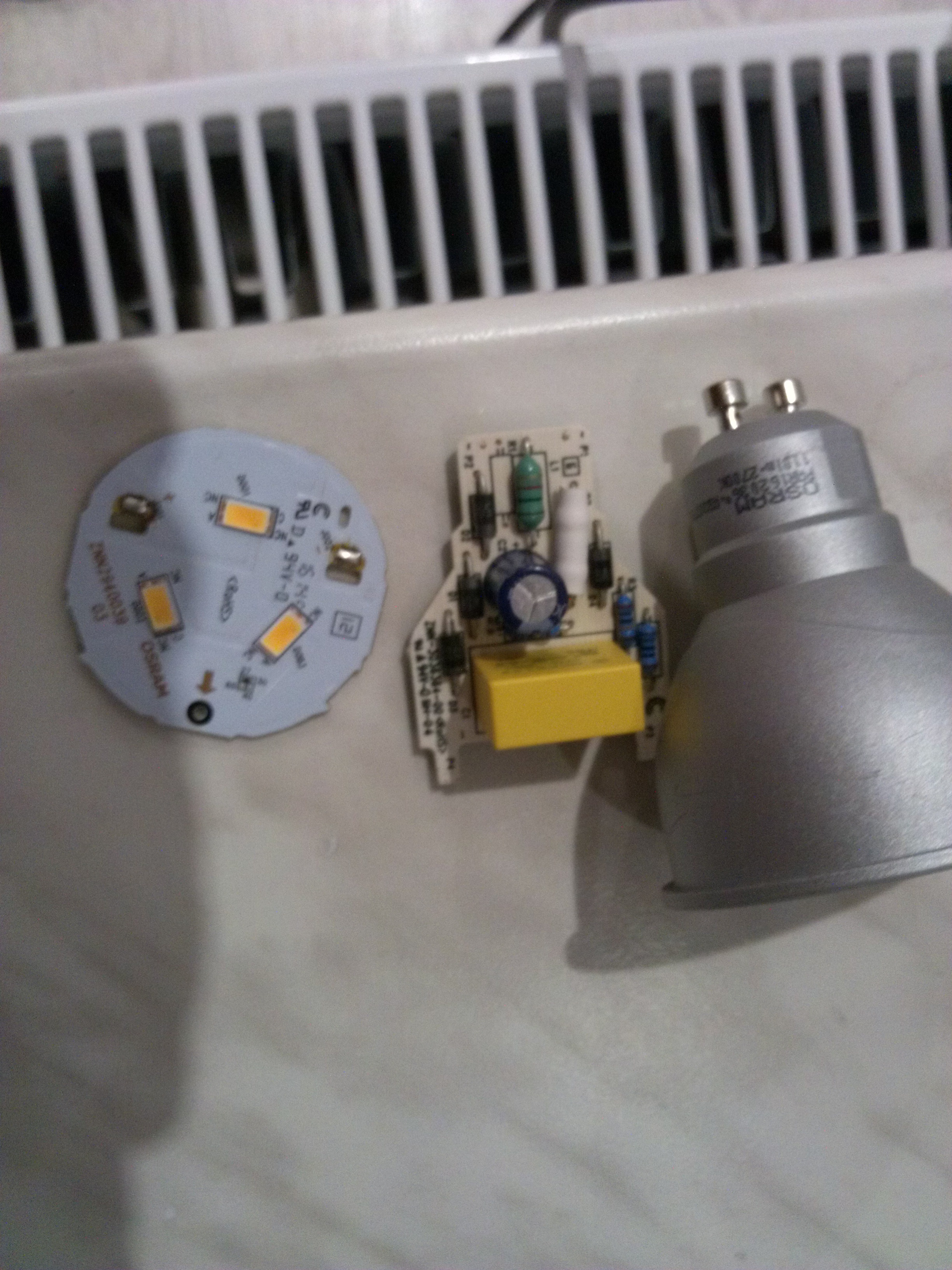

    I dismantled the leds and throw their construction
    1. Leaders that cause problems
    Flashing GU10 leds - what is the reason? Flashing GU10 leds - what is the reason?
    2. The version that does not flash with defective LEDs
    3. Led that solves the problem called a healer :)
    It is strange because there is not much on the power side, and yet it "filters out disturbances"
    Flashing GU10 leds - what is the reason? Flashing GU10 leds - what is the reason? Flashing GU10 leds - what is the reason?
    Compare all three versions
    Do you have any suggestions on what "layout" to build?

    But everything is in their construction.
    Version 1 consists of 13 LEDs connected in series under a 230V rectified circuit with a current limiting circuit. The system probably overheats and starts working at the frequency that can be seen by the blinking. The lack of a filter on the input means that it spreads this frequency to the network.
    Version 2 is a classic of China, rectified by the Gretz circuit, the mains voltage limited by a capacitor and sent directly to the diodes. The circuit is unfortunately terribly unstable and the change in value, especially the capacitance, causes them to change the supply voltage of the diodes. And with low power consumption, the voltage reaches the mains voltage, which effectively churns the diodes. Here the diodes are not defective, but the power supply system.
    Version 3 converter with transformer. So from 230 V AC we do 310 V dc, then we put it on the integrated circuit. It has a keying transistor that powers the primary winding of the transformer. There is a capacitor diode on the secondary winding. This version is supposed to be not too much, but really the most.

    In my opinion, only version 3 leds are remarkable. I would call the rest payday loans.
