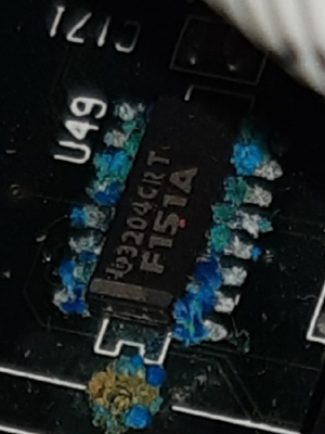

    Hi there
    Looking for IC F151A 3204CRT or alternative as I can't find any details on the internet.
    This IC is used in old desktop PC.
    Attached photo.
    Thank you. Seeking 8*8 IC F151A 3204CRT or Alternative for Vintage Desktop Motherboard - Photo Attached

    Search 74F151A.

    Thank you for sharing.
    Replaced with mentioned part. Working fine.
