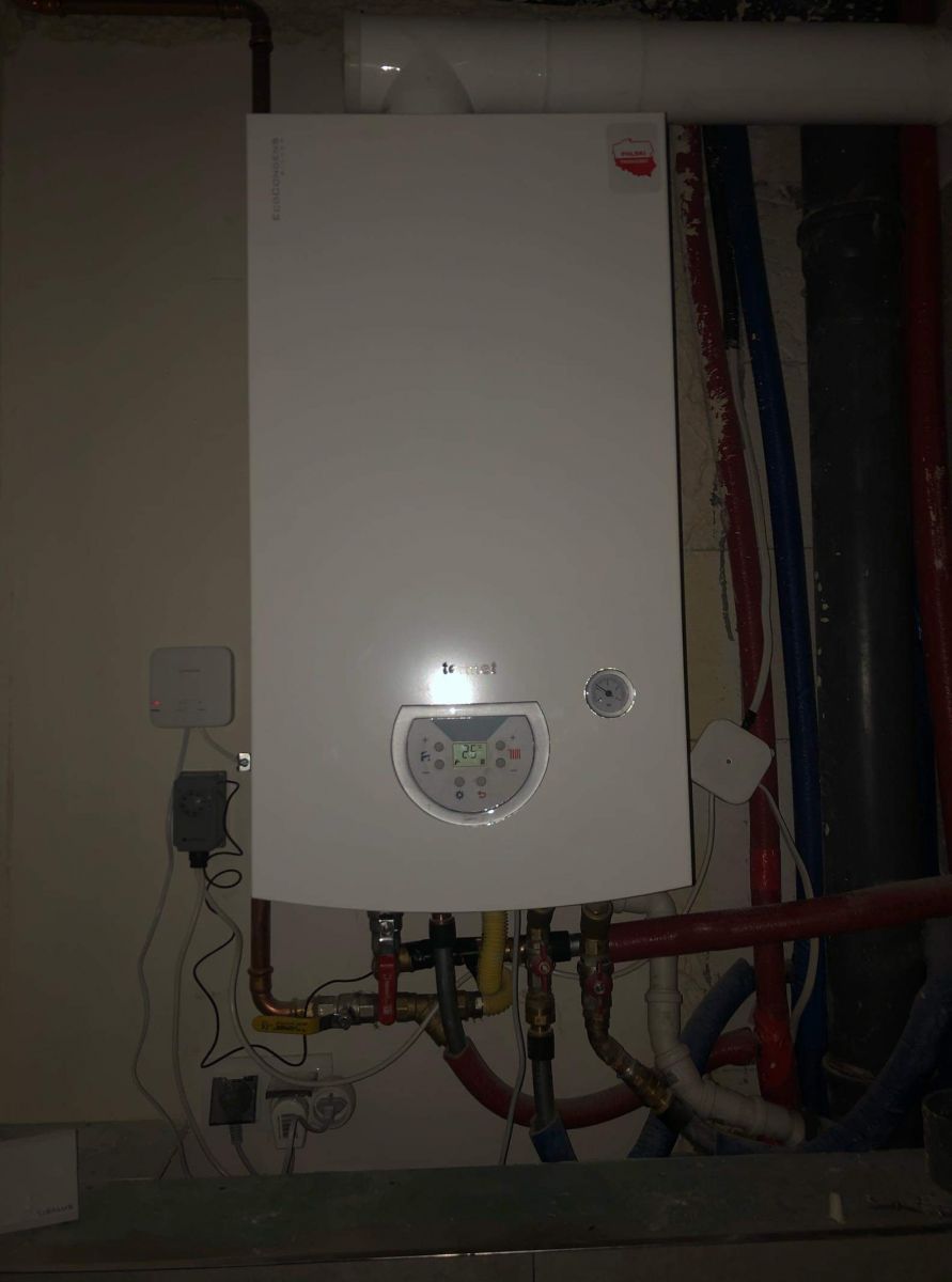

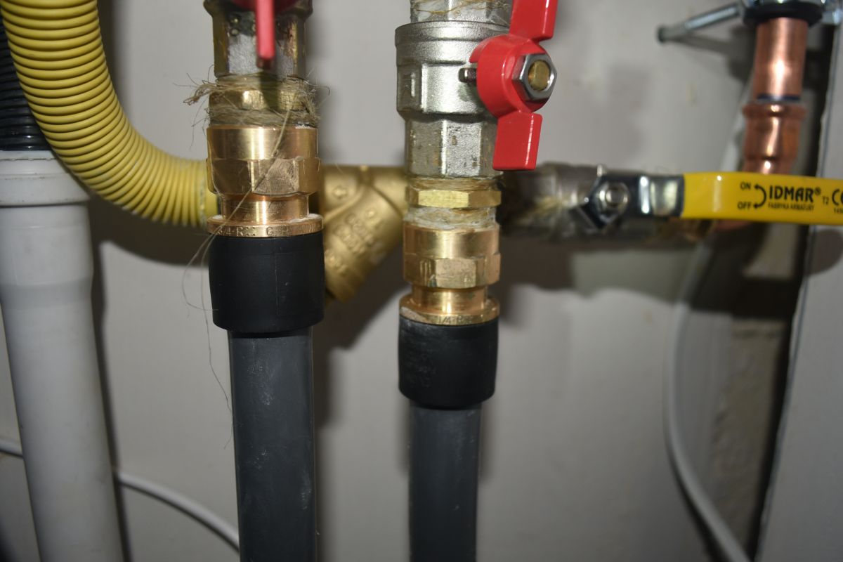

    I have a question about this P02. I have a new Termet ecd stove at home. silver two-function - the installer made the settings with an exhaust gas analyzer, he knew that I only had underfloor heating at home...
    I asked him whether I could reduce the temperature below 40 C - I received the answer that the stove was set correctly according to the exhaust gas analyzer and this was the temperature range.
    And here's my question: P02 changes something in the furnace? Does it mean that the boiler mixes something differently? Could it be just as well not to have this parameter 0 or 1, just to make it easier for the underfloor installers not to overheat the floor????
  • #19 18408821
    Wojtermet25
    Level 30  
    Posts: 1061
    Help: 155
    Rate: 228
    The installer does not understand what the supply temperature has to do with the regulation of the combustion process using an analyzer.
    Parameter P02 allows you to reduce the supply temperature to 25 * and protects underfloor heating against too high temperatures, so you should set it to a reduced temperature.
    Just for information, you should not touch the parameters P04iP06 cannot be lower than the lower one and P05iP07 cannot be higher than the higher one (I know, a bit crazy).

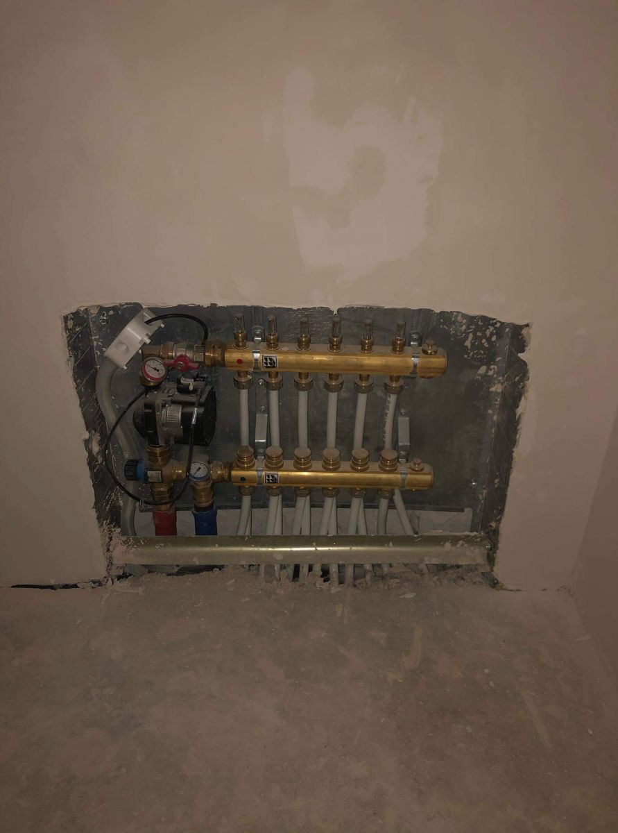

    And I have one more question for my colleagues. I have pumps and water mixers in the manifolds. For now I have them set to max. Can I reduce the temperature at will and the stove will heat a small water circuit? Does this mean that when the water mixer valve closes, does it harm the boiler pump?
  • #22 18410303
    Wojtermet25
    Level 30  
    Posts: 1061
    Help: 155
    Rate: 228
    Yes, you can set it to reduced.
    These mixing systems are unnecessary for your boiler and may cause increased gas consumption. Maybe take photos of the installation or make a diagram.
    This is a new installation or a residue from an old high-temperature boiler.

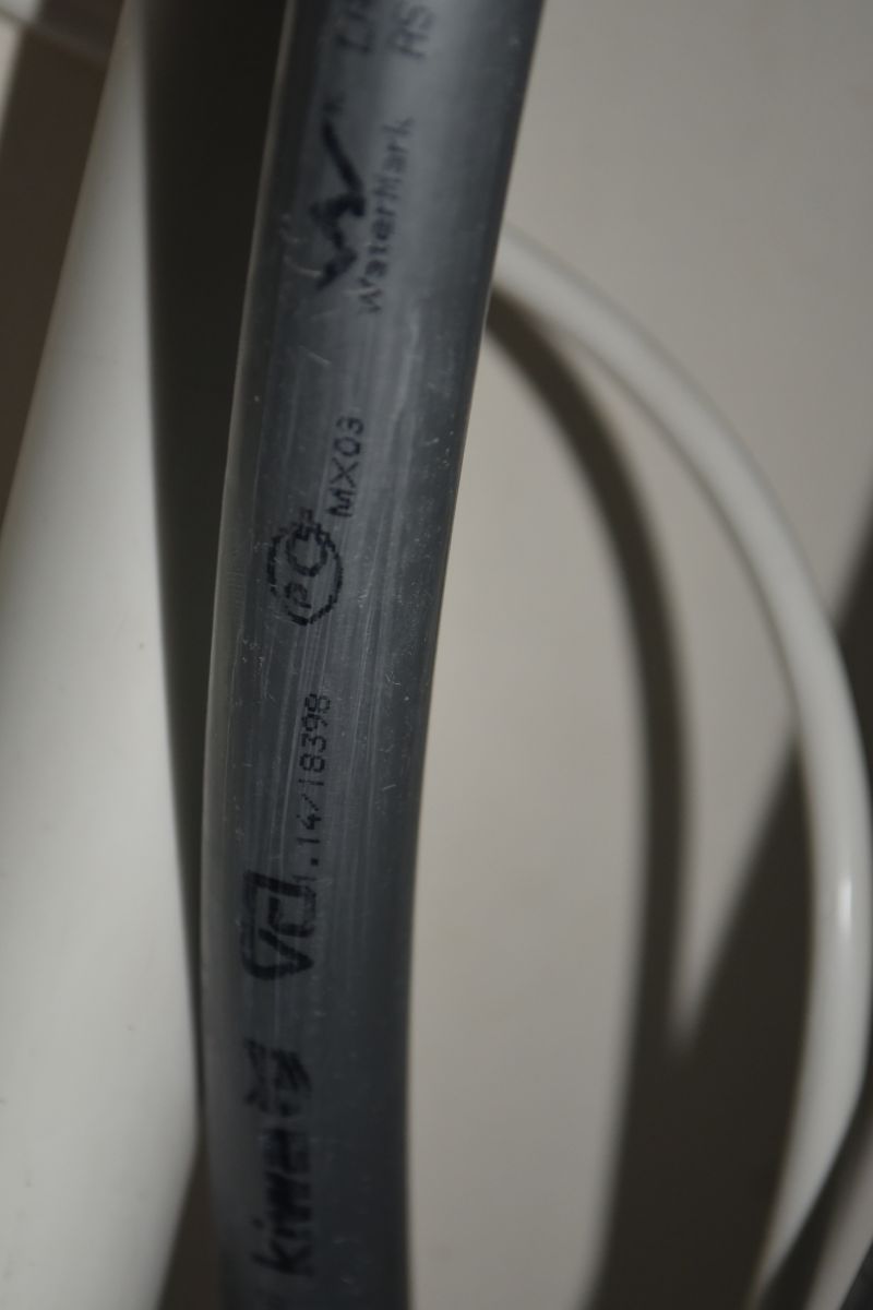

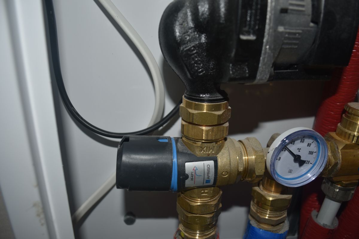

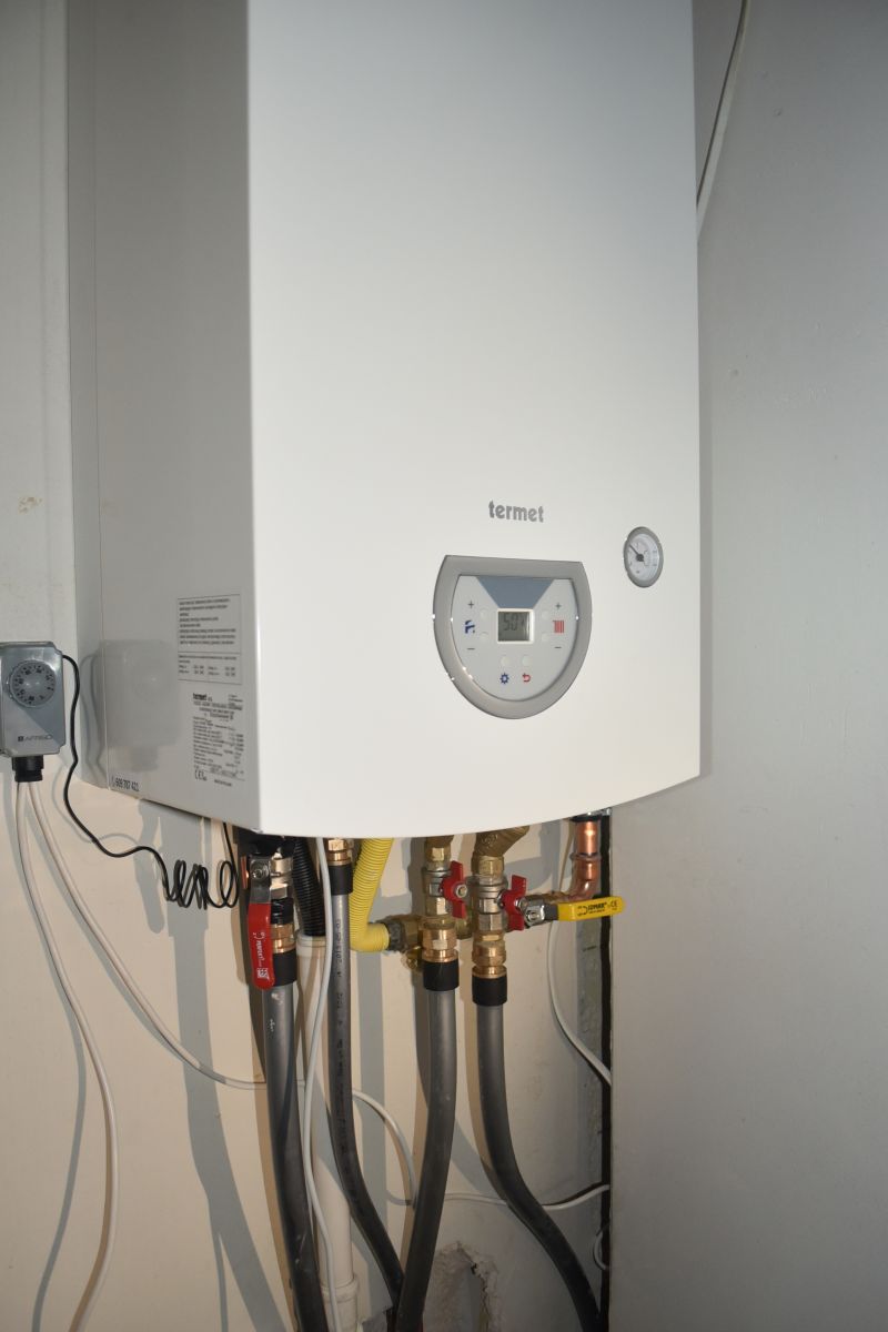

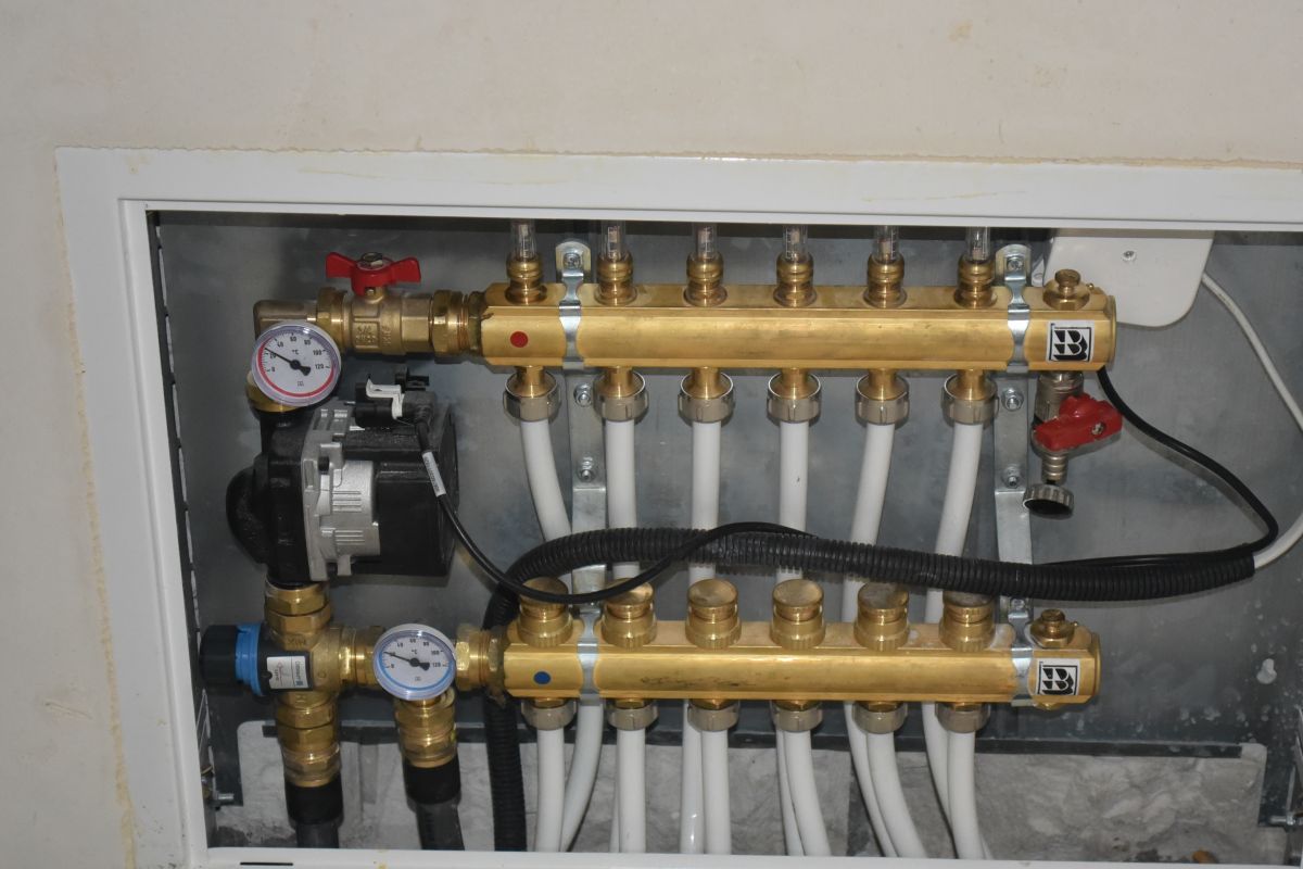

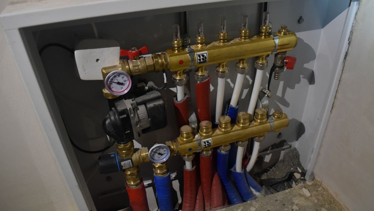

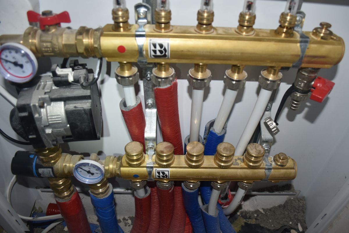

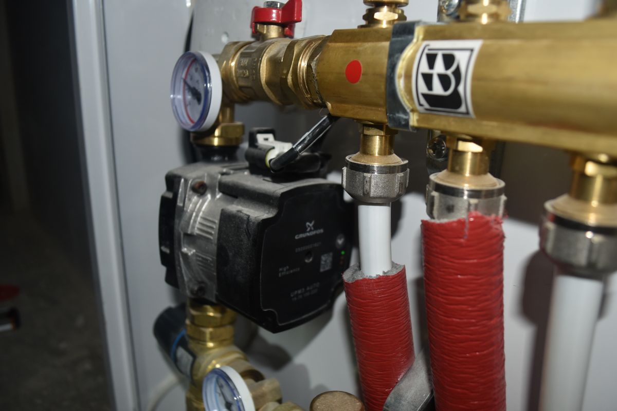

  • #23 18412310
    piciak17
    Dual-function ovens, e.g. Termet ecocondens, reduced temperature setting Dual-function ovens, e.g. Termet ecocondens, reduced temperature setting
    I have two identical manifolds with a pump and a mixer (ground floor and first floor). In the future, I plan to control some circuits on the distributor.
    I don't know how the supply and return are divided into two distributors.
    Or maybe it's best to modify these distributors and bake with your own pump? After all, 100 m is not much and the developer went crazy here
    Thanks in advance for your suggestions

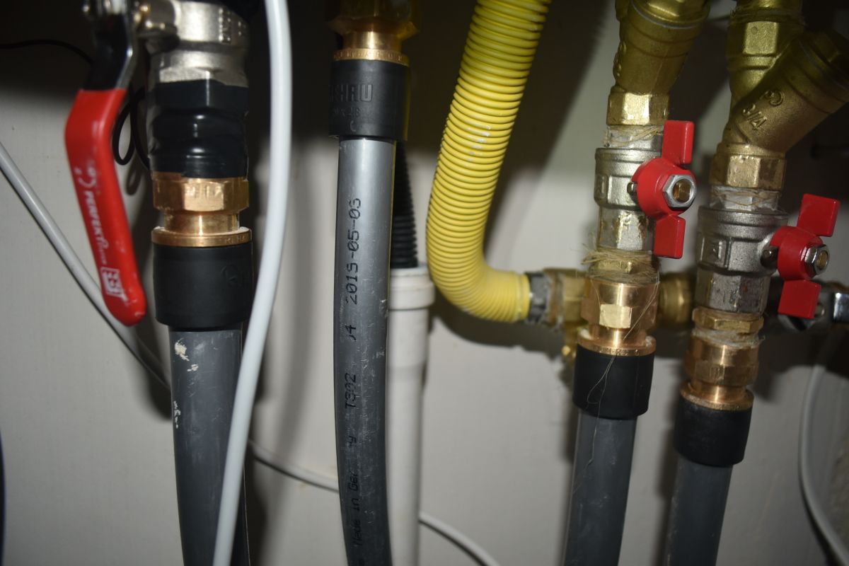

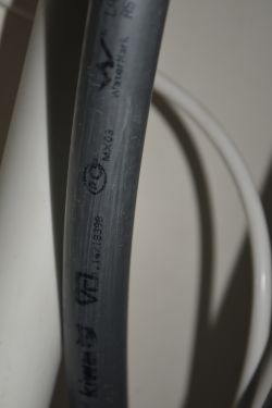

  • #24 18413151
    Wojtermet25
    Level 30  
    Posts: 1061
    Help: 155
    Rate: 228
    Take an even clearer photo of the installation near the boiler and measure the diameter of the pipes from the boiler to the distribution point and at the distributors themselves and write what kind of pipes they are (material: copper, Pex, pp).
    The solution you write about would be the best. And additional control of individual circuits is, for me, a triumph of form over substance.

    piciak17 wrote:
    After all, 100 m is not enough
    In theory, the pump built into the boiler should do the trick.
    But the devil is in the details, so should doesn't mean it always has to.
    Since it's a new building, I assume that you will need about 5kW for frosts of -20, so on average during the season you will need about 2.5kW, and Termet has a minimum power of 3.0kW.
    How do you see the control of individual circuits in such a system if the boiler is clocked?
  • #26 18428833
    piciak17
    I'm doing myself a disservice by answering only now...
    I forgot to measure the diameter...
    Water from waterworks is smaller in diameter, and central heating pipes are larger in diameter.
    I'm completely green on this topic and I'm seeing more and more :(
    Dual-function ovens, e.g. Termet ecocondens, reduced temperature setting Dual-function ovens, e.g. Termet ecocondens, reduced temperature setting Dual-function ovens, e.g. Termet ecocondens, reduced temperature setting Dual-function ovens, e.g. Termet ecocondens, reduced temperature setting Dual-function ovens, e.g. Termet ecocondens, reduced temperature setting Dual-function ovens, e.g. Termet ecocondens, reduced temperature setting Dual-function ovens, e.g. Termet ecocondens, reduced temperature setting Dual-function ovens, e.g. Termet ecocondens, reduced temperature setting
    Separated into two dividers, it is probably an ordinary tee...

    Wojtermet25
    Level 30  
    Posts: 1061
    Help: 155
    Rate: 228
    Are you able to locate this separation into individual manifolds, or is it available in the boiler room?
    Unfortunately, I cannot read the diameter of the pipes from the photos, maybe take another photo to see the description of the pipe type and diameter.
    If it were my installation, I would take the risk and throw away the entire mixing groups and connect the distributors directly to the boiler.
