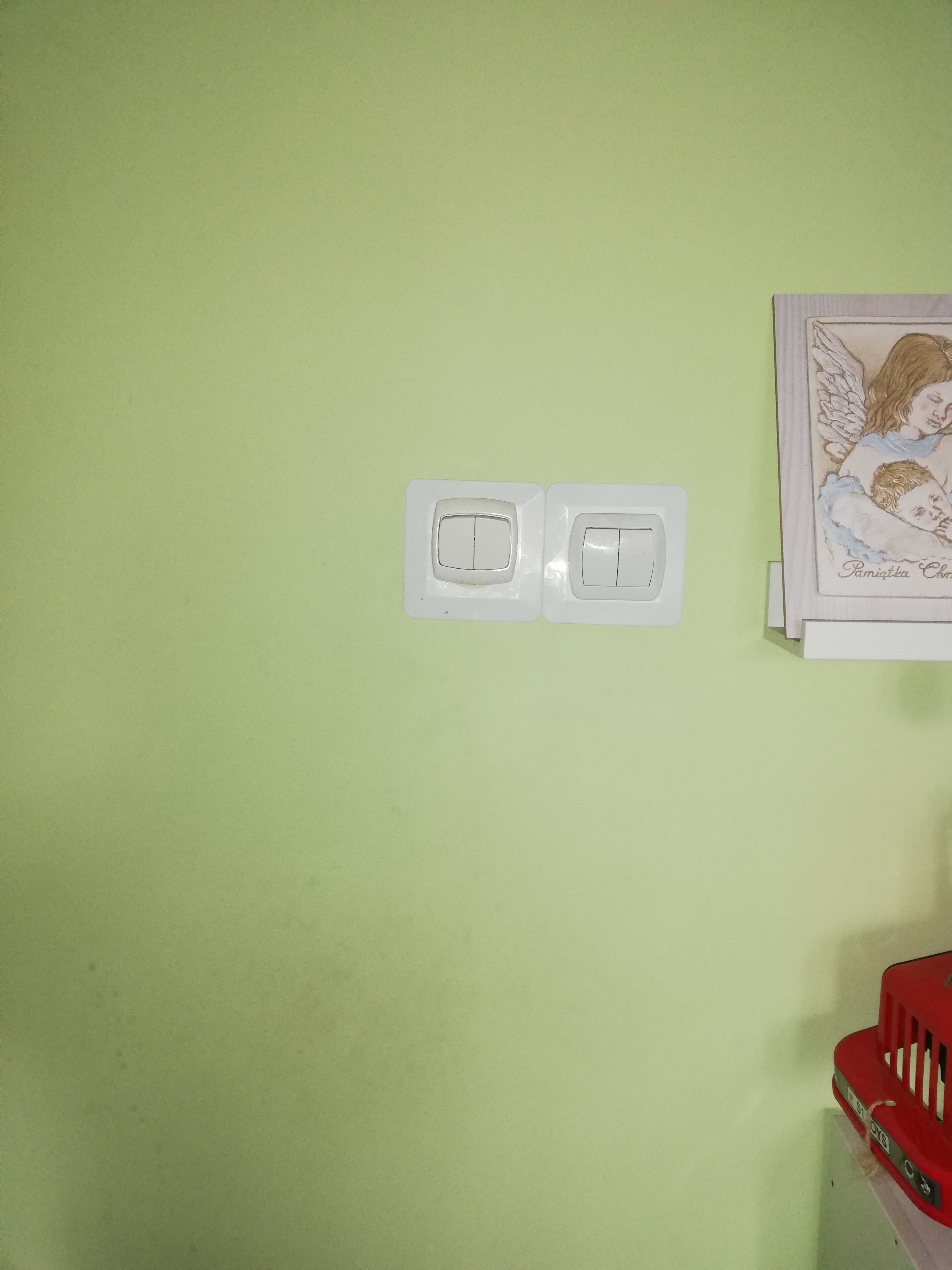

    For some time now I have been looking for a solution to move the light switches without breaking or pulling the wires.
    I`ve heard about controllers that control the lights via Wi-Fi, Bluetooth or radio, but I can`t find it. Can anyone help and advise how to do it? Thank you in advance !
    Currently there are switches:

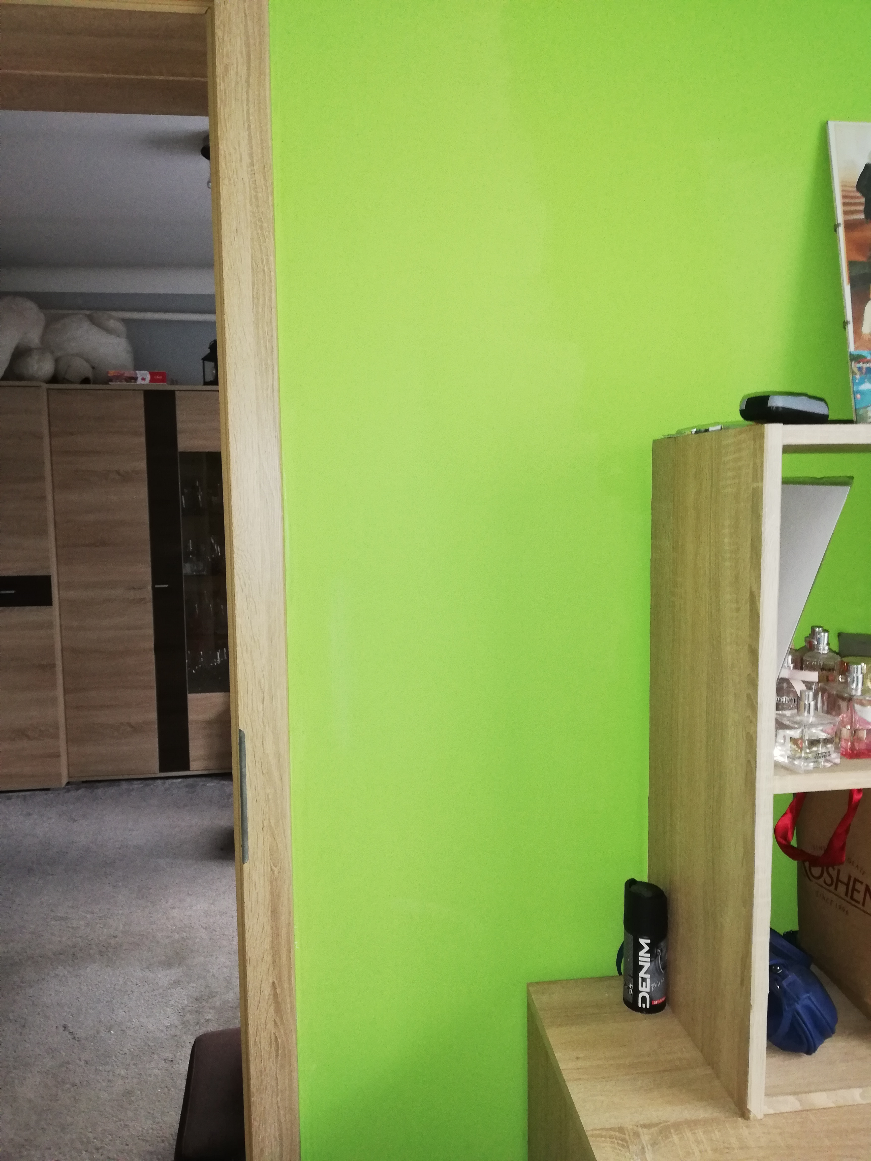

    I would like them to be:

    It doesn`t look all that rosy. There you need a neutral wire - "0", which is not included in the switch boxes.
