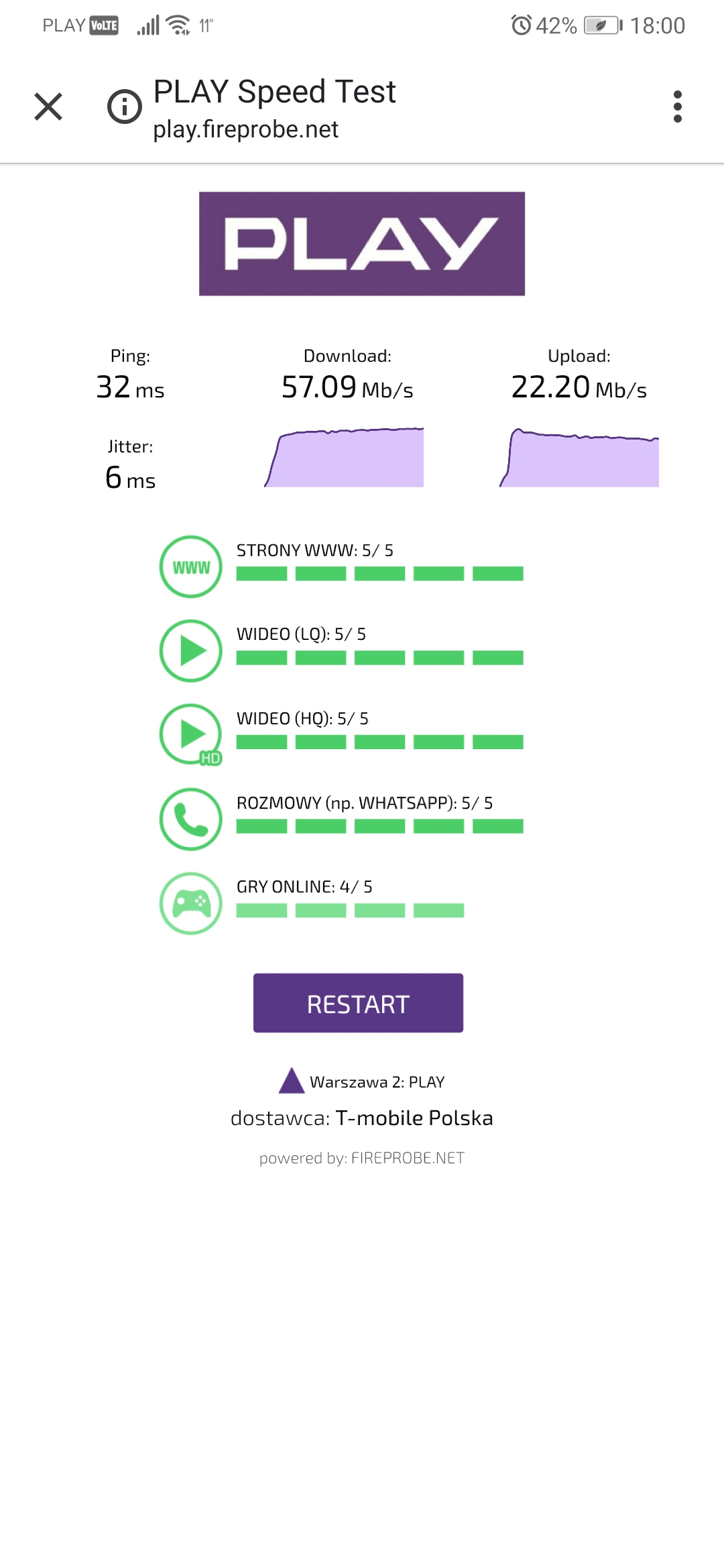

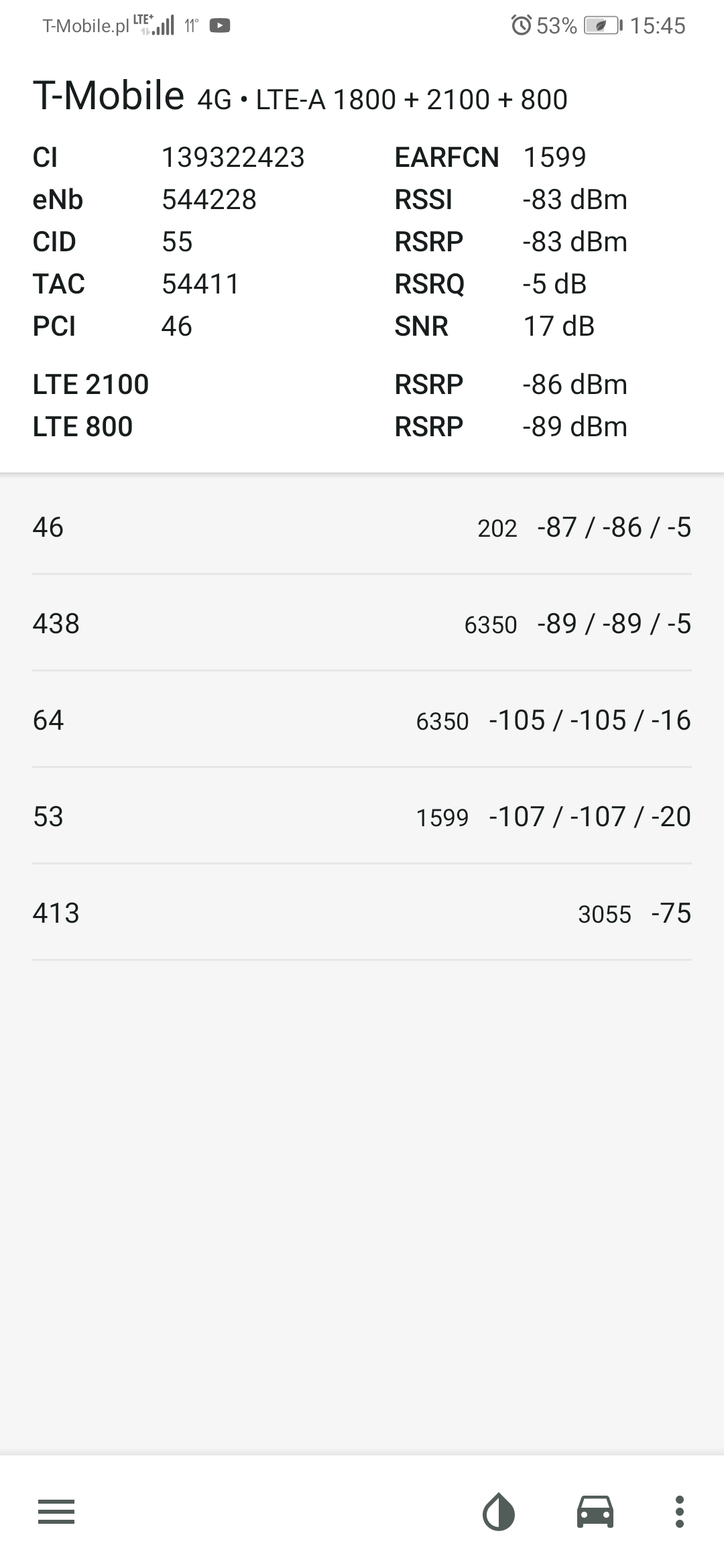

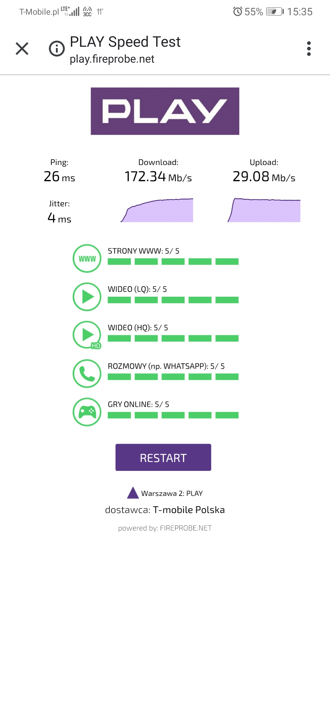

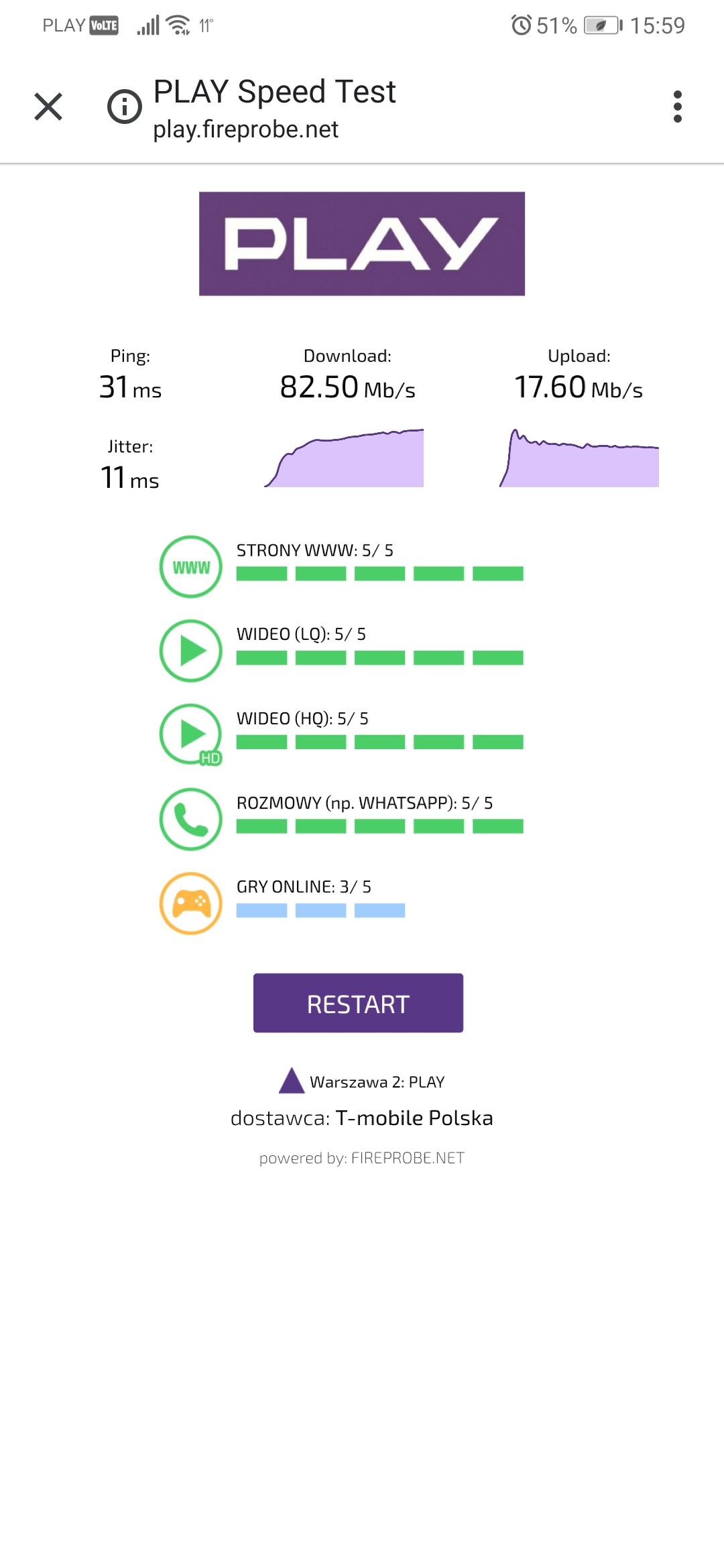

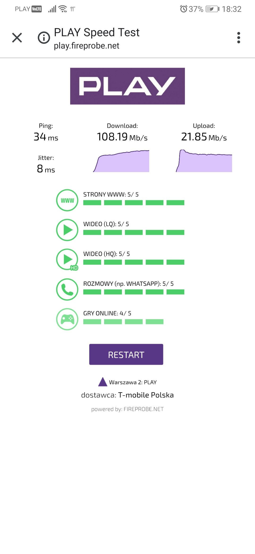

    Hello. I took mobile internet from T-Mobile and I have a little speed problem. I did the measurement earlier with the Huawei p30. and I had 110Mbps - 140Mbps and when I took promotions for companies, i.e. a zero limits package and I got a router and a card, and I did the measurement on the router in the same place as I did before, And surprisingly on the 60Mbps - 100Mbps router and something poorly tested on the router router Huawei B535 4G pro. So I did a test on the phone and it came out better 120Mbps - 150Mbps so what antenna should I buy in your opinion, is the router's fault? On the phone I get VoLTE like something I do not know if it is important.
    In the area, I have 2 BTS, the closest is in Olsztynek, about 1 km, not all, and the second one on Sudwa much further, about 5 km-8, I don't know from which I get the signal, but probably from what is in Olsztynek, from what I read from http: // beta. btsearch.pl and both show that they work in the 800 band, as I read correctly.
    Added after 51 [minutes]:
    I am wondering about this antenna https://allegro.pl/oferta/antena-dual-tajfun-ii-15met-3g-4g-lte-46dbi-huawei-7535744056?.
  • Need NetMonster and speedtest screenshots

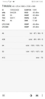

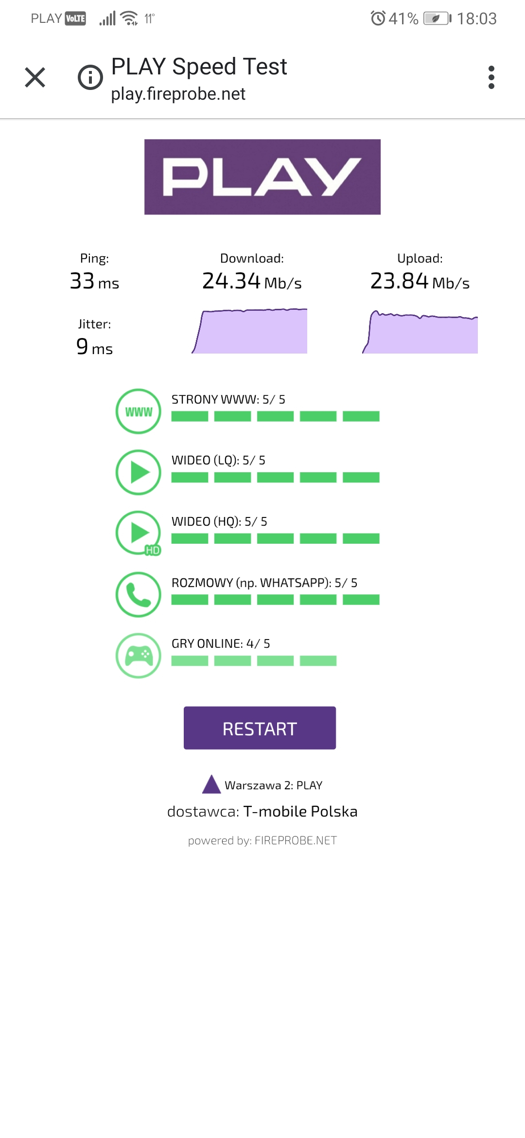

    Screenshots from the card in the phone.

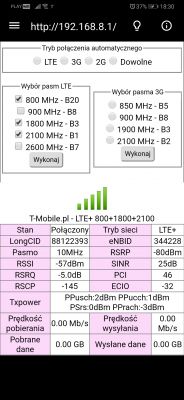

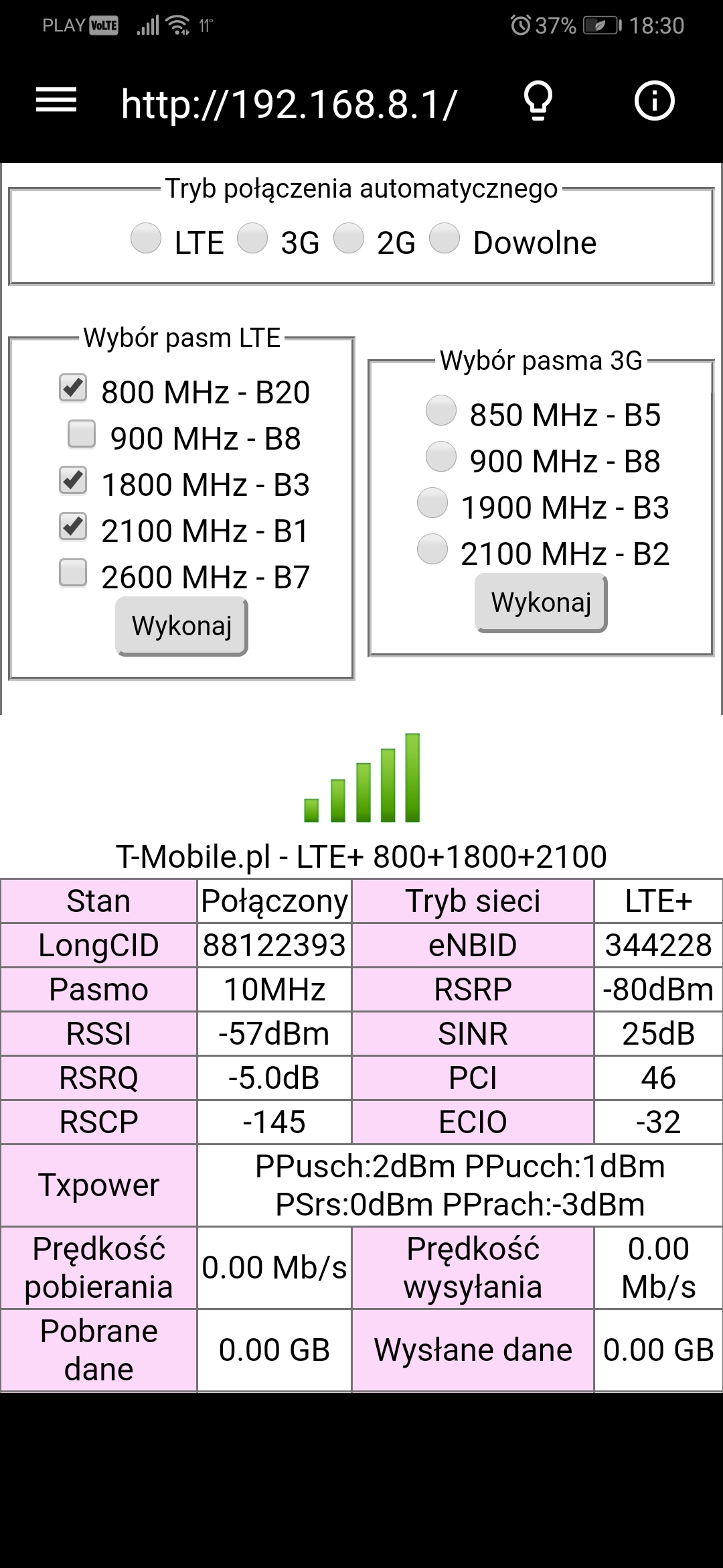

    Huawei B535 - Antenna selection

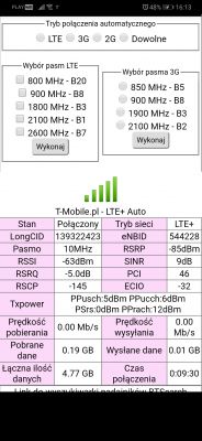

    Router screen. I tried to change the pazmo through this HManager application but there was no result, it always has 70 Mbps - 80
    Huawei B535 - Antenna selection Huawei B535 - Antenna selection Huawei B535 - Antenna selection
  • B525 lacks 3CC CA and QAM256 support

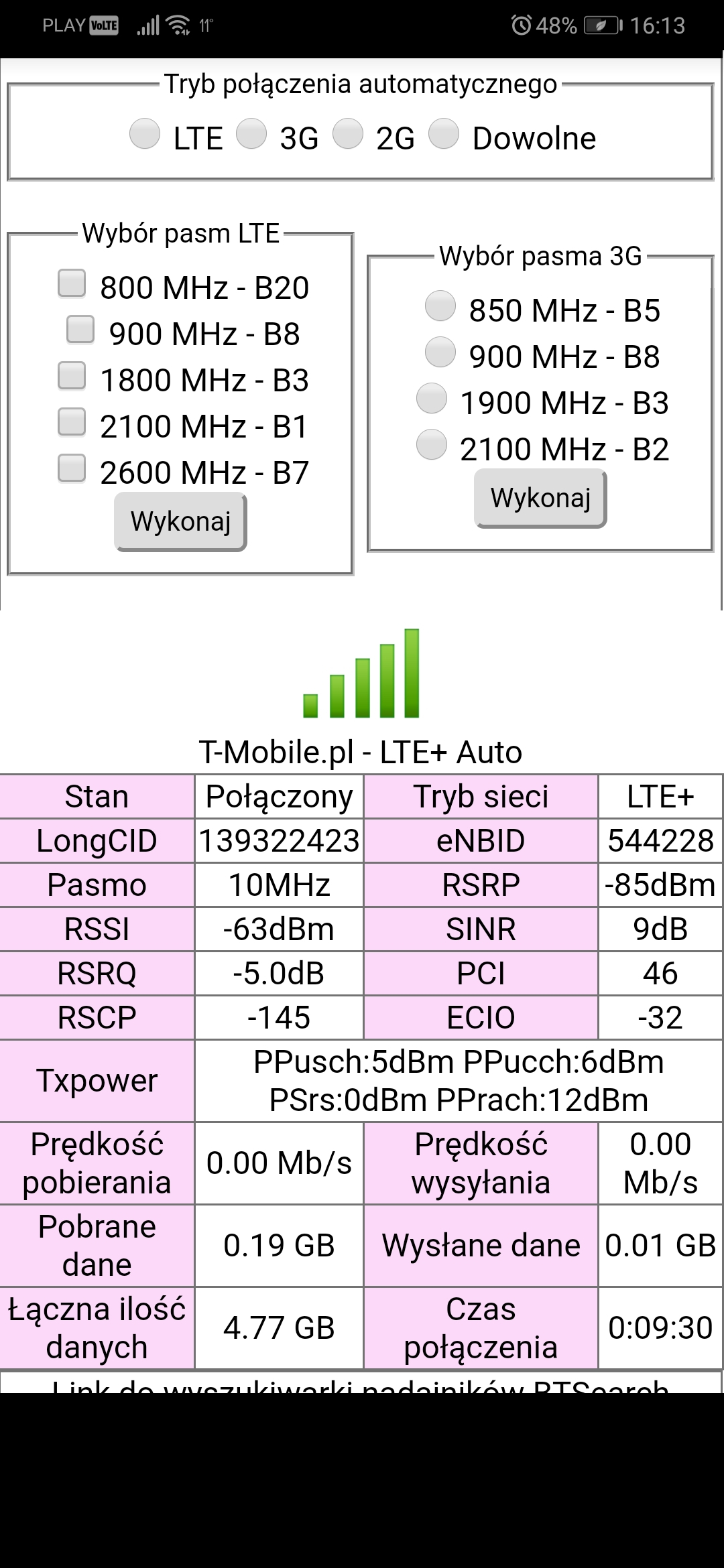

    Unfortunately, you didn't do what I asked for. The screen from AUTO on B535 shows T-Mobile LTE1800 aggregation as the baseband, but it is not known whether aggregation with LTE2100 or LTE800. There is no LTE2600 on the BTS, the phone connects in the aggregation of 3 CC CA LTE1800 + 2100 + 800, i.e. it uses a 30MHz band, probably DL with QAM256 on LTE1800, UL with QAM64. B525 does not support 3 CC CA and QAM256 on DL, QAM64 on UL. Signal parameters on 1800/2100 / 800MHz on the phone good, on B525 the signal on LTE1800 correct.
  • Measured LTE800, 1800 and 2100 signal levels on B535

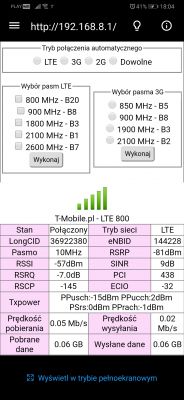

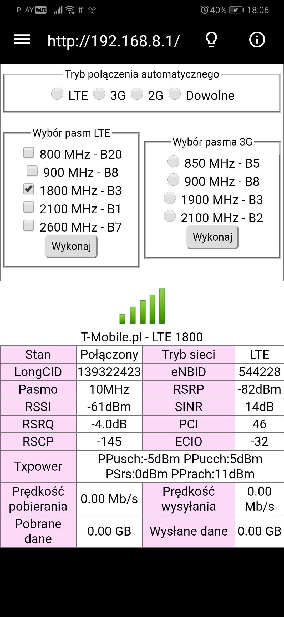

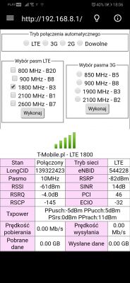

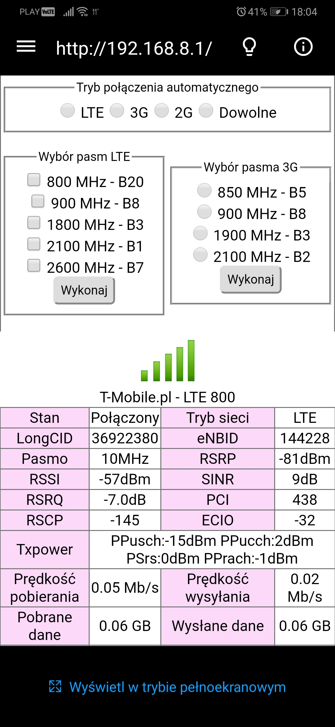

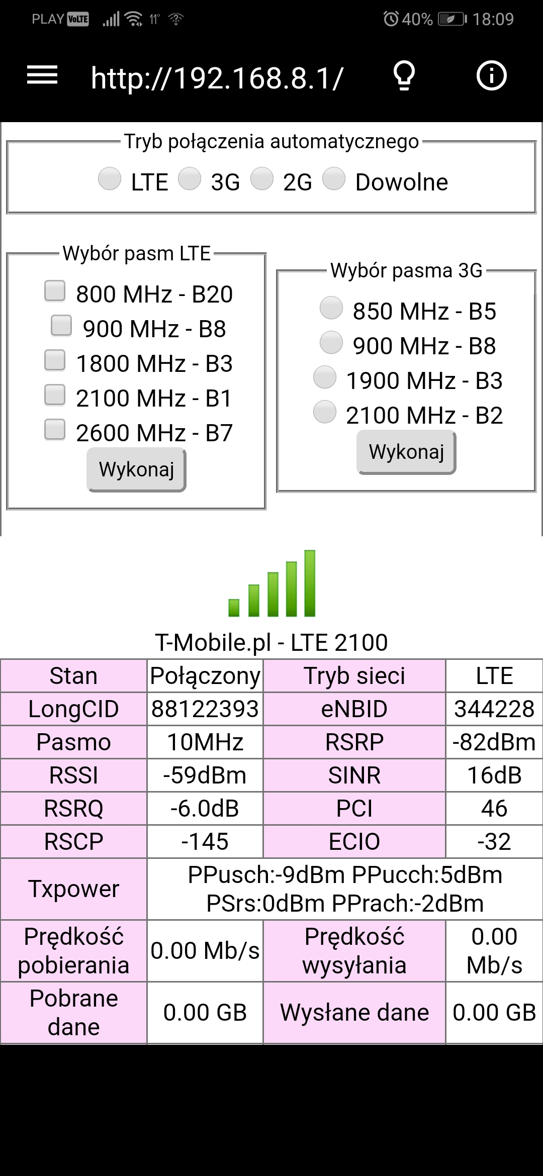

    I don't know if that is it. But I was able to measure the LTE800, 1800 and 2100 bands. And as for the router, I have the Huawei B535 and not as you write B525, unless it is something else.
    LTE800 band
    LTE1800
    LTE 2100

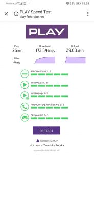

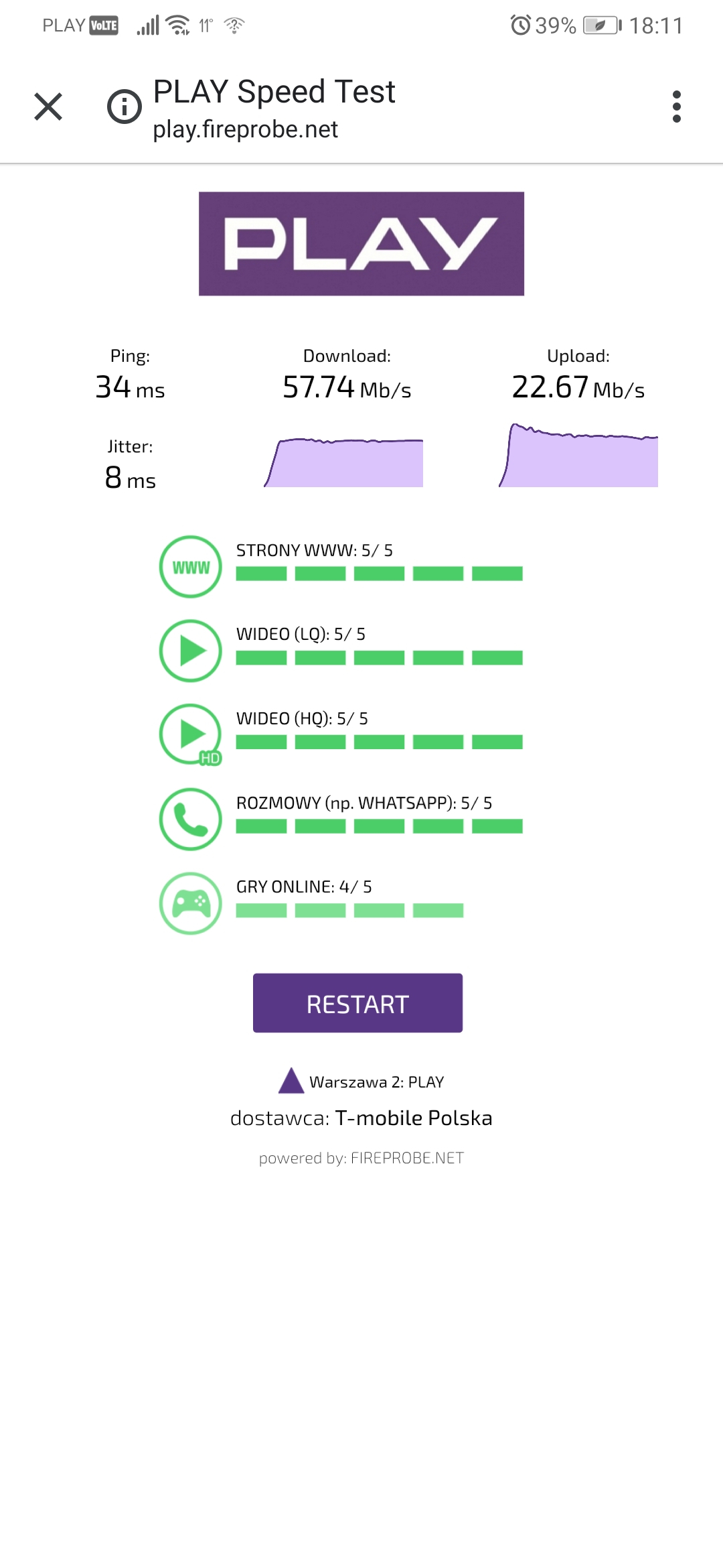

    And what's going on with these speeds, what do you have to do to have a similar speed to buy an antenna or it won't help. I can still check almost what speeds will be on the router next to the antenna, because the family lives in front of this antenna about 100m.
    Added after 12 [minutes]:
    I did something like that and the result was better, but not the same as on the phone.
    LTE2100 + LTE1800 is the optimal two-band CA choice

    You still haven't done what I asked for, on the individual bands LTE1800 / LTE2100 and LTE800 results and tests OK. But no LTE2100 + 1800, LTE2100 + 800 and LTE1800 + 800 tests. Do not choose three bands because it does not aggregate them anyway. In the latter case, LTE2100 + 1800 aggregation is probably activated and a very good result, so it is the optimal choice of two bands as the LTE2100 baseband. The signal on LTE2100 and LTE1800 is correct. No antenna needed. In theory, on 2 CC CA B1 + B3 DL up to 150Mb / s. It will never match the phone because it aggregates 3 LTE2100 + 1800 + 800 bands and DL up to 225Mb / s and QAM 256 on DL LTE2100 raises even 250Mb / s. Higher speeds are achievable on a router with 3 CC CA.

    So my router doesn't support aggregation of more than 2 bands. I looked at everyone as you said and the speeds are similar, whether it is the 800 + 1800, 2100 + 800 2100 + 1800 band, and the speeds are the same, i.e. 90mbps - 120mbps so jumps. So if I would buy a router with support for over 2 bands, I would have a better download as to what router would you recommend, I would prefer it to have 4-band support, because in the future they may add the 2600 band, I would have 4 cc if I could do something like that.
