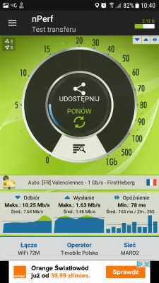

    I warmly welcome

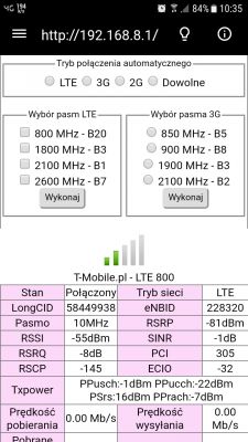

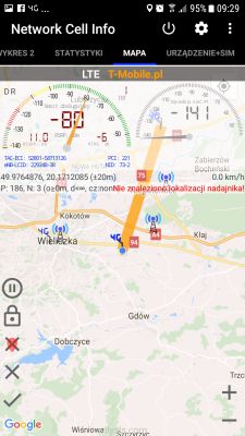

    Please help in choosing the antenna for the router.
    The minimum speeds - in the period of the loaded network it is Up3Mb / DL 5, in unloaded UP11 / DL15.
    Data in the house on the ground floor: Choosing the Best ANTENA LTE for Huawei B525 Router - T-Mobile Network, Speeds & MIMO 800-2170MHz Choosing the Best ANTENA LTE for Huawei B525 Router - T-Mobile Network, Speeds & MIMO 800-2170MHz
    If more data is needed, please let me know.
    I keep an eye on this antenna for a good price, and I wonder if it will work: http://www.dipol.com.pl/antena_atk-log_lte_10...zewodu_wtyk_sma_mimo_800-2170mhz_A7056_10.htm
    If not what you recommend?
    For tests in T-mobile - only 7 days left
    Best wishes and thanks for quick replies.
  • #2 16951742
    Antenak
    Posts: 117
    Help: 12
    Rate: 24
    How far to this neighboring btsa because the program shows that it transmits with more power, we will aim at it

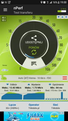

  • #3 16951768
    robcook
    Posts: 227
    Rate: 31

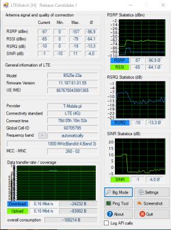

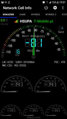

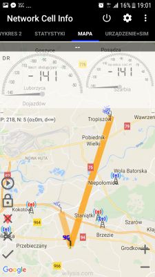

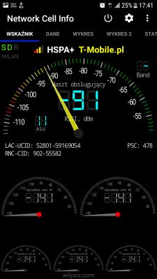

    Those were yesterday, This one is from today:
    Choosing the Best ANTENA LTE for Huawei B525 Router - T-Mobile Network, Speeds & MIMO 800-2170MHz Choosing the Best ANTENA LTE for Huawei B525 Router - T-Mobile Network, Speeds & MIMO 800-2170MHz Choosing the Best ANTENA LTE for Huawei B525 Router - T-Mobile Network, Speeds & MIMO 800-2170MHz
    The nearest one will be about 4.5 km
  • #4 16951773
    Antenak
    Posts: 117
    Help: 12
    Rate: 24
    It should be good

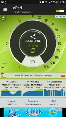

  • #5 16951786
    robcook
    Posts: 227
    Rate: 31

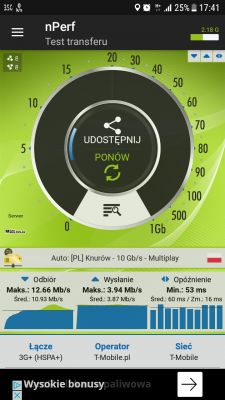

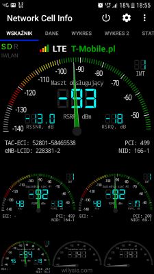

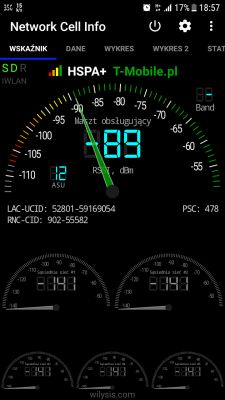

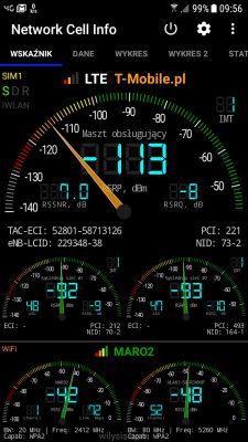

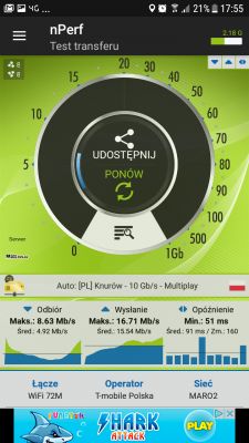

    I have done the measurement again for certainty: UP16 / DL2, sometimes DL I have twice the value of UP.
    Please, confirm - thank you.
    Which program will change the transmitter in this router, with the laptop or cell turned off?
    greetings
  • #6 16951817
    matek451
    Posts: 31251
    Help: 4352
    Rate: 5808
    But these are measurements on the phone with NCI, in addition, some strange because RSRP different on the screens. To manage bandwidth on B525, please use http://www.mediafire.com/file/99t05l2dv6vany8/Huawei_Manager_1.1_PL.apk Android phone application, where you log in to B525 at 192.168.8.1. of course, the phone is connected to WiFi with B525. What is the location? You check the LTE1800, LTE800 and LTE2600 bands sequentially. You show screenshots for every speedtest.

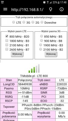

  • #7 16951905
    robcook
    Posts: 227
    Rate: 31

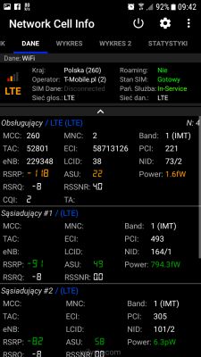

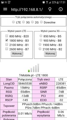

    LTE800
    LTE 1800
    Other Offline

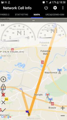

    The location on screens higher - Bodzanów / Zabłocie - Małopolskie
  • #8 16952550
    matek451
    Posts: 31251
    Help: 4352
    Rate: 5808
    LTE800, connection to BTS LTE800 T-Mobile in Staniątki, good signal, low SINR and BTS speeds rather heavily loaded. LTE1800 is BTS Szkolna 1 Niepołomnice, weak signal. speed and so good. Force LTE1800 + 800 at the same time.

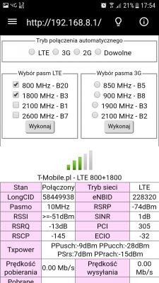

    lte 1800+800

    Whether thanks to this antenna: http://www.dipol.com.pl/antena_atk-log_lte_10...zewodu_wtyk_sma_mimo_800-2170mhz_A7056_10.htm i
    BTS in Staniątki (about 4.5km) performance should increase? Dates look like loaded ...
    Or maybe it's better to aim at BTS Niepołomice - about 10km? Only then a different antenna?
    Thank you for your help and best regards

    BTS LTE800 at Staniątki is rather overloaded. For confirmation, make an evening speedtest under it in your direction using LTE phone with the Network Cell info application. Speedtest with optimal signal and DL / UL best illustrate whether the external antenna and signal improvement will help improve speed. In LTE1800 + 800 aggregation, connection with BTS Szarów is the nearest BTS with these two bands. Same in Łysokanie.

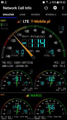

  • #12 16955329
    robcook
    Posts: 227
    Rate: 31

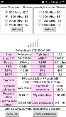

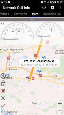

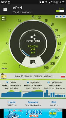

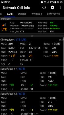

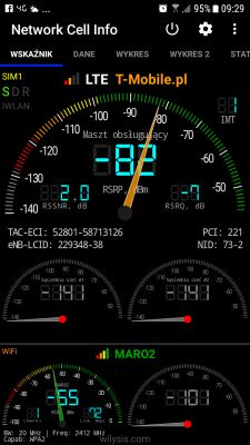

    Once more tests - all outside
    LTE cell
    Choosing the Best ANTENA LTE for Huawei B525 Router - T-Mobile Network, Speeds & MIMO 800-2170MHz Choosing the Best ANTENA LTE for Huawei B525 Router - T-Mobile Network, Speeds & MIMO 800-2170MHz Choosing the Best ANTENA LTE for Huawei B525 Router - T-Mobile Network, Speeds & MIMO 800-2170MHz Choosing the Best ANTENA LTE for Huawei B525 Router - T-Mobile Network, Speeds & MIMO 800-2170MHz Choosing the Best ANTENA LTE for Huawei B525 Router - T-Mobile Network, Speeds & MIMO 800-2170MHz
    LTE 800
    LTE 1800
    LTE 800 + 1800
    What do you think I should do? Another antenna than I gave above, and if so, which one? give up antennas? Another operator?
    Generally, I do not expect miracles of 10Mb UP to give me enough.
    Thanks for the info
    Thanks in advance
    #13 16955383
    matek451
    Posts: 31251
    Help: 4352
    Rate: 5808

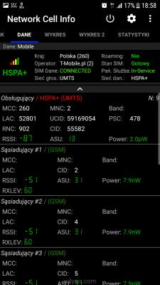

    3G phone with UMTS2100HSPA + DC with BTS-Stanzeki, weak signal, good speed. LTE800 with Nords, very good signal DL

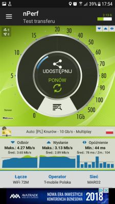

  • #14 16955448
    robcook
    Posts: 227
    Rate: 31

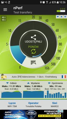

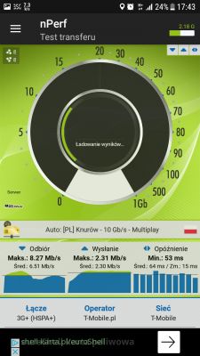

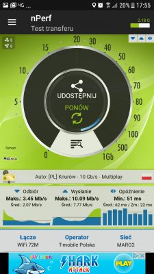

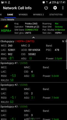

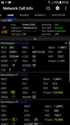

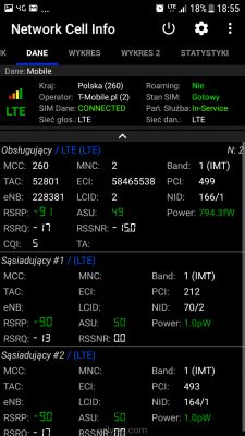

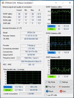

    One more test from TELEPHONE from another window
    Choosing the Best ANTENA LTE for Huawei B525 Router - T-Mobile Network, Speeds & MIMO 800-2170MHz Choosing the Best ANTENA LTE for Huawei B525 Router - T-Mobile Network, Speeds & MIMO 800-2170MHz Choosing the Best ANTENA LTE for Huawei B525 Router - T-Mobile Network, Speeds & MIMO 800-2170MHz Choosing the Best ANTENA LTE for Huawei B525 Router - T-Mobile Network, Speeds & MIMO 800-2170MHz Choosing the Best ANTENA LTE for Huawei B525 Router - T-Mobile Network, Speeds & MIMO 800-2170MHz Choosing the Best ANTENA LTE for Huawei B525 Router - T-Mobile Network, Speeds & MIMO 800-2170MHz Choosing the Best ANTENA LTE for Huawei B525 Router - T-Mobile Network, Speeds & MIMO 800-2170MHz Choosing the Best ANTENA LTE for Huawei B525 Router - T-Mobile Network, Speeds & MIMO 800-2170MHz Choosing the Best ANTENA LTE for Huawei B525 Router - T-Mobile Network, Speeds & MIMO 800-2170MHz Choosing the Best ANTENA LTE for Huawei B525 Router - T-Mobile Network, Speeds & MIMO 800-2170MHz
    If I understood you well - you are offering tests on the air ... could he have been suggesting something to me?
    greetings
  • #15 16955605
    makosuu
    Posts: 2984
    Help: 369
    Rate: 370
    LTE 800 from BTS-a Szarów Journal No. 605/2, hopeless SINR and RSRQ indicates overload. No Speedtest.

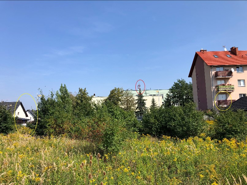

    I am digging up the topic, if the query is in the wrong topic, please move fashion.

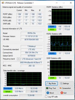

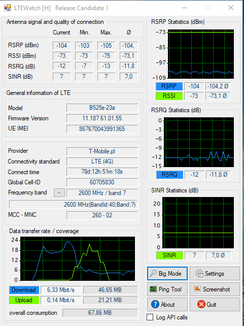

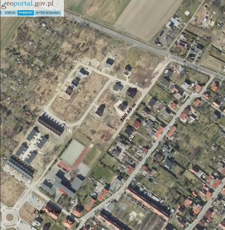

    Router of course H B525
    My location is difficult due to the fact that the nearest BTS is covering my school in front of my block.
    Despite the short distance (about 500m) to the BTS, it effectively breaks my signal and sometimes causes switching to other BTSs in the city to which I have even more obstructed access.
    The BTS antenna cannot be seen from the balcony despite the fact that it can be seen from the parking lot:>
    And now the question - will the directional antenna work from such a distance using the reflection from buildings within range?
    I would put it on a mast from the balcony going beyond the edge of the building and looking for a signal from the school to the left - after reflection from the buildings marked in yellow.
    It makes sense? And if so, what antenna?
    Below are data from LTEWatch as well as maps and photos showing the location problem.
    PS
    It is not possible to put a mast on the roof, the apartment is temporarily rented for 2 years.
    PS2
    Sometimes I catch a signal from other BTS from the city but in any case I have to buy an antenna and "search" for a signal.

    And what are your DL / UL speeds in the evenings from this BTS to LTE1800Networks? Also force LTE2600 on B525 and check this band and show results.
  • #18 18146038
    grigor1
    Posts: 120
    Help: 9
    How to force 2600? He has no idea how to do it.

    Update.

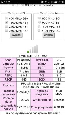

    So it's like this, the speed test on a computer's website coincides with what the iOS app shows on your phone.
    I just don't know what it connects to in the 2600 band because I can't find this ID number in this BTS or in any BTS in the area.
    1800 band
    2600 band

    On LTE2600 it is the same BTS, signal is weak but good speed. In Hmanager, you can force LTE2600 + 1800 or LTE2600 + 800 on the B525 and check how these LTE band aggregations work.
