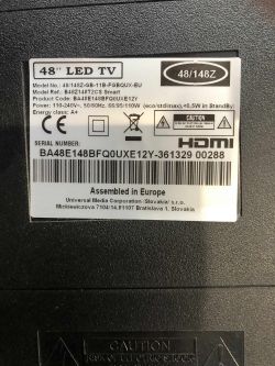

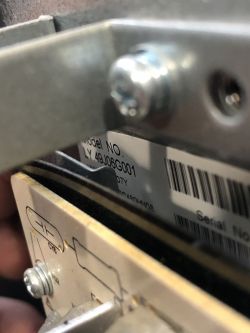

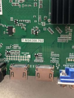

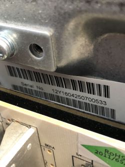

    Hello everyone.
    This is our first post here. Nice to meet you all in this community.
    We are an electronics repair shop located in Greece.
    We have a case with a Blaupunkt TV in which we need to flash the memory "U3" (as seen in one of the pictures) with a fresh copy of firmware (BIN file) in order to repair it.
    The model number is: 48/148Z-GB-11B-FGBQUX-EU
    Does anyone have this BIN file available please ?
    Thank you in advance for your time.
    Have a nice day.
    PS: I attached some images below that give more details about the TV:
    Blaupunkt 48/148Z-GB-11B-FGBQUX-EU TV Firmware: Seeking BIN File for Flash Memory U3 Blaupunkt 48/148Z-GB-11B-FGBQUX-EU TV Firmware: Seeking BIN File for Flash Memory U3 Blaupunkt 48/148Z-GB-11B-FGBQUX-EU TV Firmware: Seeking BIN File for Flash Memory U3 Blaupunkt 48/148Z-GB-11B-FGBQUX-EU TV Firmware: Seeking BIN File for Flash Memory U3 Blaupunkt 48/148Z-GB-11B-FGBQUX-EU TV Firmware: Seeking BIN File for Flash Memory U3

    what's the fault?
    stuck in standby? stuck on logo?
  • #4 18328715
    gelectrolab
    billobirillo wrote:
    what's the fault?
    it is stuck in standby.
    USB update procedure using allupgrade_6308rtbm.bin

    Hello friend,
    thank you very much for your time and for the file you sent me. I appreciate it.
    It worked fine. The only problem is that on the first boot it has sound/picture and no backlight, but when I put it on standby and then back on it works. This is with fast boot on. With no fast boot, I have this problem again. So to sum up, on first boot backlight does not open.

    The file that was provided with the help of billobirillo was correct. In addition we had to replace the U3 chip with a new one and program it again.
    Also the contact information that was provided from aquario_blue member was at the right direction (we were redirected to the Greek support though, but still they provided us with the same file as billobirillo did)
    Thanks everyone for the help.
