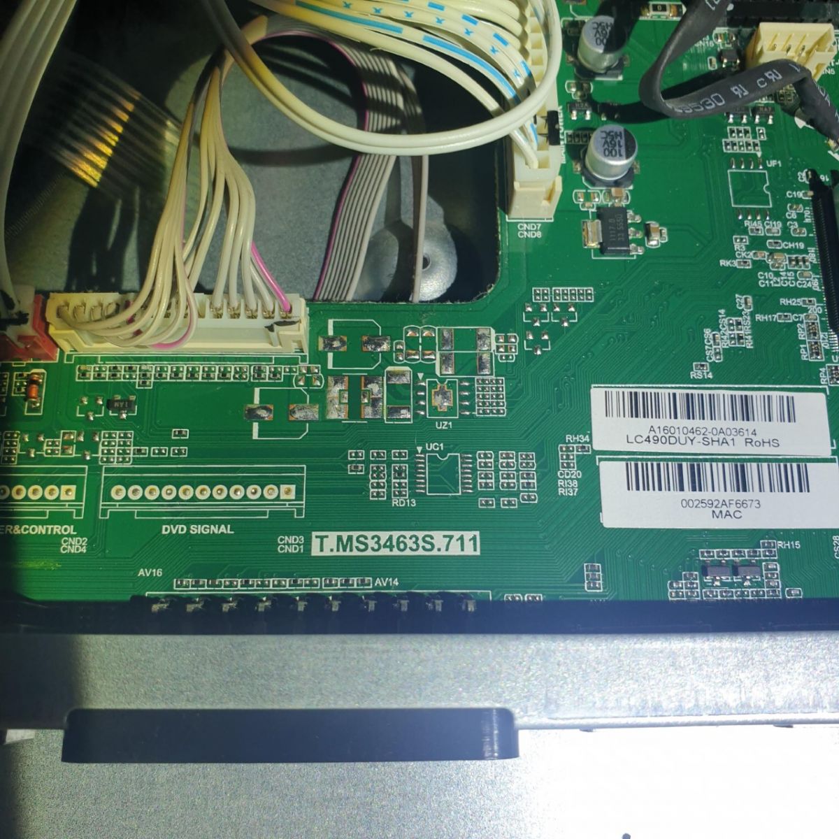

    I have a
    Blaupunkt BS49E148BFJ0U0K10M
    T.MS3463S.771 main board
    LC490DUY-SHA1 Screen
    PCB:MIP550D-240V350 power board (Megmeet.com)
    I think I have a firmware issue, the TV comes on and displays the Blaupunkt splash screen, then after around 40 secounds it goes off and then comes back on to display the same again. The picture is good and back lights strong.
    I cannot find the firmware to reinstall and see what happens.
    Can anyone help?

  • Main board likely causing splash screen reboot loop
    #5 19575304
    mechsteve
    Level 4  
    Posts: 6
    Hi, thanks for the link, they sent me a file and I installed it but it has made no difference.
    TV turns on and shows the splash screen with the Blaupunkt logo, after about 40 seconds it goes blank and the standby light comes on, then it comes on again with the splash screen.
    The remote is working but the TV is unresponsive to it.
    Anyone got any ideas where I can start with this?
    Probably a main board issue but is there any other possible solutions?
    There are also no sounds at any point of any kind of relay click!
    Thanks mechsteve

  • USB firmware update had no effect
    #7 19577062
    mechsteve
    Level 4  
    Posts: 6
    HI, I copied the bin file they sent me onto a freshly formatted thumbdrive (fat32). Unplugged the tv, put the thumbdrive in the usb socket and then turned it on. After a few seconds the thumbdrive started to flash steady, like it was being read. After around 4 minutes it stopped flashing. I tried the remote but nothing. I turned it off at the switch and removed the drive. Turned it back on and found no change.

  • #10 19579776
    querij
    Level 21  
    Posts: 375
    Help: 42
    Rate: 228
    If you don't recover the software, you probably have a damaged flash or microprocessor.

  • External programmer recommended over USB update
    #15 19610270
    janomo
    Posts: 1513
    Help: 45
    Rate: 247
    mechsteve wrote:
    i copied the bin file they sent me to a freshly formatted flash drive (fat32). I unplugged the TV, put the pendrive in the USB socket,
    It is best to program a new memory in an external programmer with the received file. Attempting to update the software with a pendrive may fail, especially if the memory on the TV is damaged.
    Alternatively, contact your colleague: e-mail from Sucha Beskidej - he is the best "in these blocks".
