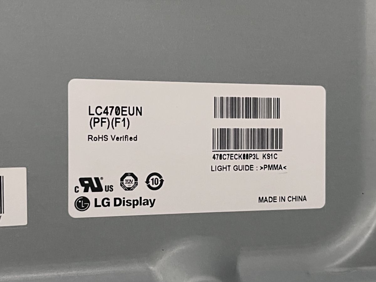

    BLAUPUNKT B47A333TC
    main T.MSD309.B81C 12176
    panel LC470EUN(PF)(F1)
    spiflash UF11 25Q32
    • UF11.zip (3.15 MB) You must be logged in to download this attachment.
  • #4 21136610
    Bury_Electronics
    >>21136432
    Fantastic thank you billobirollo :-)
    I have never done this before and am waiting for a 25Q32 to arrive in the post. I will let you know how I get on!
    Best Craig
