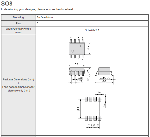

    As in the subject
    What is the difference between these enclosures?
    Do they look similar
    Are they interchangeable in both directions?
    Greetings

    Compare the dimensions of the enclosures.

    I just compared them, and the differences are about 0.1mm.
    • Comparing SO8 and SOIC8 Enclosures: Similarities, Differences, and Interchangeability so8.png (24.56 KB) You must be logged in to download this attachment.
    • Comparing SO8 and SOIC8 Enclosures: Similarities, Differences, and Interchangeability soic8.png (26.87 KB) You must be logged in to download this attachment.

    SO8 - small outline 8 pin
    SOIC8 - small outline IC 8 pin

    So , if I am doing a PCB design can I use an SO8 chassis, for an IC what has SOIC8?
    Will it fit?

    eurotips wrote:
    for production and so under a specific IC you create a pcb.
    especially how to "assemble" it Pick and Place machine.
    Marek_Gorecki wrote:
    If I'm doing a PCB design can I use an SO8 chassis, for an IC what has SOIC8?
    Make yourself a 1:1 scale PCB printout and try it on.
