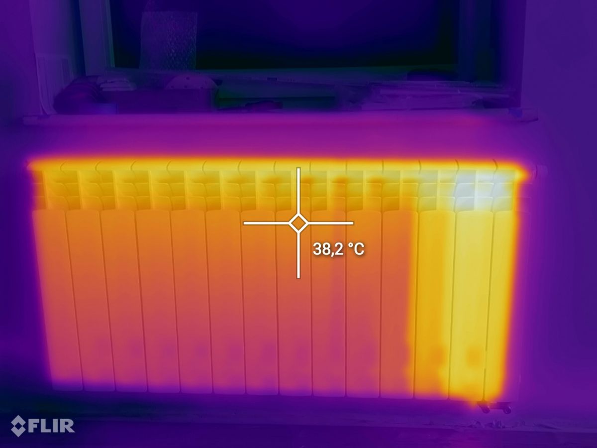

    First 2 Radiator Fins Heating Up Only: Venting, Water Flow, Block Apartment 4th Floor
    I also have this problem, I bought 2 aluminum radiators (previously they were panel) and both heat as in the picture - the circulation pump is on the 3rd gear and it does not change anything.
    What could be the cause?
    Radiator with bottom connection, maybe reverse connection?

    Maybe it is connected incorrectly (was this heater factory designed for such a connection). In general, these bottom connections are not the best - they often cause a decrease in the efficiency of the radiator. It may also have air in it (the bottom connection means that when there is air in the system and it enters the radiator, it has no way to get out, even if the pump stops and you have to manually remove it with the air vent). I do not exclude the reverse connection (there are such crosses that will help to change the connections).
