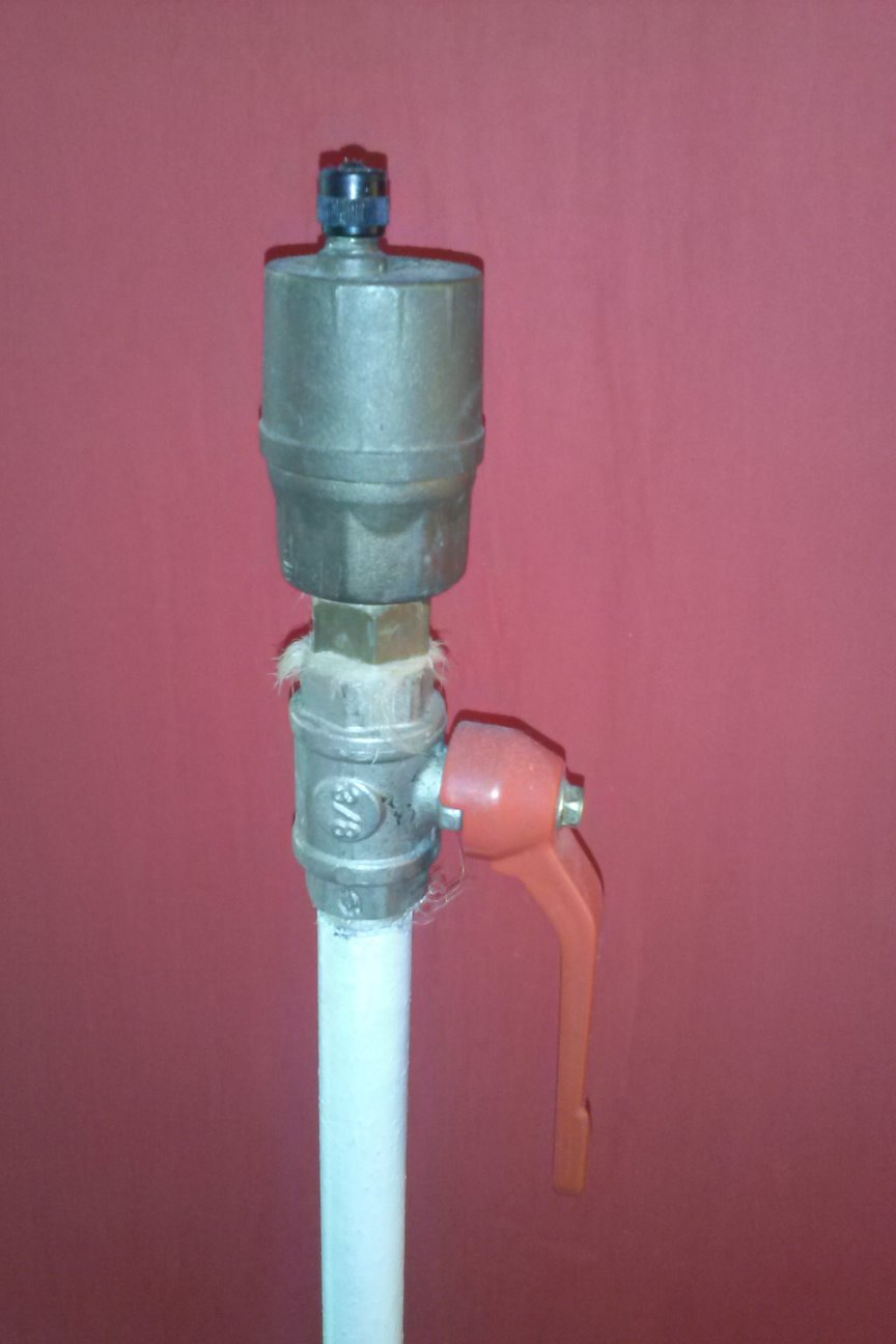

    This is what it looks like (photo attached). under this hood there is a thread and there is something inside
  • #9 11646082
    Grubixcin7
    Posts: 8
    Rate: 15
    This is what it looks like (photo attached). under this cap there is a thread and there is something plastic inside that I can't push in or anything. After opening the valve slightly, some liquid leaked out. That tube that leads to that valve at the top is warm.

    Hmm, it looks like an automatic air vent to me and in your case it should be enough just to open this valve below and if there is no slight hiss and the radiator still does not heat, it would mean that the vent is clogged

    This valve turns only a little in each direction and does not hiss, do not feel the escaping air.

    This vent (automatic) is probably clogged or damaged. In general, radiators most often get air on the top floor of the building.

    And how can i deal with it...??

    Unscrew it completely and leave only the valve below, then slowly open the valve that is left. In order not to get splashed and burn yourself, put a folded towel on top several times. When liquid appears, close this valve, wait a while and try to repeat the treatment if necessary. If the breather was faulty, however, install a new one, after replacing the valve, leave the valve open.

    But that valve down there only turns 25 degrees back and forth. If I unscrew the upper one, the lower one will move more??

    This valve should turn 90 degrees and in this position as in the picture it is OPEN. If you can't close it and you're not prepared for the job, it's better not to unscrew the vent.

    If you have, for example, WD40, try spraying on this valve and it may move. Ew. try to move the lever, but not by pulling, but by tapping it vigorously. That plastic thing just needs to move, but until you can close that valve, don't do it.
