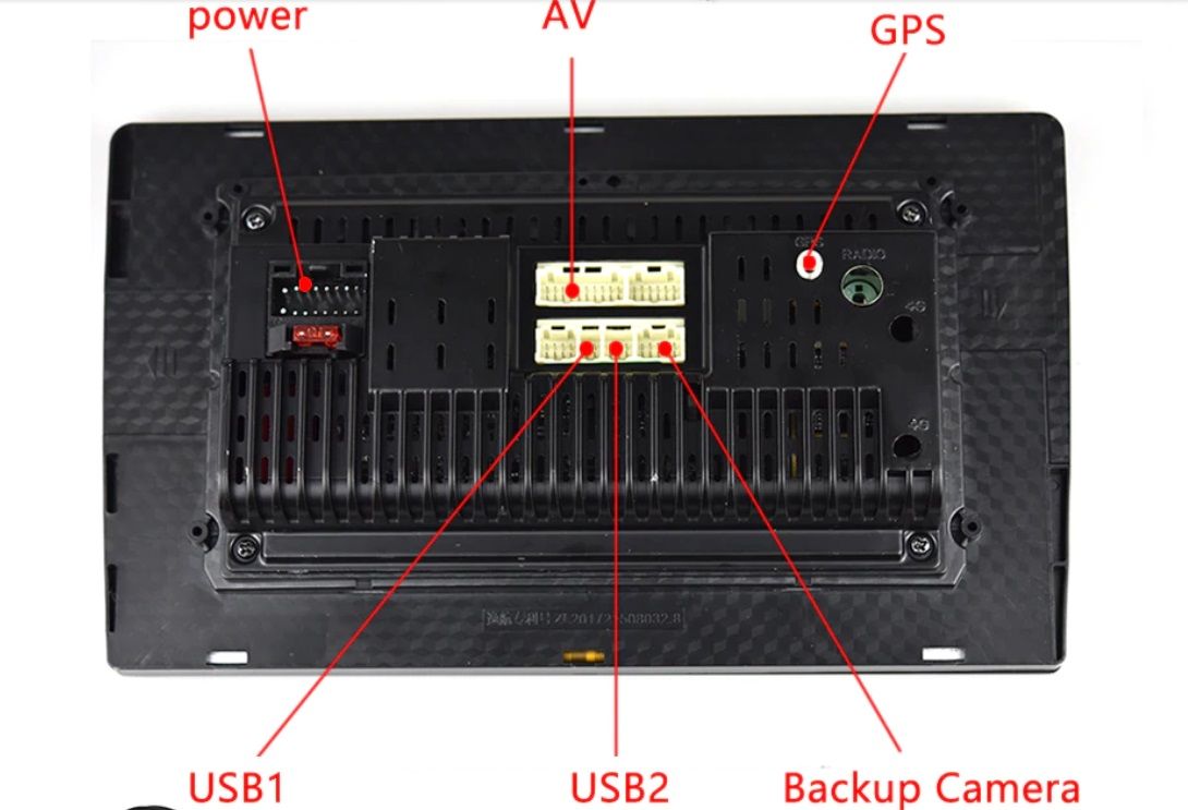

    I ordered a radio from aliexpress, tomorrow I'm going to connect it, unfortunately I don't know how to connect the cables well.
    cables for powering the radio from aliexpress How to connect the radio from aliexpress to the ISO cube (Opel Astra h, CDC40)
    yes, it looks original in Opel How to connect the radio from aliexpress to the ISO cube (Opel Astra h, CDC40)
    The cables with the speakers are signed, I do not know which cables from the ISO cube to connect the cables marked: "Reversing control", "Key2", "Ant Control", "ACC", "Key1", "Lamp control", "GND" , "B +",
    I will be very grateful
    Have a nice day

    The speakers are probably not a problem to connect, the same 12V power supply is B +, GND is the mass. I don't know what a radio, but from what I guess:
    Reversing control - the signal that turns on the rear view camera, the signal from the reverse light bulb or somewhere where there is a signal of the reverse engaged.
    It remains to connect the ACC to the ignition switch
    Rather redundant, there is nothing to connect:
    Lamp control somewhere under the signal that turns on the lights, probably turns on the backlight of the buttons when the lights are on, or dims them.
    Ant cont - probably the AA equivalent from the original radio - signal for electric antenna.

    Okay, and if I wanted the radio to start from the button (not after turning on the ignition), how should I connect the cables?
    I will also add photos of the radio if that helps
  • #6 18349002
    sylweksylwina
    Posts: 13197
    Help: 1877
    Rate: 2341
    Sure ACC and B + for power will do the trick.
