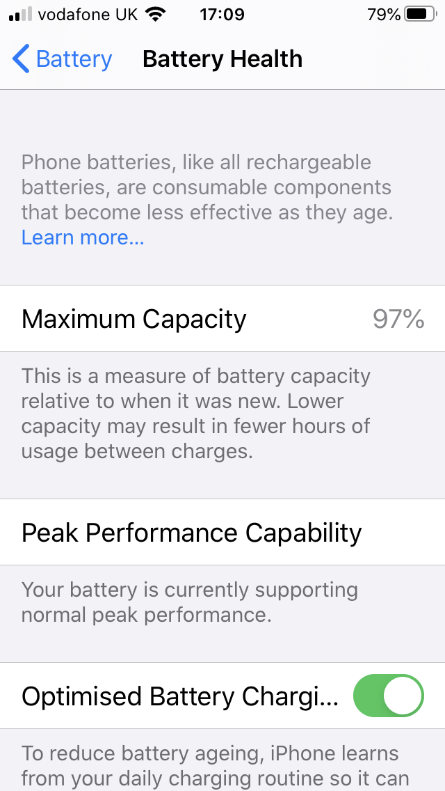

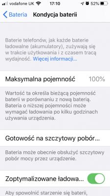

    There is something about it. In the latest IOS for the iPhone there is an option to optimize charging. That is, the phone collects information about the user's daily routine (and what does not collect now?) and after connecting the charger for the night, it charges up to 80%, and just before the usual hour of unplugging the charger, it charges up to 100%.
    Since I bought a model with wireless charging, I try to charge only to about 80% and with a low current because I have a 5W pad. Effect? Over a year of time and 100% battery. At the same time, a business phone that does not have such a solution and is charged with a cable up to 100. Differences as in the attached pictures.
