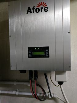

    Hello, for a long time I have been trying to connect in any way and from the laptop and through the mobile application to the inverter.
    wifi in the laptop and phone does not see the inverter, i.e. the AP ..... serial number. Maybe twice I managed to find the inverter wifi range for me, i.e. AP ... I connected then I got into the search engine on 10.10.100.254 and entered my network and password, then my application still does not want to connect to the inverter, as if it was not connected. Adds a logger by scanning the label on the inverter and still nothing.
    My wifi practically does not find this inverter at all. I do not know why .

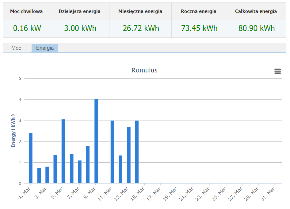

    What are you writing about, I think I know on which page it reads the data.
    To confirm your thesis, disconnect the wi-fi for 2 days and check if you dump your history data on the solarman.
    Now, customize the screen and think about why there is no data from March 10 in the history. Connecting AFORE Inverter with SOLARMAN App: AP Serial Number & Wifi Connectivity Issues

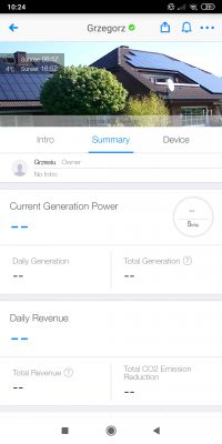

  • #11 18675601
    Elstar_andrzej
    I have the same problem. Here is the answer from the site:
    "Hello,
    Soft 12.35 may interrupt data transmission on the solarman, it will be necessary to update the software.
    Our service technician, after prior appointment, will upload the new software. "
    "We check the software in accordance with the instructions:
    1) Press ESC twice and then ENT
    2) When the menu appears, use the down arrows to go to Serial Number
    3) After the serial number of the inverter is shown, press the down arrow and it will show the values of DSP and HMI. "
    I am currently waiting for a service technician.

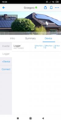

    Hello colleagues. My inverter also loses communication with the wifi module from time to time. After various combinations, I came to the conclusion that you need to change the port number in the rs485 settings to 1 and after a while the wifi module will get along with the inverter. Maybe one of your colleagues knows the installer's password for this inverter?
  • #13 18698353
    Elstar_andrzej
    There is nothing to play. I already had a service technician and changed the soft from 1.35 to 1.42. This is a free service under warranty. Works very well now. The old soft changed for some reason the RS485 parameters and hence these problems. He also improved the inverter settings so that the energy production increased. In fact, the inverter starts working much earlier and produces longer.
