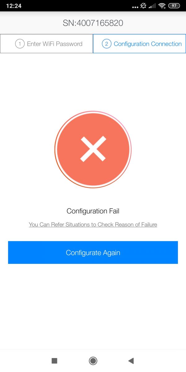

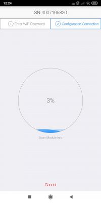

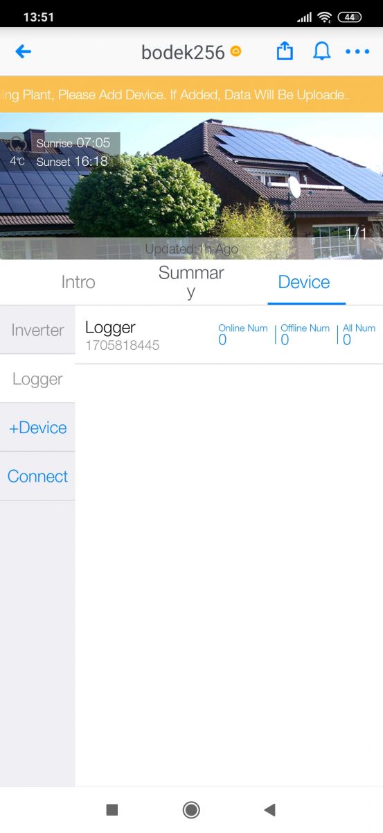

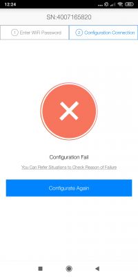

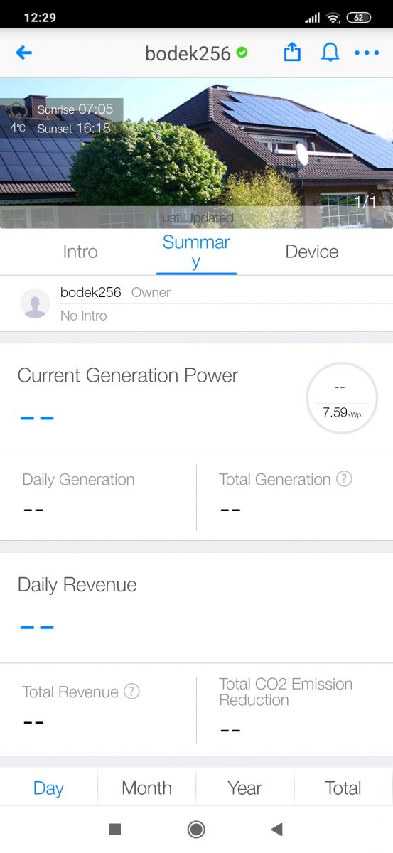

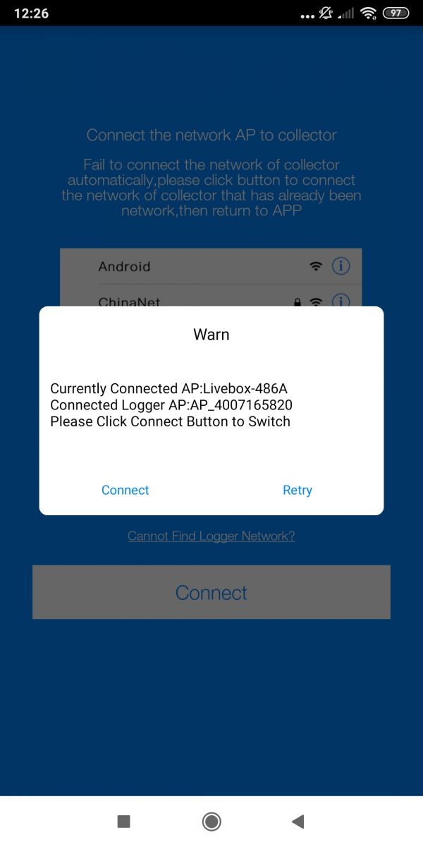

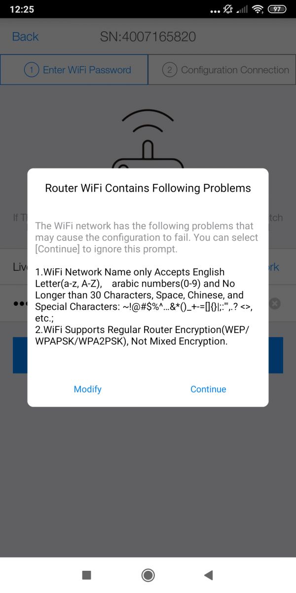

    I have a problem with setting up the sofar solar 6.6 ktl-x inverter so that I can see the parameters on the solarman application.
    Through the mobile application, I add the device by scanning the code from the sticker on the wifi module and I only add the data logger to me, and it does not see the inverter.
    After entering the page 10.10.100.254, I set the vizard tab to connect to my wifi network and go through each stage one by one.
    Could I please contact me and help in setting up?

    Recognizes the logger date from the sticker. I go through each stage after logging in on 10.10.100.254 and when I enter the solarman and summary application, nothing is displayed and after entering the device, I can only see the logger and not the inverter.

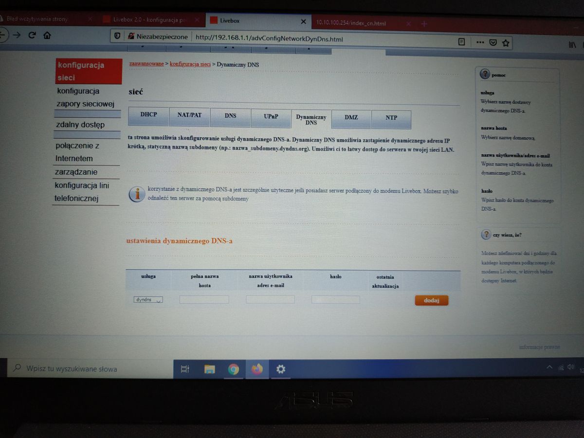

    it's bad network you have set up on saturday, i can take screenshots of how the inverter will be powered.
    Added after 13 [minutes]:
    Do you have DHCP enabled in the router or is it coming from your finger?

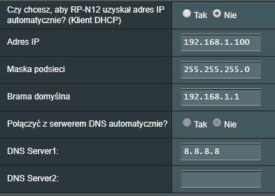

    it does not matter because the repeater gets the router settings, I had to do that too because the inverter is far from the network.
    If the repeater is properly configured, it will be visible on the list in the router for my RPN12

    The repeater is rather properly configured because I normally connect to, for example, a phone with the Internet through it.

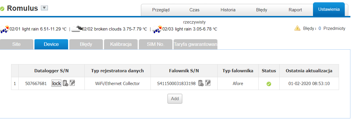

    What the Quick set shows in the inverter.
    there should be a configuration to what the inverter is connected to Connecting Sofarsolar 6.6 ktl-x Inverter to Solarman App: WiFi Module & Data Logger Issues
    In the status you have info about all connections. Connecting Sofarsolar 6.6 ktl-x Inverter to Solarman App: WiFi Module & Data Logger Issues
    At the bottom you can see that there is information about the connected server.

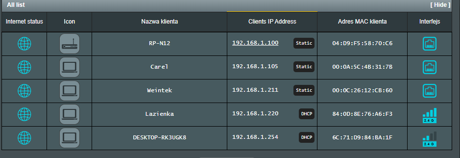

    And if you have everything well paired, the router will show your IP inverter and from this IP you enter the login page.
    As you can see on the list, it is AFORE, which means that the connections are correct.

    And what DNS you have set in Repater, change to static and google 8.8.8.8 or 8.8.4.4

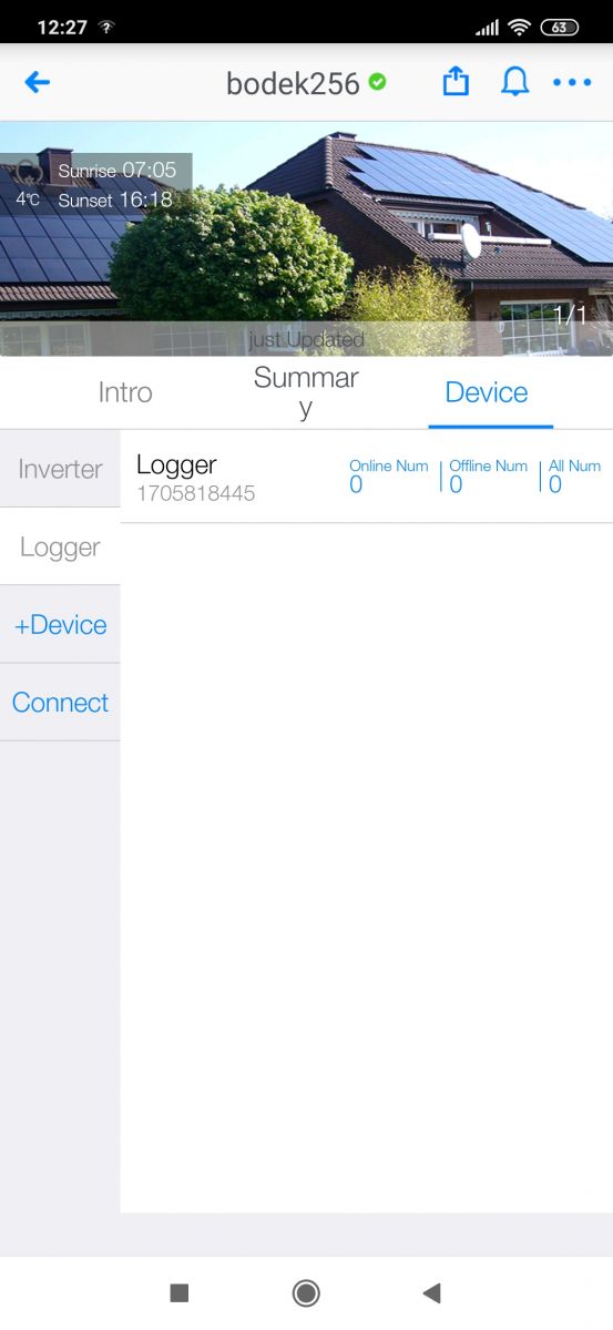

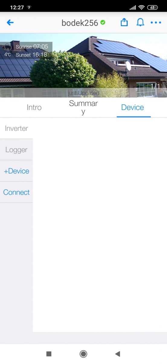

    Except that the logger did not see the inverter, the problem was solved. I had to change the inverter code to 01 in the set adress settings and then the communication between the inverter and the wifi module started.
    Now I have another connection problem. After logging in to the application, everything is fine, but after approx. connection crashes. I will try to set a static address and DNS to google in the repeater.

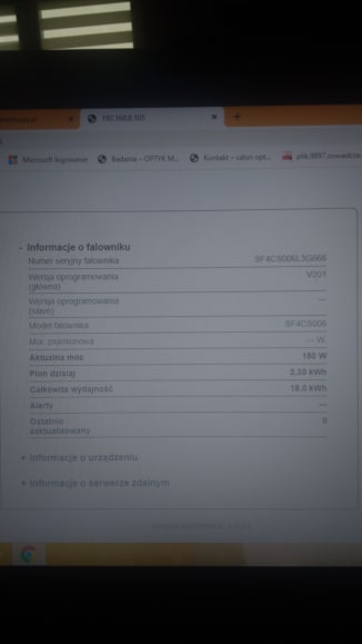

    I don't get it. I've been struggling with this for a week and I can't put it together. She gives him her network and password and won't connect. He tries to stand at the inverter and under the router and gives nothing. Above the boiler room, on the first floor, there is a router than the net. The inverter in the boiler room, of course. Connecting Sofarsolar 6.6 ktl-x Inverter to Solarman App: WiFi Module & Data Logger Issues Connecting Sofarsolar 6.6 ktl-x Inverter to Solarman App: WiFi Module & Data Logger Issues Connecting Sofarsolar 6.6 ktl-x Inverter to Solarman App: WiFi Module & Data Logger Issues Connecting Sofarsolar 6.6 ktl-x Inverter to Solarman App: WiFi Module & Data Logger Issues Connecting Sofarsolar 6.6 ktl-x Inverter to Solarman App: WiFi Module & Data Logger Issues
  • #17 18470534
    bodek256
    Posts: 11
    Rate: 19

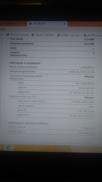

    Give a screen of the wifi module from page 10.10.100.254
  • #18 18470820
    Przemula1
    Posts: 34
    Rate: 30

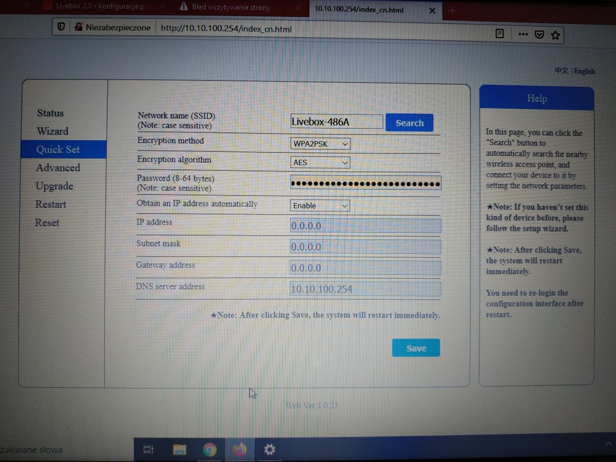

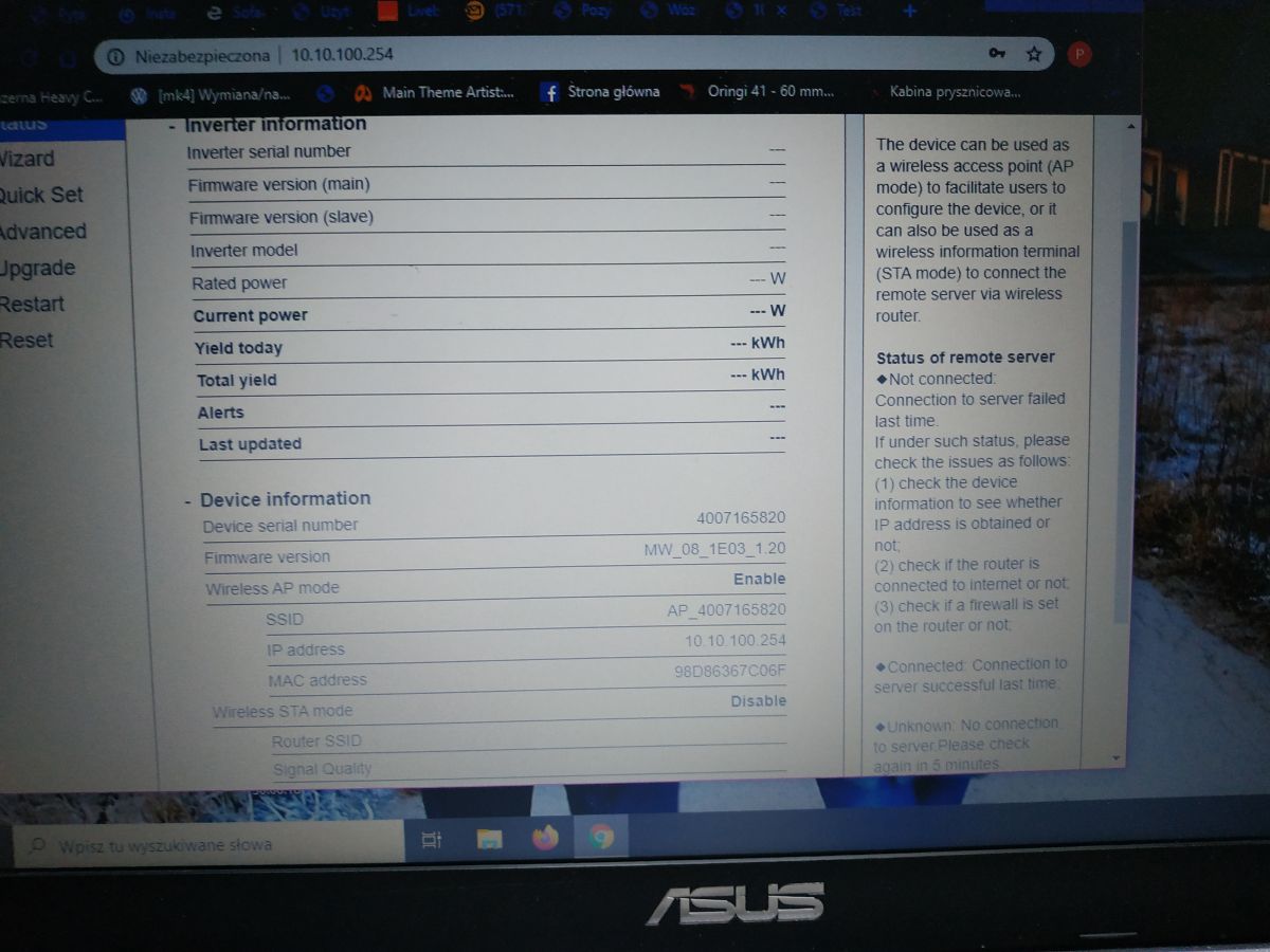

    At the moment, it only has this because I did the phone once and I'm away from home. Connecting Sofarsolar 6.6 ktl-x Inverter to Solarman App: WiFi Module & Data Logger Issues Connecting Sofarsolar 6.6 ktl-x Inverter to Solarman App: WiFi Module & Data Logger Issues Connecting Sofarsolar 6.6 ktl-x Inverter to Solarman App: WiFi Module & Data Logger Issues
  • #19 18470847
    bodek256
    Posts: 11
    Rate: 19
    Send screenshots on the vizard tab and when you set everything here, go to the status and send the screen

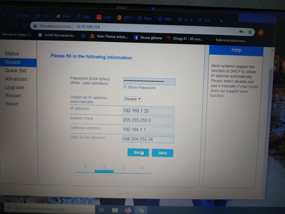

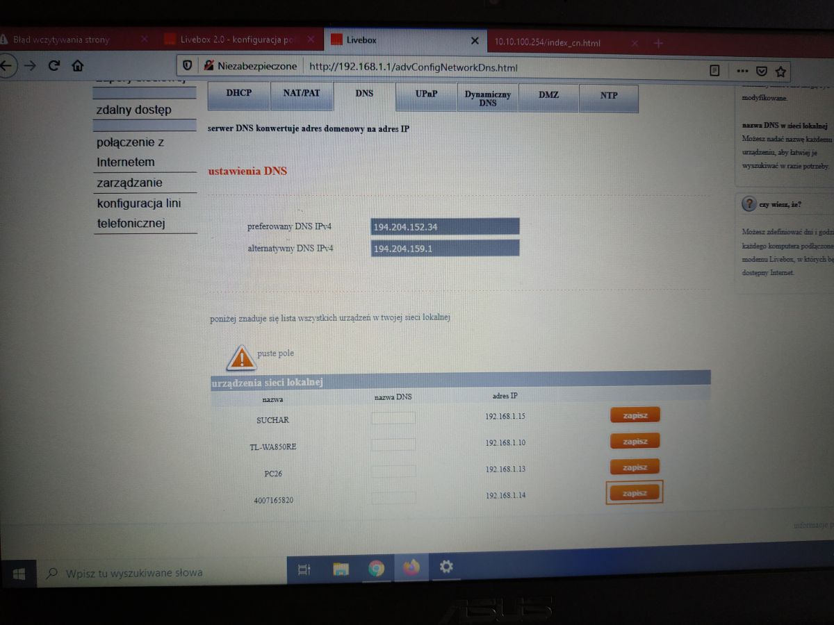

    In your screenshot you can see that the box does not assign you an IP after DHCP, try statically.
    Cyba is not a problem to enter
    192,168,1,25
    255.255.255.0
    GW 192.168.1.1
    DNS 194.204.xxx.xxx
    Basics gentlemen, the wifi module mode is STA

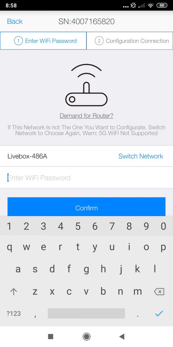

    I don't know if I'm doing it right. Connecting Sofarsolar 6.6 ktl-x Inverter to Solarman App: WiFi Module & Data Logger Issues Connecting Sofarsolar 6.6 ktl-x Inverter to Solarman App: WiFi Module & Data Logger Issues
    Added after 4 [minutes]:
    But even when in the police wizard I will not enter these addresses in the manual options only from the machine, it also seems to be successful, but on the right I think something is wrong with the IP. [img-0]
    I do not know if he is entering the data given by his colleague Romulus in the right place

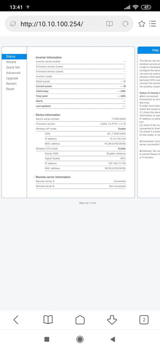

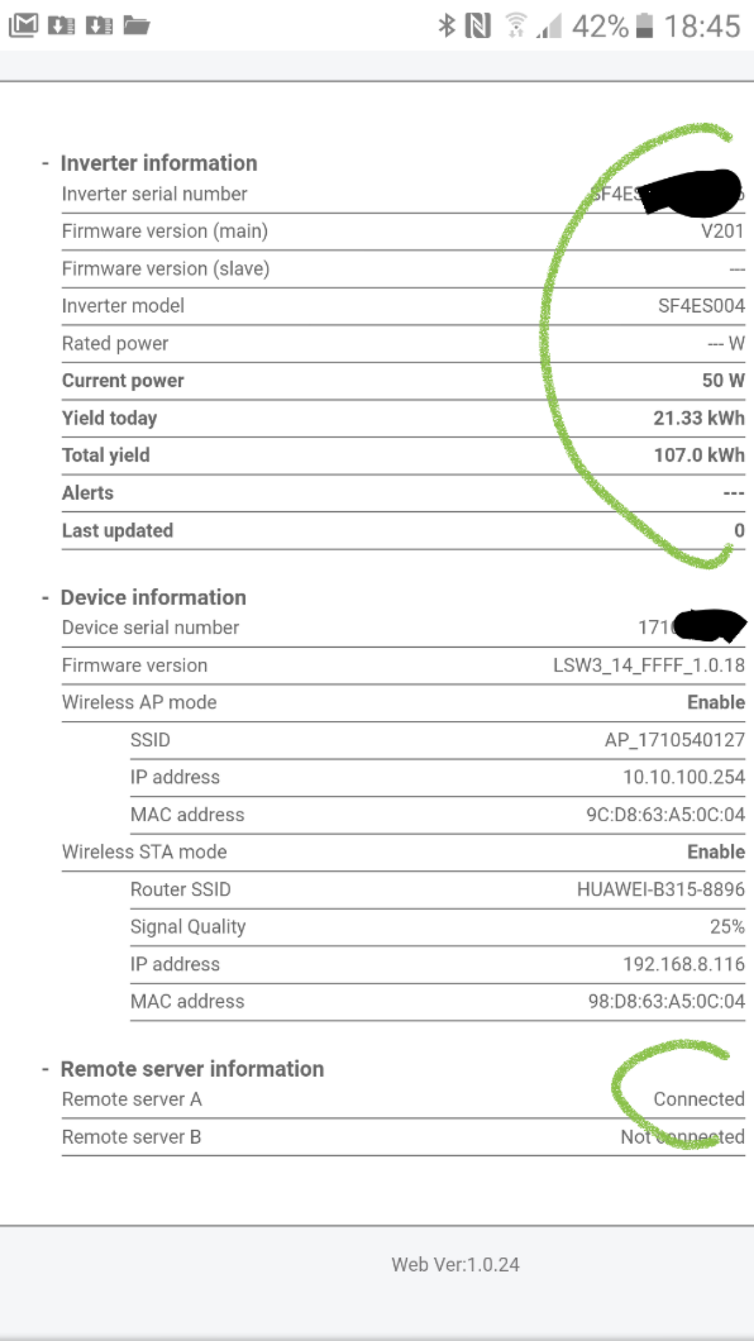

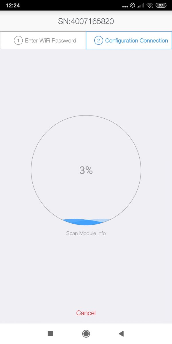

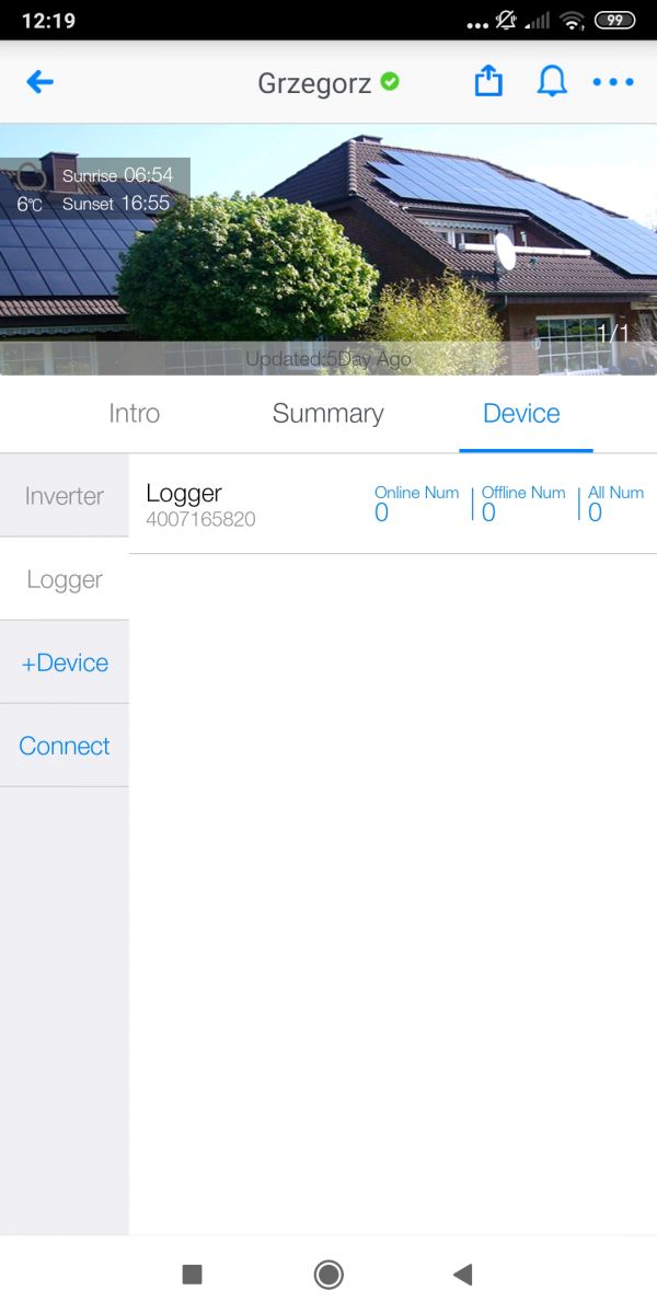

    Hello colleagues.
    Today I fought the first stage.
    In order for the WiFi module to connect to the inverter, w inverter it must be, as one of the colleagues wrote, the address set 01 . This is done in the inverter menu on the LCD screen. Then the WiFi icon lights up. If on page 10.10.100.254 there is no inverter number and instantaneous power as in the last picture, it means no communication. For me it was the wrong address of the 485 bus.
    There remains a problem with the transmission to the server with which relates connection. But it could be an error in the server data, for example.
    The photo shows the inverter data at the top and "connected" at the bottom. No inverter data = no transmission.
    I found a problem. The account is not activated because the email xxx(_at_)op.pl is not accepted and the activation code is not sent to the online email. Now the producer has to cancel it because the data logger is assigned to an inactive account.

    Ladies, turn on STA mode for wifi, I thought you got the basics.
    AP mode vs STA mode is used to connect esp to the network, i.e. the AP your AP is a router, modem for anything broadcasting
    My colleague Przemula1 has STA turned off in the second screenshot, just read what I put in my screenshots, STA ENABLED is shown, this is the usual network configuration like any other device.

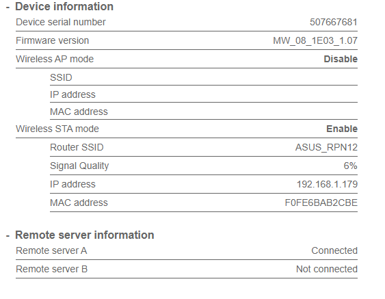

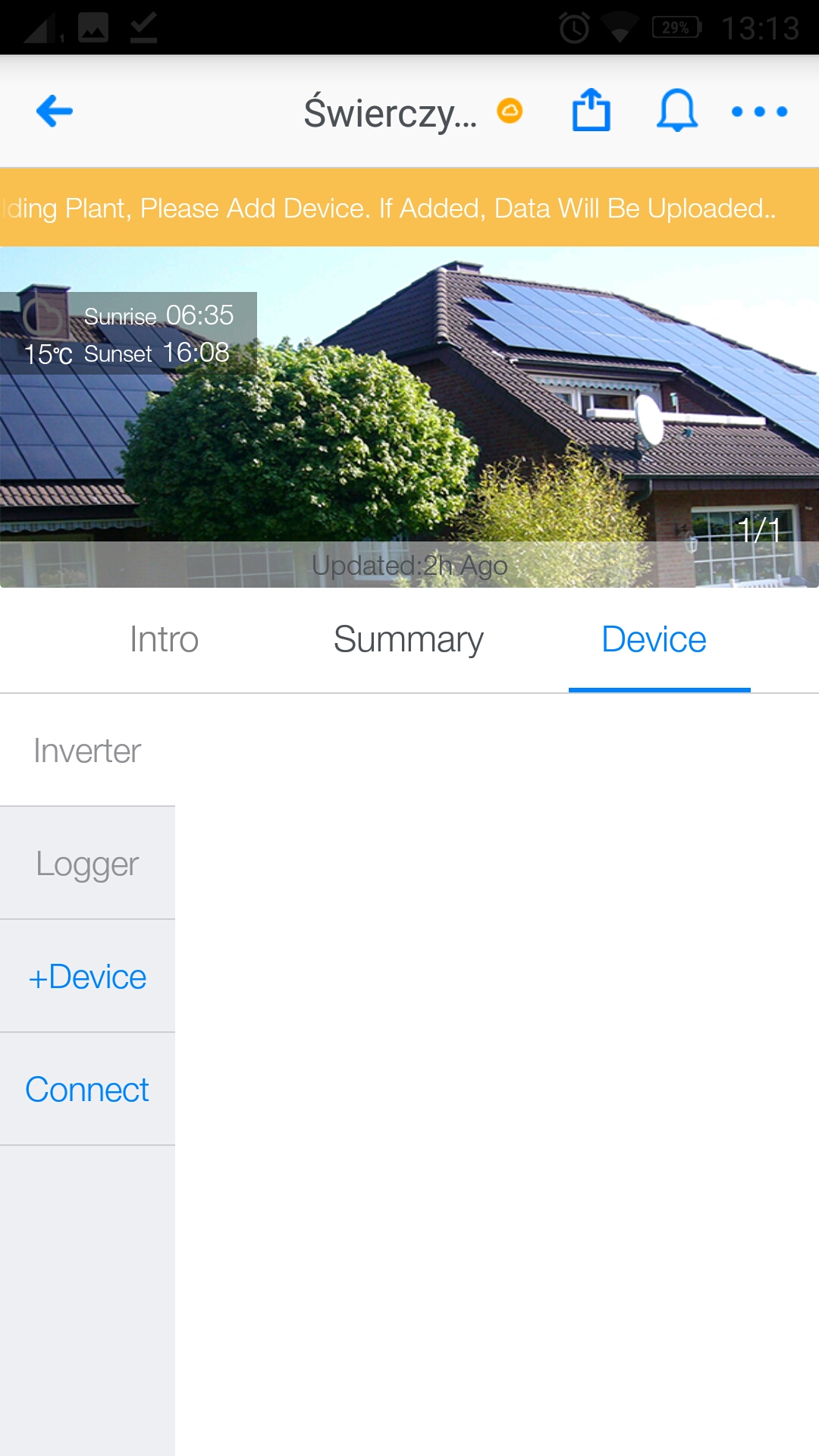

    the topic is a few months old, but I will ask because I have a similar problem. new installation (14 days), 8.8 ktl-x inverter, it was working properly for the first days, the inverter communicated with the wired module - the data went to the network, one day on the website and in the application it writes about some update - the wifi module is dead, the inverter is working and produces electricity, but the data does not go to the grid. in the settings, I have this magic 01, but there is no wifi icon on the display, and the module itself should show a flashing LED when working. As if the wifi module "died" was turned off, in my network I can not see anything with "AP"
    is the solution to "remove the data logger's number from the server" by the assembling company?

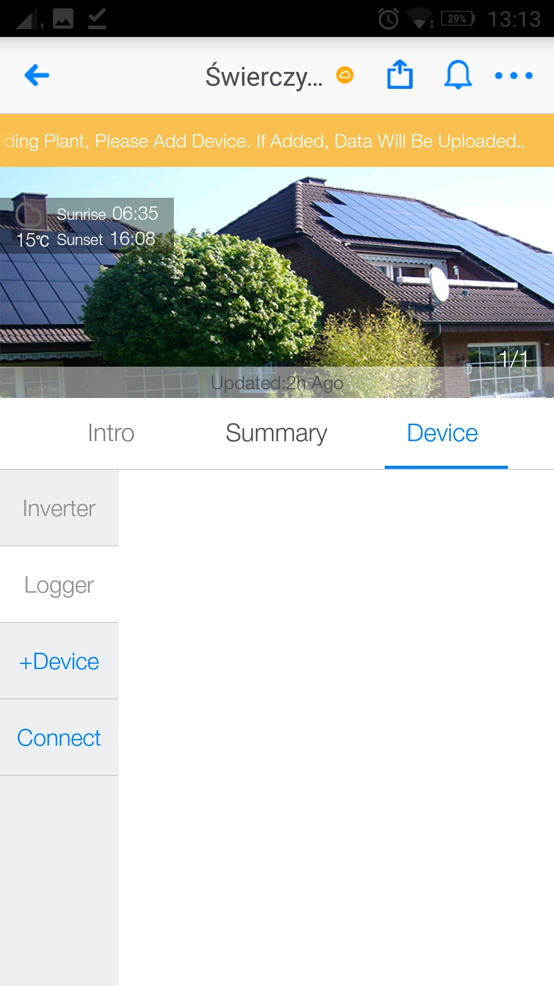

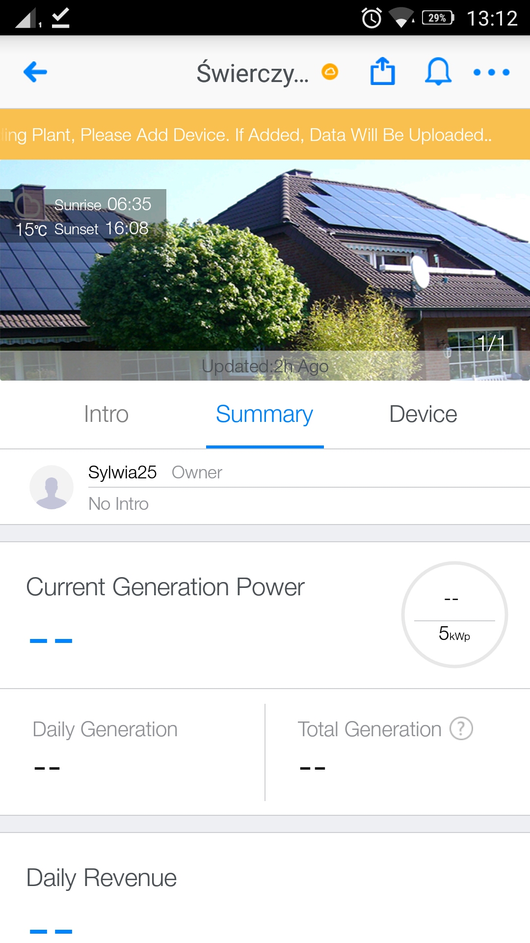

    forehead, I have a similar problem, when I enter the logger through the browser, I can see everything, but in the REMOTE SERVER A position I have not connected (I have not changed the counter yet, fired on probe, but it probably does not matter)
    I can't connect to the app, I'm offline all the time.

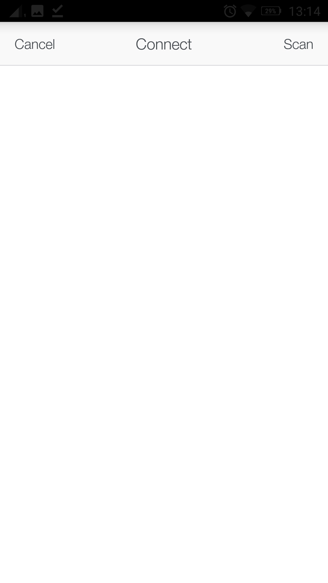

    Hello, I have a problem in the solarman application, I don't have any data. It seems to me that everything is connected I attach photos
    I do configuration in the Connect tab in the application, the result is positive and in the application there are no data from the faucet.
