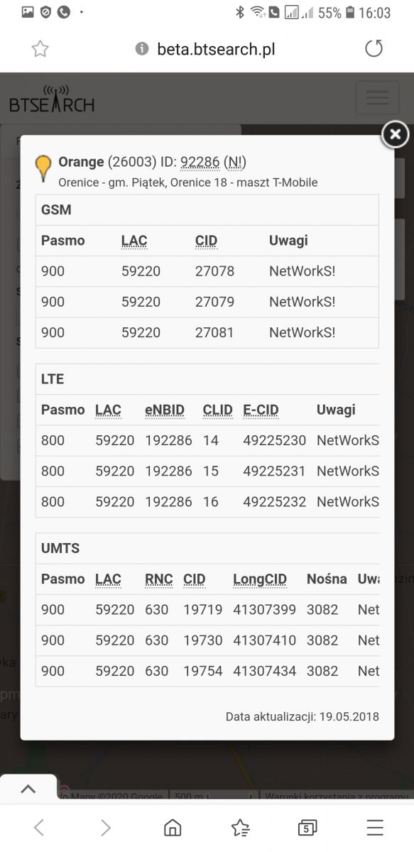

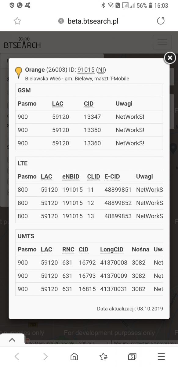

    I do not have much to check with the phone, because I have Plus. There are two transmitters on the map, one is 4 km from Bielawa, but there are forests on the way, and the other about 10 km from Orenice and forests. Office Orange LTE Internet 999GB: User Experiences, Performance & Alternatives in Remote Areas Office Orange LTE Internet 999GB: User Experiences, Performance & Alternatives in Remote Areas

    But the choice of mobile operators does not end with Orange, in your location coverage is not a problem, but what the NetWorks network looks like in the area. It is used by Orange and T-mobile and May BTS only 800 / 900MHz, i.e. Bielawska Wieś, Gaj and Gosławice. On such bays only LTE800, each operating on 10MHz bands, by assumption are free and in practice clogged, so do the Orange and T-mobile test on their cards on the phone outside, install the application https://play.google.com/store/apps /details?id=cz.mroczis.netmonster&hl=pl and show screenshots from it and speedtests for these operators. Plus has BTS in Bielawy with LTE1800 at 20MHz and pseudo LTE900 at 5MHz and nothing else, this station serves a huge area, so Plus there is practically no such thing and the choice of a phone with this operator is a bad joke, check the Internet from Plus on this card what you have just like before Orange. This is the worse information, at the end the operator who puts the competition on the paddles there, i.e. PLAY, the nearest base stations are Gosławice and Piotrowice, there are 3 LTE1800 bands at 15MHz, LTE2100 at 10MHz and LTE800 at 5MHz, i.e. in the aggregation of the 30MHz band, at your place outside you can use it, take the Play test and see for yourself. It is the only mobile operator that is able to provide normal internet in this location.

    First, turn off the RK wife on the phone if you want to test the Play home network on the wife's phone, you do not understand the topic, Play has built a 60 m mast in Gosławice, about 4 km from you, so you should even see it. PLAY antennas on top, below T-mobile. For this, the same in Piotrowice. As I said, Play test with this application but with domestic roaming turned off. Let's treat the satellite as a bad joke, in Play there are two BTSs to choose from, so due to their visibility, the directional antenna will allow you to choose the one that gives better speeds, I do not throw words to the wind. Anyway, I know this area, I live 30 km from you.
