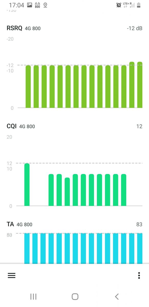

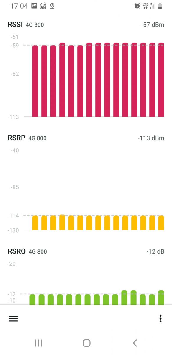

  • #10 18536025
    matek451
    Posts: 31253
    Help: 4352
    Rate: 5808

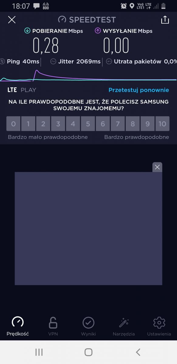

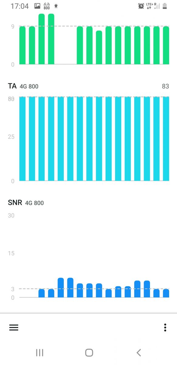

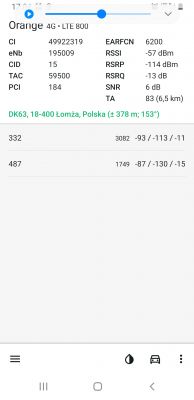

    But this is a test made in RK Orange and not in PLAY, turn off RK on the phone, test outside. In Orange it is a misery on LTE800 from BTS Networks on TON Łomża, the signal is very weak but this is normal because NW is practically non-existent with you.

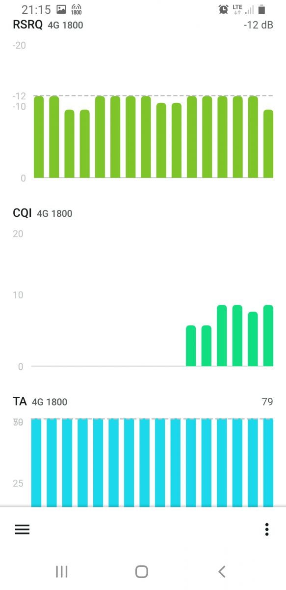

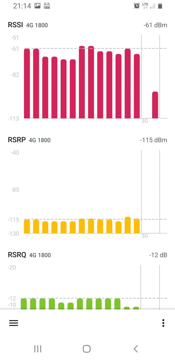

  • #11 18536108
    danielwoj1234

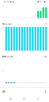

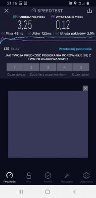

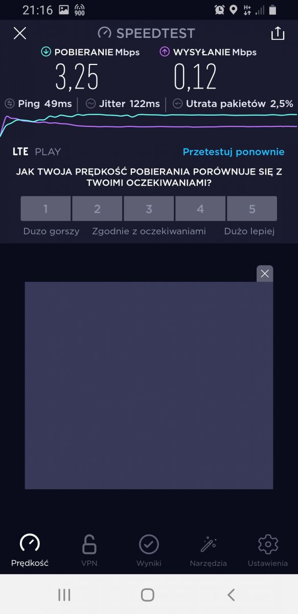

    OK thanks. I changed it manually to play. Screenshots below. Best Internet Provider for Countryside Living: Tips for Choosing LTE at 53.114623, 22.148562 Best Internet Provider for Countryside Living: Tips for Choosing LTE at 53.114623, 22.148562 Best Internet Provider for Countryside Living: Tips for Choosing LTE at 53.114623, 22.148562 Best Internet Provider for Countryside Living: Tips for Choosing LTE at 53.114623, 22.148562 Best Internet Provider for Countryside Living: Tips for Choosing LTE at 53.114623, 22.148562
  • #12 18536300
    matek451
    Posts: 31253
    Help: 4352
    Rate: 5808
    Outdoor test? Connection with BTS-EM Łomza -Owocowa on LTE1800, signal very weak but good speeds, LTE2100 and LTE800 also arrives, no signal on LTE2600. Tests showed that PLAY should be OK, Owocowa is a BTS 5GR powered by fiber with 4 CC CA. The optimal router is a B818 that supports such aggregation and an external Dual LTE 1800-2600MHz antenna for it. 200GB for PLN 50 / month and B818 for PLN 229 for ownership, for this purpose contact DB at https://forumplay.pl/showthread.php/55333-Internet-bez-limitu-GB-(200)-z- device% C4% 85dzaniem-Promotion / page38 and you write to PW with them, proven people, you will not get such a promotional offer anywhere for such a price with b818, the router itself is worth PLN 900.
