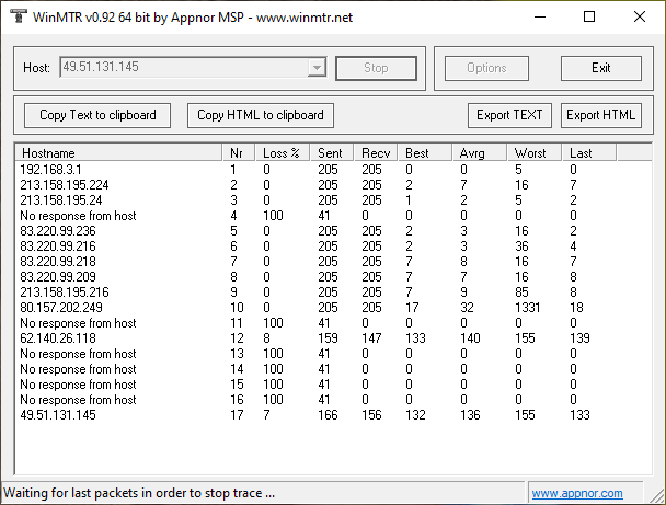

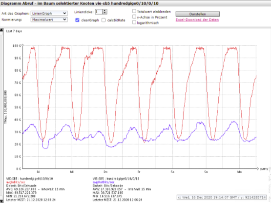

  • T-Mobile routing issue caused by Vienna peering bottleneck
    #3 19268368
    bbartek93
    Posts: 110
    Help: 19
    Rate: 29
    T-Mobile has better routing in Poland, it also has good routes abroad, but recently there have been problems with Level3 -> Deutsche Telekom, the German T-Mobile is too weak for packets entering the T-Mobile network, and some servers returns the route to T-mobile via Level3 and therefore high latency and packet loss occur there.

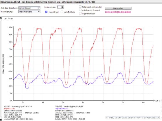

    And here is the cause of the problem, the contact between the German T-Mobile and Level3 in Vienna:
    $traceroute -4 -w2 46.205.193.47
    traceroute to 46.205.193.47 (46.205.193.47), 30 hops max, 60 byte packets
     1  * * *
     2  vl199-ds1-j2-305CR52B5.lon3.choopa.net (45.63.102.161)  17.751 ms  17.757 ms  17.741 ms
     3  * * *
     4  * * *
     5  6-1-9.ear1.London1.Level3.net (195.50.91.1)  1.591 ms  1.594 ms  1.583 ms
     6  ae-1-8.bar3.Vienna1.Level3.net (4.69.148.138)  24.373 ms  24.335 ms  24.312 ms
     7  80.156.160.133 (80.156.160.133)  136.834 ms  136.497 ms  136.492 ms
     8  217.239.41.214 (217.239.41.214)  137.255 ms  138.444 ms  137.013 ms
     9  80.157.206.190 (80.157.206.190)  151.286 ms  150.784 ms  150.963 ms
    10  83.220.99.219 (83.220.99.219)  149.489 ms  149.373 ms  149.225 ms
    11  83.220.99.220 (83.220.99.220)  143.987 ms  144.014 ms  144.379 ms
    12  * * *
    13  * * *
    14  * * *
    -- Traceroute timed out --
    T-Mobile optical fiber - opinions
    In addition, T-Mobile will soon start providing public IP as an additional paid option. I have already received such an IP as a pilot.

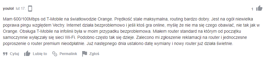

    Complaint-based upgrade to premium router
    #5 19271712
    bbartek93
    Posts: 110
    Help: 19
    Rate: 29
    @siaklg
    You can file a complaint with the standard router that there are problems with it and they can exchange it for a premium one without any additional payment. Someone has done that before.
    Because there is no need to pay extra for this premium, because we do not own it anyway, then you can buy your router for this money. If they give for free and no one needs access to the panel, such a trick can be made through a complaint. Even if it does not disconnect the WiFi, you can write it anyway in the complaint, after all, they will not check it for you anyway, and then they give you a premium router for free with better antennas.

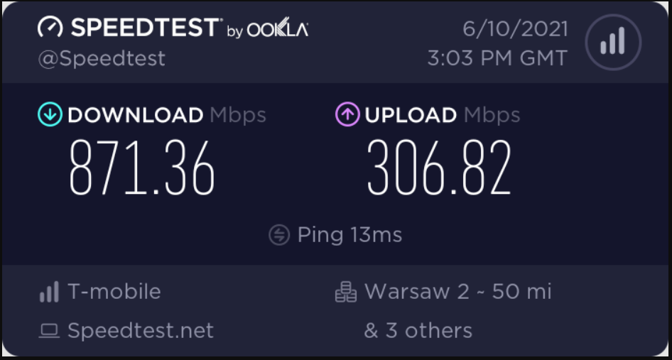

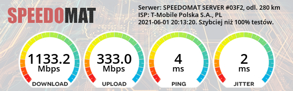

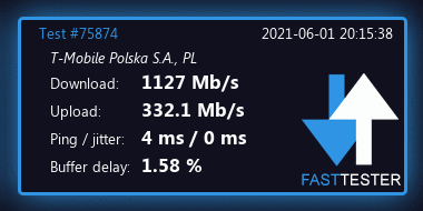

    LAN speed reaches 900 Mb/s despite upstream issues
    #8 19461527
    bbartek93
    Posts: 110
    Help: 19
    Rate: 29
    I do not know how these tests, what you wanted, give such results after LAN up to 1Gb / s at a speed of 900Mb / s ;)

    Here are some more tests on speedtest.net:
    So that it is not too colorful, the contact with Cogent lies for 3/4 of a day and there are such speeds through it:

    Today they set up a TM net for me, so far ok, I have done some tests and it's okay after 860 Mb / s on wi fi about 500 everything flashes as it should, except for the console on which I have NAT closed, I called TM and they said that it must stay like this, why? , the download speed has also dropped max 350 I do not know if it is related to closed NAT or servers at the moment, but in Orange it was much faster with open, the type said something about external ip but there is no paid service yet, as someone knows how dispel please for info T-Mobile optical fiber - opinions

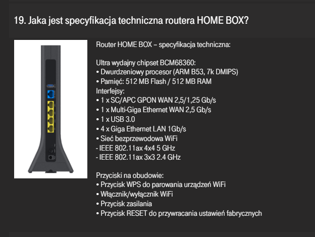

  • Built-in router lacks VLAN support and weak NAS throughput
    #28 20679908
    trivial1
    Level 20  
    Posts: 274
    Help: 36
    Rate: 61
    Pilot_Pirx wrote:
    I don't know what their router does. I would like to have separate VLANs and control over what is happening on which network. In addition, I would probably have to connect a switch anyway because I have some twisted pair cables routed around the apartment.
    This is the simplest router with a built-in 4-port switch, no VLAN.
    The only pluses is that it has very good Wi-Fi. Even Ubiquity u6 pro fell. My old mate 20 pro on their 100MB/s router sucks from NAS via FTP. On Unifi from 70 to 90MB
    Rear panel of the HOME BOX router with visible Ethernet ports, fiber port, and control buttons.
