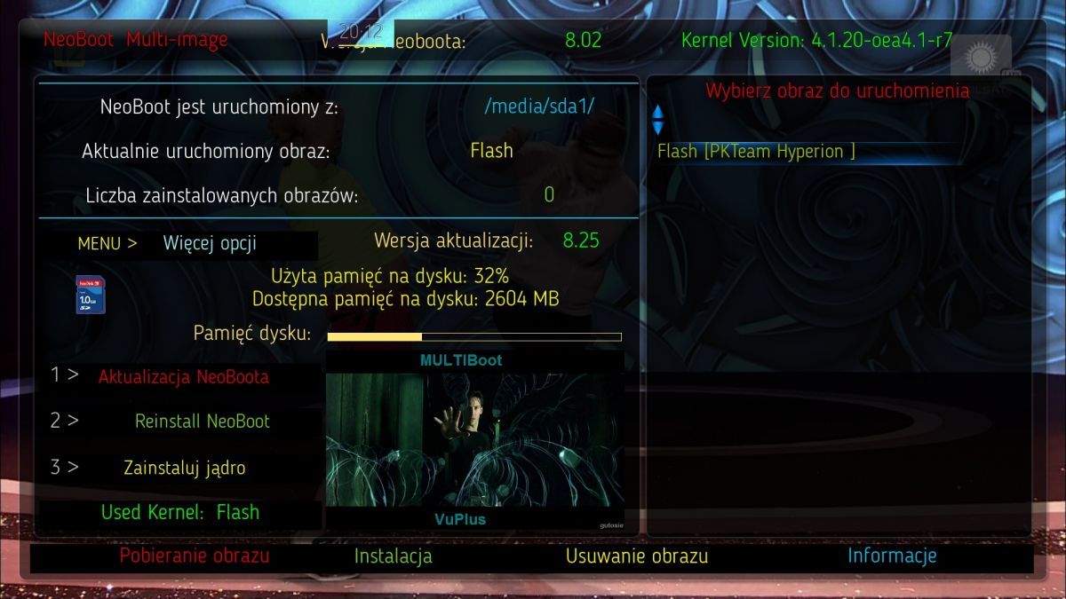

    To test different images you don't need to upload them directly to the tuner. You do a multiboot or neoboot (better) on a pendrive, load the image you like there and test them, without re-uploading the software to the tuner.

    My Neoboot :) Zajeb @ # a case. Installing OpenVPN Manager on OpenATV 6.4: Step-by-Step Guide & Troubleshooting FTP Issues
