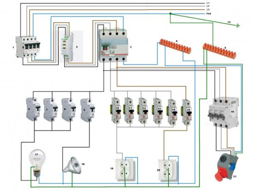

  • Load balancing and neutral current sizing question

    In connection with a similar topic, I have a theoretical question, namely whether it makes sense to install 3f in such a case? (Apart from the hob in the kitchen). What I'm aiming for is that I want to separate some rooms in the house as a separate apartment. If I assume correctly 25A for 2.5mm², the output for 3f is over 9kW. But now when I start dividing the phases into rooms, for example the kitchen separately, the boiler separately, the rest separately, the 9kW is not so obvious anymore. If I have a load of 16A on each of the divided parts of the apartments at one moment, then I have 48A on the N wire of the connection, right? Do I understand that correctly? So at least 4mm² or even better 6mm² on the connection from the main fuses to the planned new part of the apartment?
    Thanks in advance.
    Starting point for the discussion.
    Clearer, please, my Lord ;) What is 25A, what is 2.5mm². What do you think these 9 kW are?
    I will leave the rest of your post without comment because it is simply fiction.
    Thanks in advance
    If I understood correctly, the load current under the cable cross-section for a power of 9000W÷230V = 39.13A and this is if there is no voltage drop, which is unlikely.
    A single-phase meter can be loaded with a maximum load (the information on the plate is, e.g., 5/40A for induction, 60A for electronics), so it will withstand the load. However, the WLZ in the staircase certainly does not have such a cross-section, unless in the ZK at the BMs. The administration or cooperative is responsible for the installations in the staircase and they give approval for the connection.
    To the author, these 8kW are probably with a load on three phases because the cooperative agreed to this power. There are places where the heating of an apartment in a block of flats is connected in a ZK cabinet on 4x10mm² BMs and goes to the 4th floor and is protected against the B40A meter. So the event is expensive.
