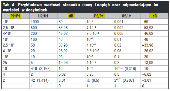

    MrPiotras wrote:
    I am having trouble understanding the units of attenuation i.e. dB
    Suggest you read https://ep.com.pl/files/4169.pdf - decibel is just an easier to use measure of signal attenuation or gain multiplication. In HF technology we usually use the multiplication factor of attenuation or power gain.
    In the above article is table 4:
    Understanding Wireless Networks: Attenuation Units dB and dBm, RSSI Values, and Signal Strength
    Instead of writing "The cable between the antenna and the receiver is long and introduces 100 times the signal attenuation" we can write "introduces 20dB attenuation".
    MrPiotras wrote:
    signal power dBm
    This letter "m" indicates what the reference level is, in this case 1mW. Hence, below you write:
    MrPiotras wrote:
    work at 100 mW or 20 dBm
    because 20dB in multiples is 100 times - 100*1mW=100mW.
    MrPiotras wrote:
    Another question, the router should be operating at 100mW which is 20 dBm why then right next to the router the signal power is about -15 dBm instead of those theoretical 20 dBm?
    Because the output of the transmitter is not connected to the input of the receiver by a perfect wire - between one and the other there are still antennas with a rather omnidirectional characteristic....

    MrPiotras wrote:
    if the signal strength is, let's say, -50dBm and we attenuate it with a 7 dB wall, how do I calculate how much output signal will come out?
    -57dBm.
    MrPiotras wrote:
    How do I know if 7dB is a lot or a little?
    Calculate for yourself on a "multiplication" measure. -7dB is about 5 times the power attenuation.
