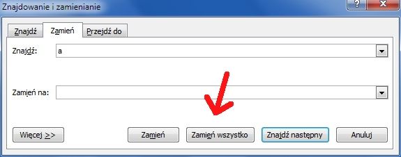

    I am converting dbf database to excel. By the way, it turns Polish letters into special characters. How to convert them back to Polish letters in Excel? Only uppercase letters are used.
    How to convert special characters into Polish letters: ? = Ł, ?= Ę, ? = Ż, ? = Ą, ? = Ć, Ó = Ń, ? = Ó, ? = ź
    I am not a programmer, I use excel, word as an intermediate.

    You can as follows (if you already know all the characters). You run "Find and replace" there you enter the first character, eg ?, and in the second field Ł. With find> replace you play in the exchange.

    I know that, but it takes too long. I was thinking of some faster way - with one click ...

    Kresowianin wrote:
    with one click
    In Word and Excel there is also an option "Replace all" (I mean it was, mine is "old" because Office 2007, maybe now "new" is not). Well, however, such a substitution can be applied to individual characters, so you would have to enter each character separately and then "Replace all" and so in turn for all characters ...

    [/ quote] In Word and Excel there is also an option "Replace all" (I mean it was, mine is "old" because Office 2007, maybe now "new" is not there). Well, however, such a substitution can be applied to individual characters, so you would have to enter each character separately and then "Replace all" and so in turn for all characters ...
    That's not the point either :) This is how you know, so I do. But my point is to be able to enter "swap all pairs" once and then give "swap all". I don't know if any macro? But I don't accept special characters ...

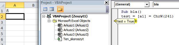

    PRL - you are closest to solving the topic. But there is one problem. At least for me - it doesn't accept the signs: ?, ?, ?, ?, Ó, Ó, ?, ?, ?. She puts a "?" Sign everywhere.

    Kresowianin wrote:
    does not accept the following characters: ?, ?, ?, ?, Ó, Ó, ?, ?, ?. She puts a "?" Sign everywhere.
    How do you enter these characters? Use "insert symbol" and select "Latin-1 (complement)" in the subset. Your stamps are there.

    The VBA editor will not accept any characters other than those in the table according to the locale.
    Check through AscW what code they have and proper basis.

    ta_tar wrote:
    But where?

    PRL - thanks for your help. After compiling all the information, something like this came out that might help others if they had this problem:
    Code: VBScript
