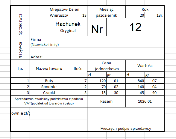

    adds a picture of a simplified account
    How to split decimal values into separate PLN and gr columns in Excel?
    Well, after entering some numbers in the PLN column and some numbers in the gr column, count it for me. Please help

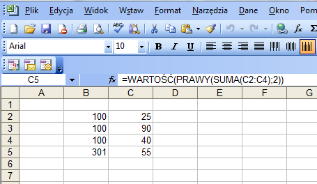

    Assumptions: I lost zlotys in column B (B2: B4), pennies in C (C2: C4)
    In B5 the formula: = ROUND TOTAL ((100 * SUM (B2: B4) + SUM (C2: C4)) / 100)
    In C5, the formula: = VALUE (RIGHT (SUM (C2: C4), 2))
    I get zlotys by adding up all zlotys and converting them into pennies (multiplication x100), then I add the sum of pennies and (already having the sum of pennies) I divide everything by 100. The decimal part is removed (rounded down).
    Pennies a bit easier - we sum them up, but to eliminate the result greater than 100 we only use the last two digits in the result (right function). As the result is then a text value, I convert it back to a number (value function).
    That was it?

    This is what it looked like for me:

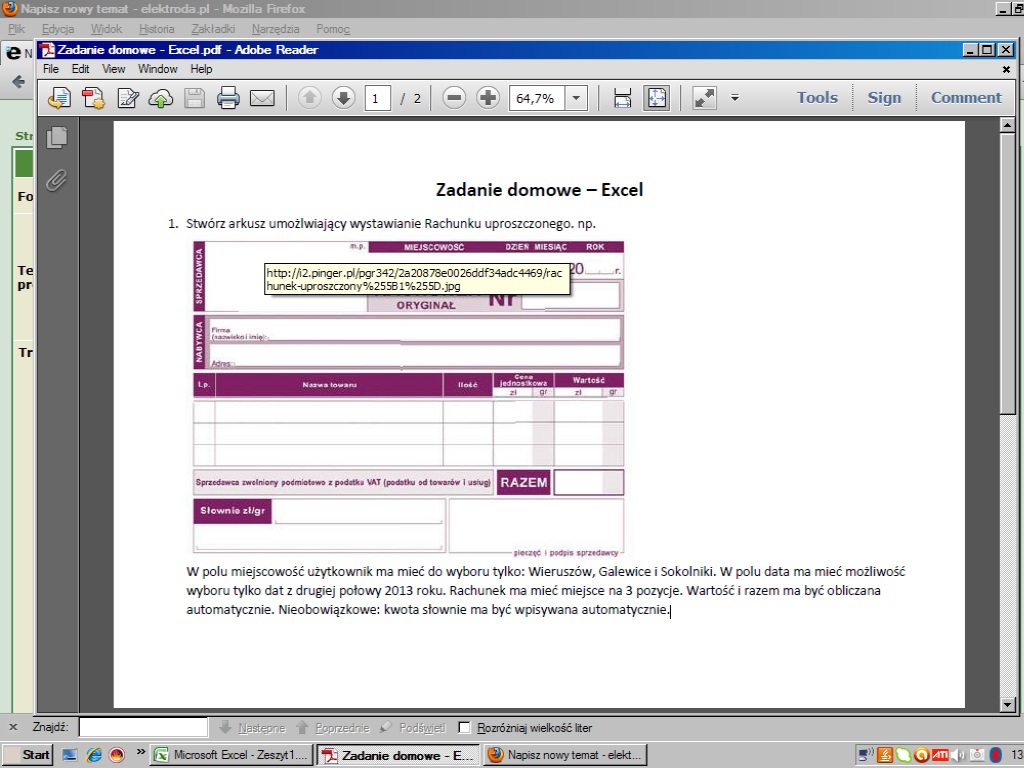

    This is exactly what it is supposed to be like
    They do not coincide, but for me, E14 is an amount and G14 are pennies in the unit price. I even don't have the strength to see today if it works for Exel, I have a laptop and currently I am sitting on the phone. As for the pass, these are the ready-made tasks that the teacher gave and only changed them a bit, in the next lesson I will tell you to explain it exactly.
