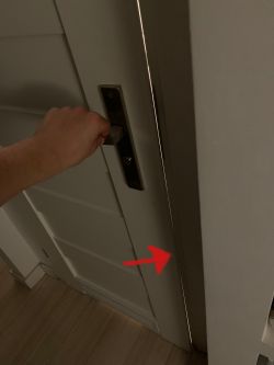

    My bathroom door does not close properly, it rubs against the vertical part of the door frame in the place marked in the photo.
    Fixing Non-Closing Bathroom Door: Adjust Simple Hinges, Frame Rubbing Issue (Janek's Photos)

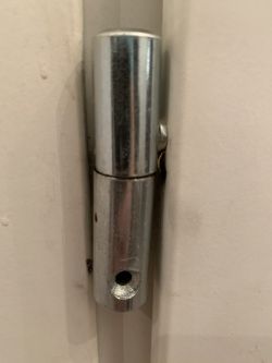

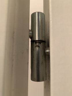

    The hinges are super simple and I don't see any additional allen keys to adjust. How can I adjust the door to close. Please help what can I do (all home remedies with washers etc are possible - I just don't see any use for them in this case). In addition, I post photos of the hinges.

    And this door was installed on days? Because it's probably the mounting foam that did its job and squeezed in this place. Apply spirit levels, patches to this place and check if there is no "belly".

    Take off the sash, screw in the hinges (those in the sash) one or two turns and that's it.

    Screwing the hinges in the door.
