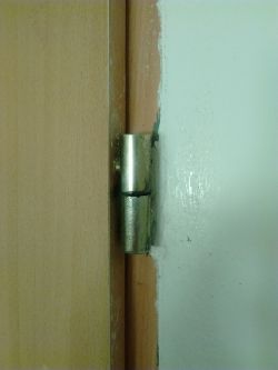

How can I remove an internal door with screw-in hinges when lifting it straight up meets clear resistance?
Lift the door from the hinge side, not the lock side, and use a lever or chisel with a small wood block placed right next to the frame to raise it while you rock the door open and closed so the hinges can rotate instead of jamming [#17113495][#17118749] These hinges often skew as they come off, so a straight upward pull can bind them even when the door is fully open [#17113495] A shot of WD-40 on the hinges can help before you try again [#17112800] If it is still stuck, check whether the hinge pin is rotating with the door; if so, the pin may need to be blocked against rotation, for example by drilling a small hole and inserting a nail [#17119502]

    Hello. The problem may seem trivial, but I have exhausted all the topics that suggest a solution to the problem. I need to remove the internal doors from their hinges (screw-in type, without external adjustment), but an attempt to lift them is not possible, there is a clear resistance. So how can I take them out?
    I do not know what else I could inform you about, so ask, I will try to answer.

    Such hinges usually do not sit quite so rigidly in the door and frame, which causes them to skew when pulled off and thus to get jammed.
    You have to put the lever right next to the door frame, because only the edges of such doors have solid wood inside.
    After placing the lever, you have to press the lever to raise the door, while moving it simultaneously so that the hinges rotate as when closing and opening.
    As you can see in the photo, the hinges are skewed from the very beginning of the assembly, so they are still a bit wedged.
    I usually use a chisel based on a small block of wood as a lever for such extraction, I press the chisel handle with my foot and with both hands I move the door, holding it at the same time so that it does not fall off the hinges.

    Hello, forgive me for delay. Unfortunately, moving the door forward and backward did not work, and I do not want to use force solutions such as levers, due to the fact that it is not my door and I am afraid to damage something.
    I am enclosing a photo of the second hinge and the door in its entirety. It doesn't look like the hinges are mounted the other way around, and I still don't understand what's stopping the door from gently removing it. The hinges have also been properly lubricated. To be clear - the hinges have absolutely no form of external adjustment, no screws, nothing.
