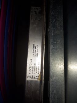

    Hello everybody!
    I have from 1 year problem with my dishwasher Electrolux esl65070 .
    The problem is - do not want to stop after complete drain the water. Stop but after 1-2 min with fault 2 times flashing the led.
    If I restarted sometimes start and finish completely , sometimes the same , the pump works and stop with error.
    I ordered a new pressure switch, but the same...Any ideas? Thanks in advance!
