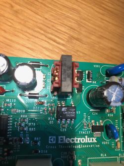

  • #5 16912111
    robsontcl
    Rate: 20
    I have the same problem yesterday I got a dishwasher, just for Christmas. I checked the continuity to the switch goes voltage, and normally it works on / off because it cuts off the voltage that goes to the program diodes. Only they do not light up and even as I know that the voltage has come and I choose the program and close the dishwasher and it does not react anyway ... Can someone suggest what can be?

    robsontcl wrote:
    Only they do not light up and even as I know that the voltage has come and I choose the program and close the dishwasher and it does not react ...
    Therefore, check these two components of the inverter :D
    The image shows a close-up of a circuit board with electronic components highlighted by yellow rectangles.

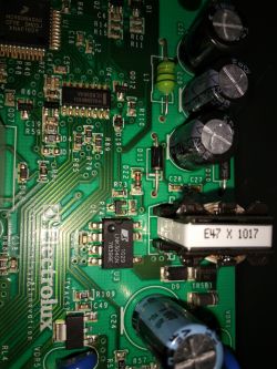

  • #7 16912156
    robsontcl
    Rate: 20
    Look professional eye, should it be checked with a meter?
    • Electrolux ESL65070R Dishwasher Not Turning On: Switch or Module Issue? 20171225_102959.jpg (3.19 MB) You must be logged in to download this attachment.
    • Electrolux ESL65070R Dishwasher Not Turning On: Switch or Module Issue? 20171225_103008.jpg (2.7 MB) You must be logged in to download this attachment.
    Not in this case, my reliable eye states without the help of the meter! What follows: both elements are 100% to be replaced which is visible to me with the naked eye :D

  • #12 17311002
    mrice
    Moderator of Home appliances
    Posts: 13923
    Help: 2209
    Rate: 6933
    Buddy, a few posts above, Toni put in a picture of an efficient record, just read the bar code of the resistor.

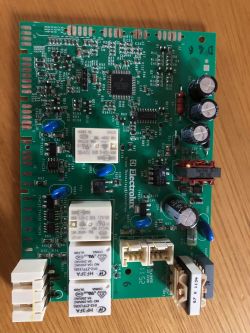

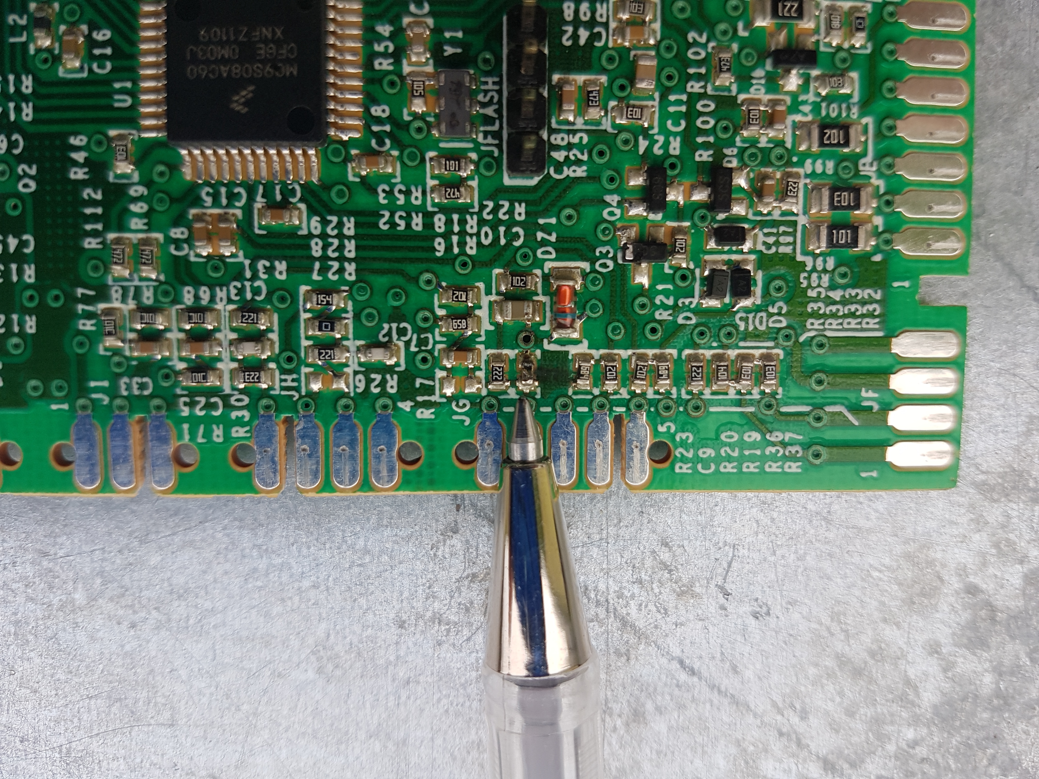

  • #15 17560914
    leszekkazik1980
    I warmly welcome.
    I also have a problem with running the ESL65070R. After reading the forum, I removed the programmer board and checked the elements. For me, the resistor R70 and the U3 or LNK system are not damaged. On the other hand, one of the tiny resistors burned in the picture was marked with the tip of a pen. In the second picture, view all my tile. Could someone tell me what should be worth? In the same way as the Q3 element, it seems to me that it has been damaged. I can not read the value that it should have.
    Please help.
    Electrolux ESL65070R Dishwasher Not Turning On: Switch or Module Issue? Electrolux ESL65070R Dishwasher Not Turning On: Switch or Module Issue?

    leszekkazik1980 wrote:
    I warmly welcome. I also have a problem with running the ESL65070R.
    So what exactly is your problem?
    He did not burn himself, something helped him, first you need to find out the cause and then heal the effect.
  • #17 17563105
    leszekkazik1980
    I will ask the question again. What value should be the resistor marked in the picture with a pen. If someone has such a plate, please read the value from the resistor and the value from element Q3.

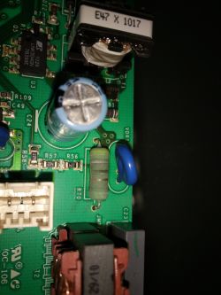

    As you can see in my photo below is the capacitor SMD (you can give something on feel) according to your measurements on other similar (size and color) or wait when there is someone who has such a PCB :D
    Image of a PCB with SMD components.
    Since Q3 = Q6 it's easy to get it or it's a diode (BAT54 BAT54A BAT54C BAT54S) single or double. However, it can also be a transistor, eg BCXXX SMD + 5CS + Sot-23
  • #19 17987528
    remiq19
    Hello. I exchanged these 2 elements. U3 and R70. I polished the plate. The dishwasher came to life, but she switched off during work. I did a reset and then a test program. It ended, it was ok. The fast program also did it all. Success. She did not turn on the next day. The resistor R70 is ok. I do not know how to check U3. Do you have any idea?
