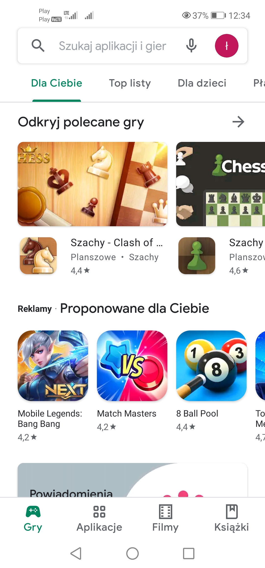

  • #50 19532996
    kkla134
    Posts: 312
    Rate: 56
    Hello again, everything works and it's ok.
    The Play Store installs everything without a hitch :) .
    • Huawei P40 Lite: Step-by-Step Guide for Installing Google Services & Overcoming Limitations Screenshot_20210723_123438_com.android.vending.jpg (676.3 KB) You must be logged in to download this attachment.
