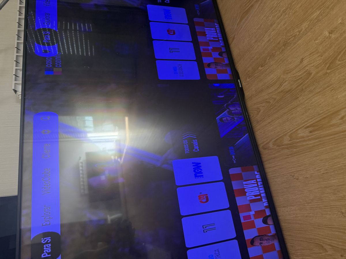

    please flash file for stik Mark:PHILIPS
    Model:49PUS6031/12
    Chassis (main board, components):17MB120
  • #11 21584643

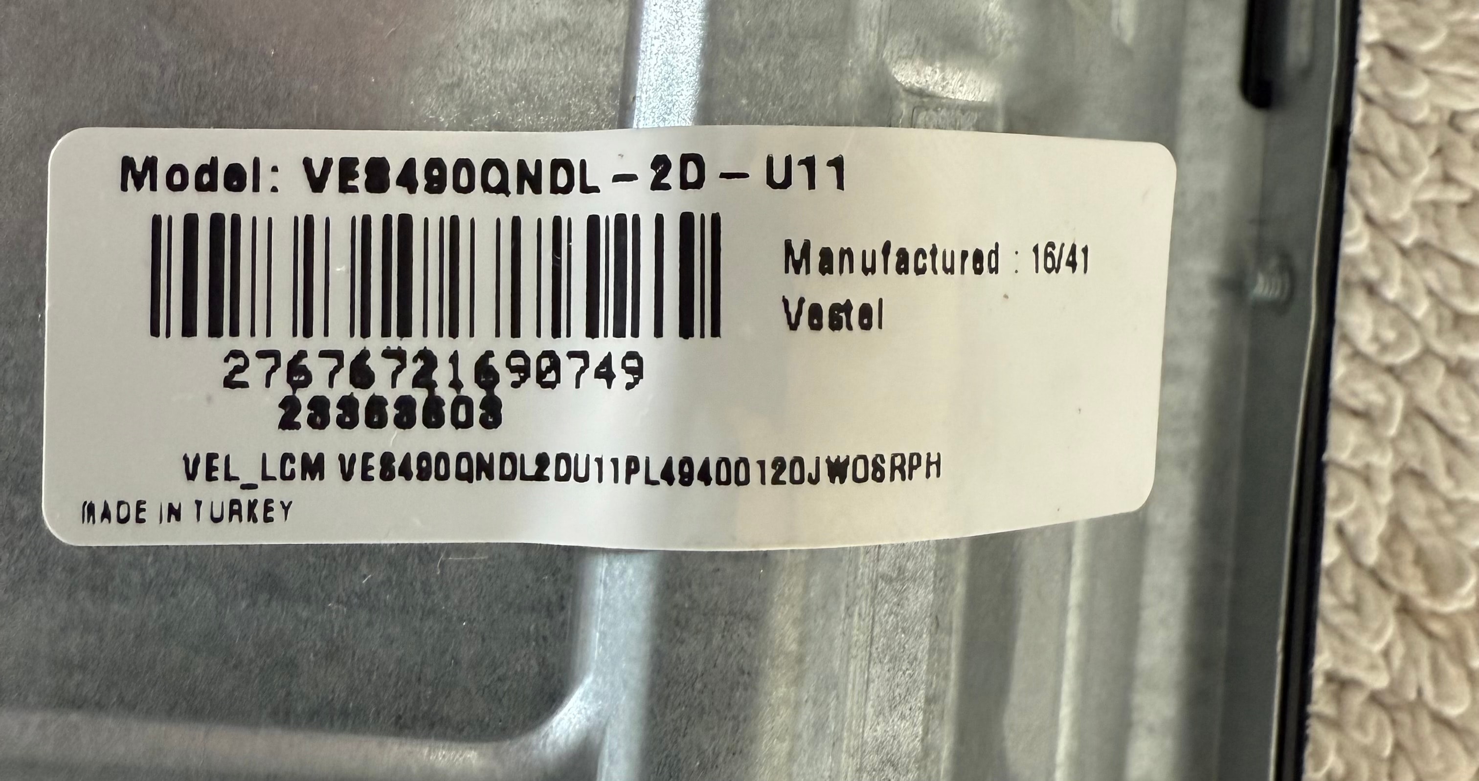

    yokoono51
    Level 28  
    Posts: 760
    Help: 159
    Rate: 293

  • #12 21584702
    nobre22
    Level 4  
    Posts: 6
    yes VES490QNDL-2D-U11

  • #14 21584891
    nobre22
    Level 4  
    Posts: 6
    Thank you, The screen is split in two and the remote control doesn't work.
    Philips 43PUS6031/1led flashes, and only the philips brand appears and turns off
  • #15 21584939
    billobirillo
    Posts: 1110
    Help: 333
    Rate: 768
    the remote control doesn't work because the software is for a Telefunken, and not for the Philips
    now you need a universal vestel remote control to use the tv
    otherwise (without a working remote control) you can't install any other software
    find a remote control, so you can install the original sw for Philips
    I will post it tomorrow, now I have to go
  • #17 21585190
    yokoono51
    Level 28  
    Posts: 760
    Help: 159
    Rate: 293
    nobre22 wrote:
    Thank you, the screen is split in two and the remote control does not work.
    Philips 43PUS6031/1led flashes, and only the philips brand appears and turns off .
    What was wrong with the TV?
    Are you sure the panel is VES490QNDL-2D-U11?
  • #18 21585302
    billobirillo
    Posts: 1110
    Help: 333
    Rate: 768
    PHILIPS 49PUS6031/12
    main 17MB120
    panel VES490QNDL-2D-U11
    with this software, the Philips remote control should work again
    if after the usb recovery, the screen is still splitted, don't worry: it can be fixed with the usb panel files
    • 17MB120_PHILIPS_FULL_SW_V2.40.2.0_SVN_230302.zip (155.91 MB) You must be logged in to download this attachment.
  • #19 21585966
    nobre22
    Level 4  
    Posts: 6
    Thanks, I'll test it tomorrow.
    • Philips 43PUS6031/1led flashes, and only the philips brand appears and turns off IMG_2272.jpeg (1 MB) You must be logged in to download this attachment.
  • #20 21586910
    nobre22
    Level 4  
    Posts: 6
    everything ok thanks
