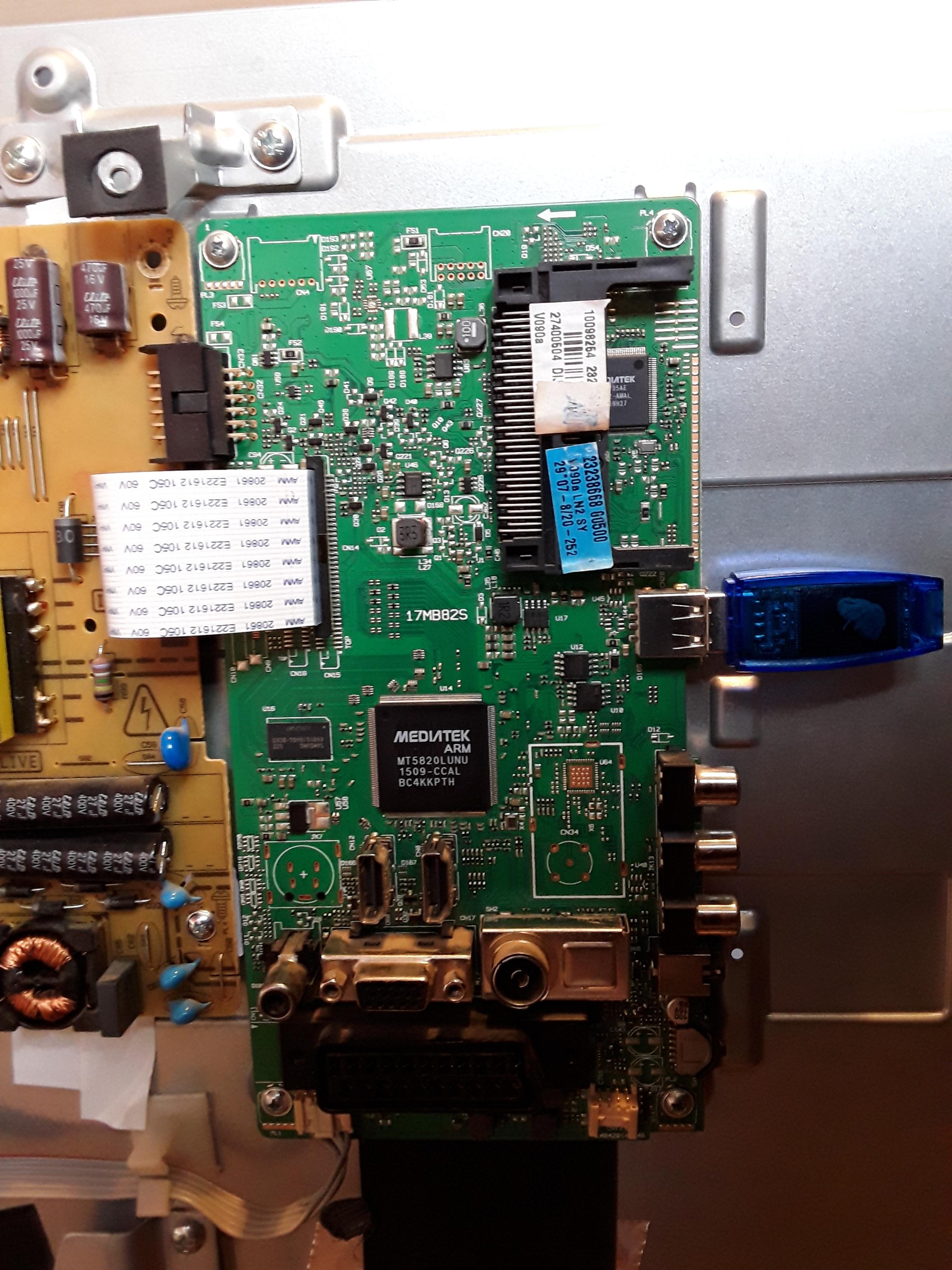

    Model: 32PFL3018H/12 (VES2.2E LA)
    Chassis (main board, components): mainboard 17MB82S and 17IPS62 for PSU
    LCD Screen/Panel (if exist): VES315WNDB-01
    More information:
    The TV is blinking at startup and could not start (no display on the panel, only backlight). Maybe a board firmware failure. The USB firmware update is working, tried the Core firmware update 0.8.4 but no changes after the upgrade.
    Voltage of the PSU is correct.
    U12 : 25Q64FVSIG
    U10 : 25L160GE
    Any help is appreciated.

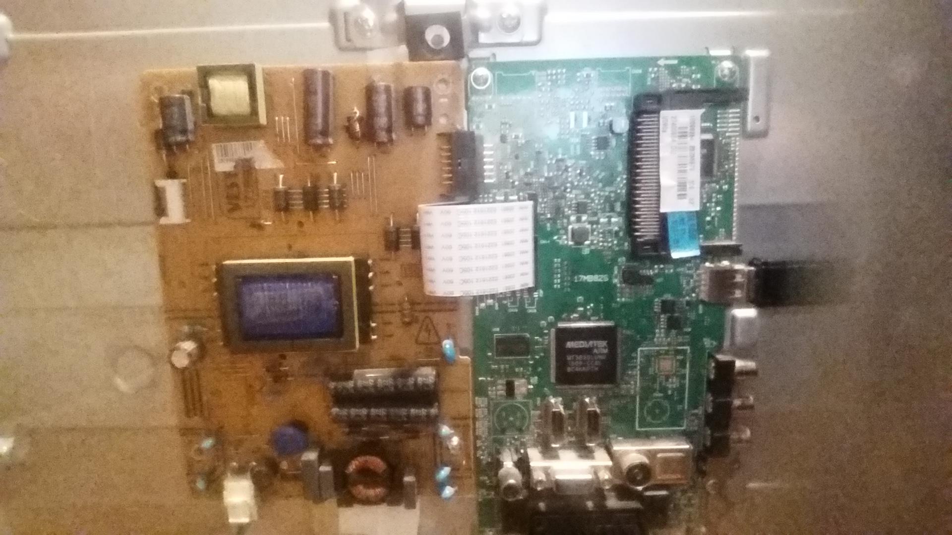

    Hi, it seems to me that the electrolytes in the power supply are swelling, (according to the attached photo) check the power supply.

    artbi881 wrote:
    it seems to me that the electrolytes in the power supply are swelling (according to the attached photo)
    Too poor photo to tell. If that were the case, the author of the topic would be doing something about it.

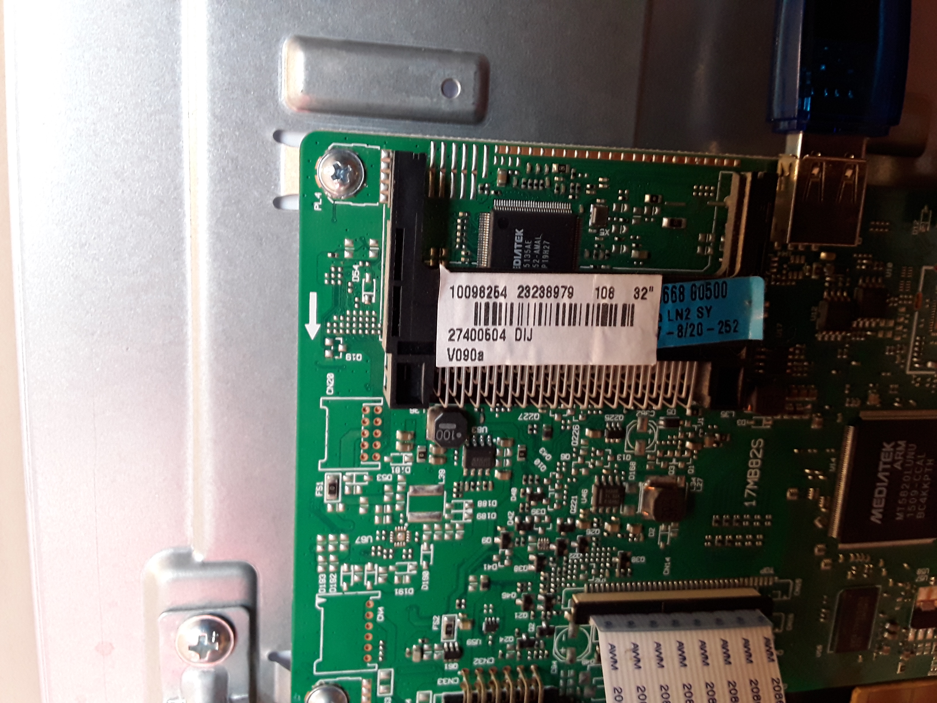

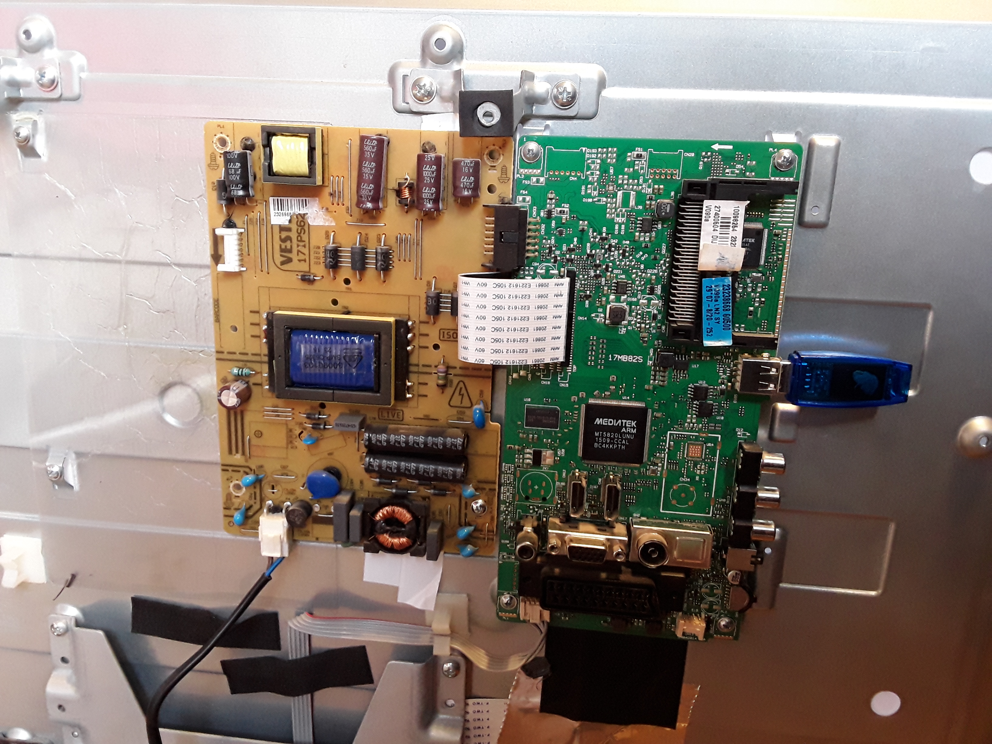

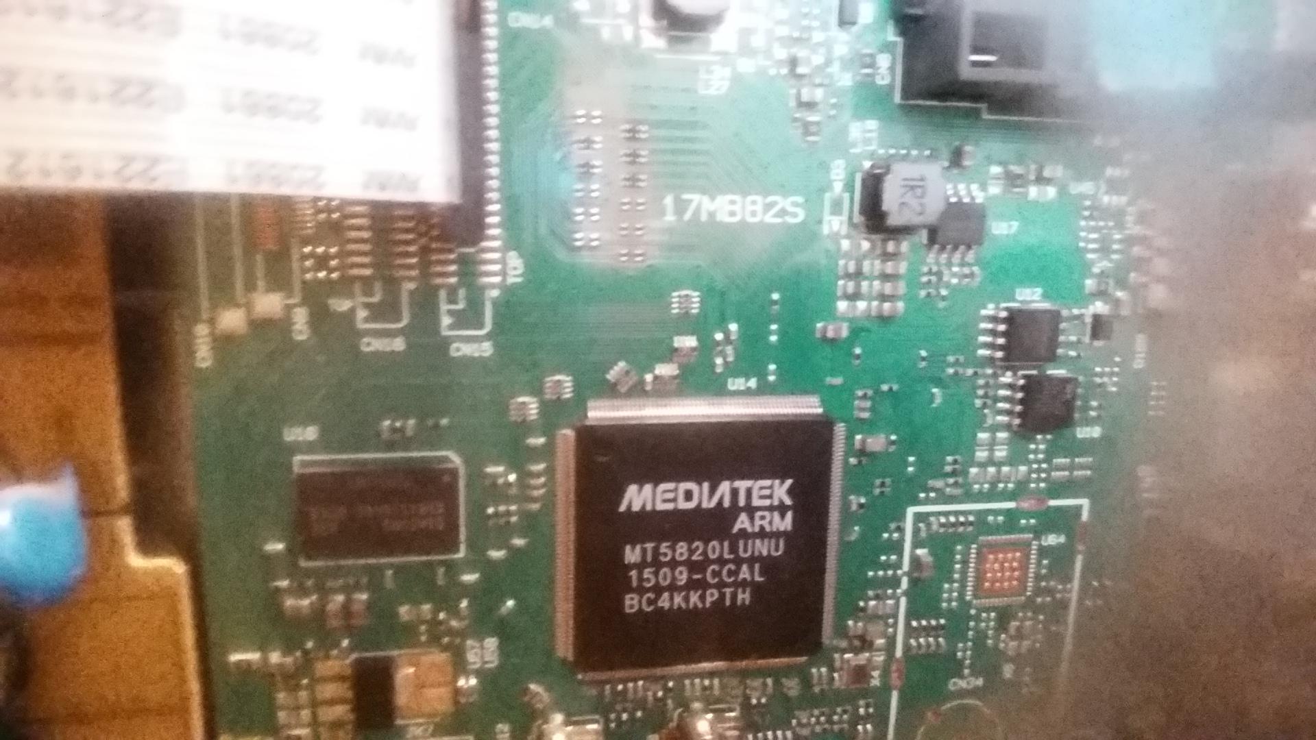

    @artbi881 Hi thanks for your approach, but tested all the condensators and all are OK
    @jeloi Thanks, tried this and no changes after the upgrade. Also tested the nvclean upgrade and also no changes.
    @TELERADIOMECHANIKA OK I have uploaded new hi-res pictures, see in attachments.
    Also tried to boot the card without the LVDS connected to the LCD panel (if the panel verification is buggy) but no changes.
    Any way for installing the panel driver via USB without the service menu?
    At this time, I don't know what to do now to solve the issue.

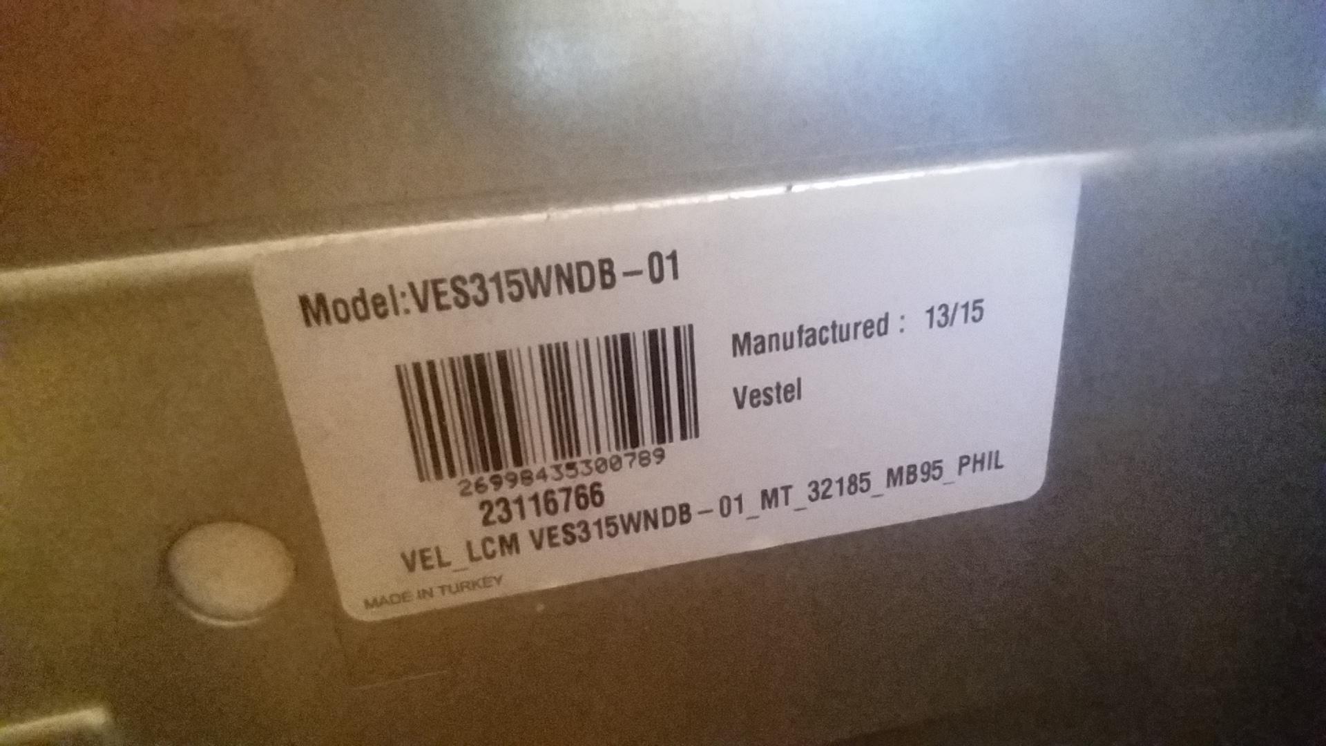

    fhocorp
    Posts: 12
    @sricamap001 Here is the picture of the sticker
    • PHILIPS D32H278A3 / 17MB82S Startup Blinking: Firmware Failure? Model 32PFL3018H/12, PSU 17IPS62 20220130_132035.jpg (2.42 MB) You must be logged in to download this attachment.
    FHOCORP.NET
    Rue du Reservoir, Talant, 21240 | Company Website: www.fhocorp.net
  • #8 19852709
    fhocorp
    Posts: 12
    sricamap001 wrote:
    Hi, what is the number starting 1008... or 1009... or 1010...? in the back panel sticker
    if 1009 you can try one of these:
    https://drive.google.com/drive/folders/1xKqV78vD8VqNQrBQ4n7NqIaikjafj8xP
    Press remote OK and plug to mains
    Tried one of these and the update installation finished, the situation is the same as before (led blinking slowly) :(
